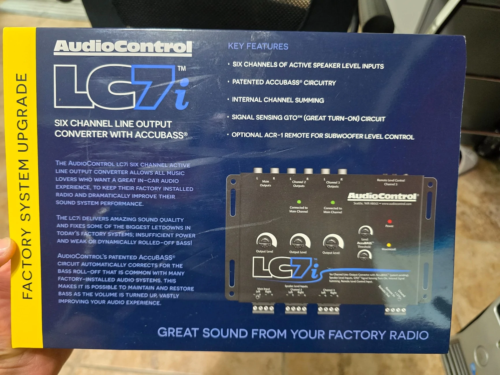

I have a 23 Bronco with the B&O system. What I did was to add an audio control LC7i, which will handle up to 400 watts going in and reduce to low frequency ( RCA ) outputs
