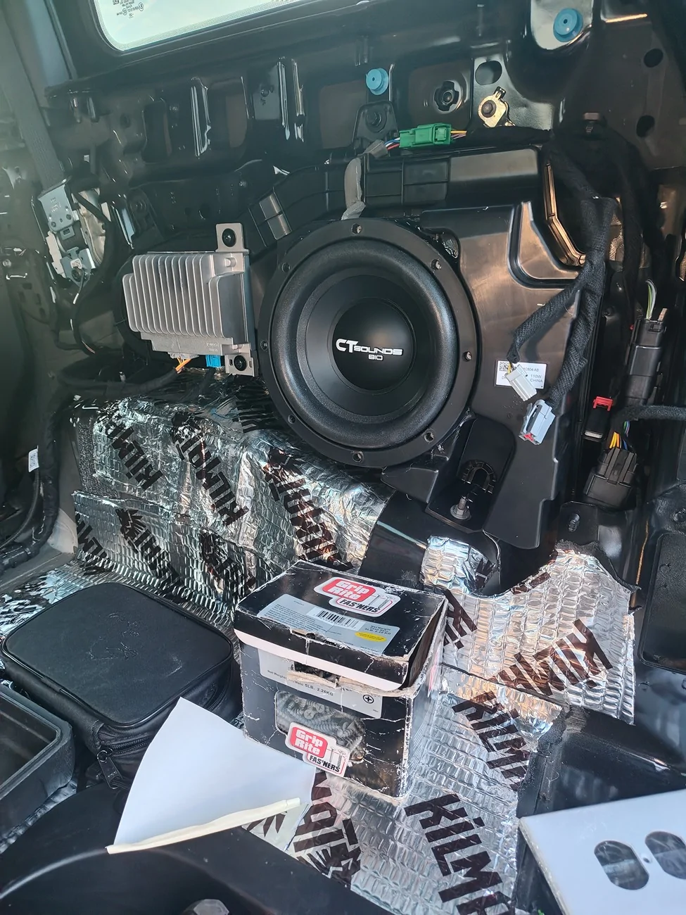

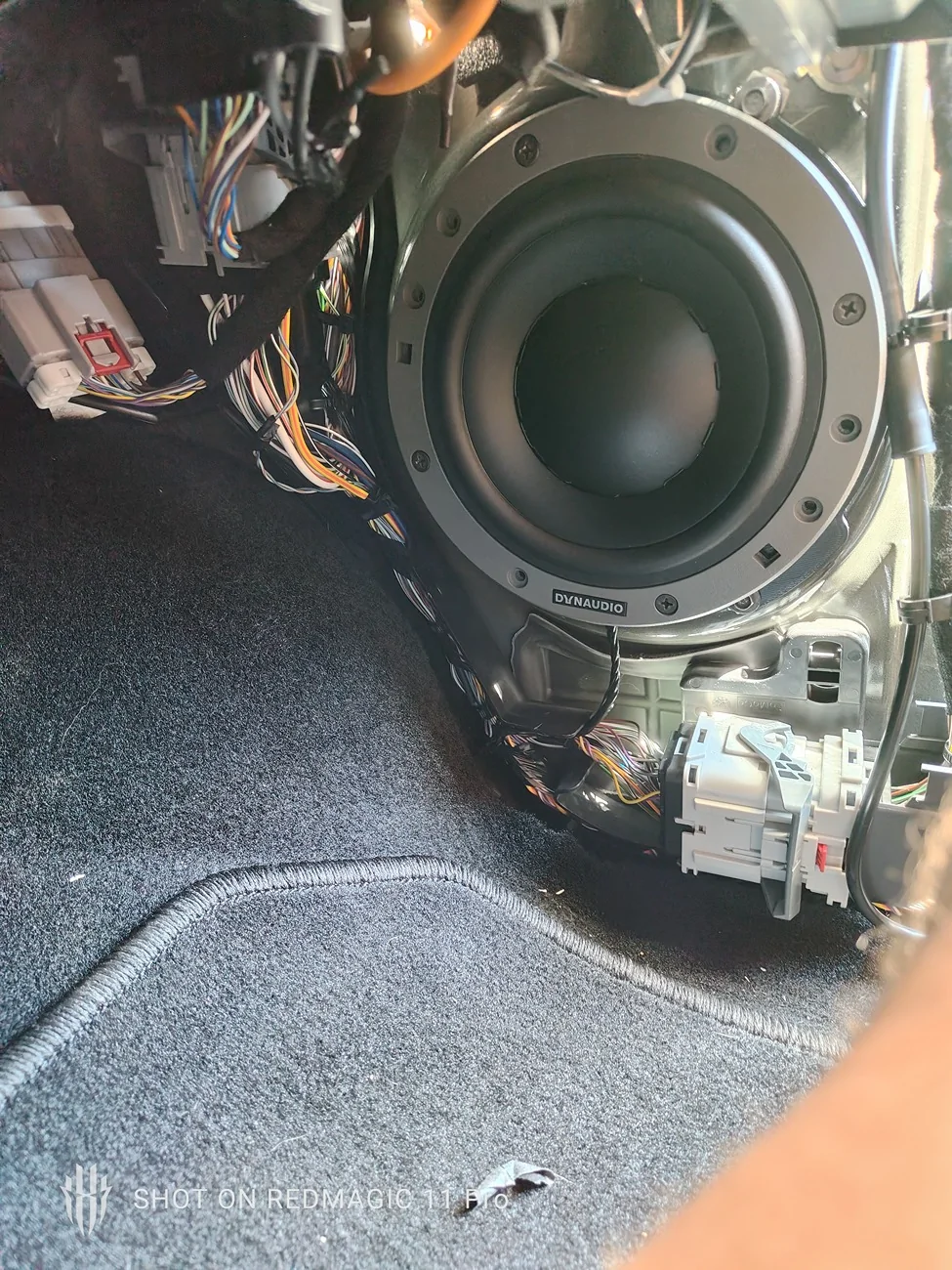

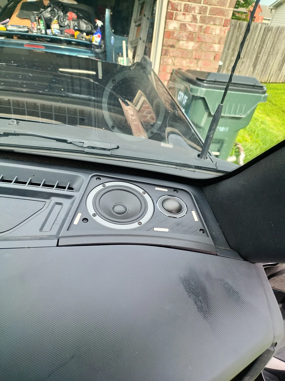

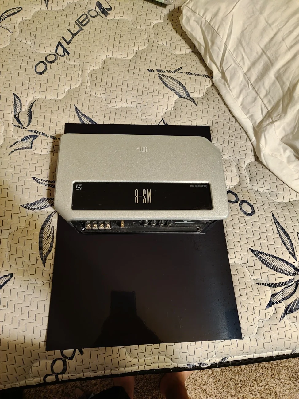

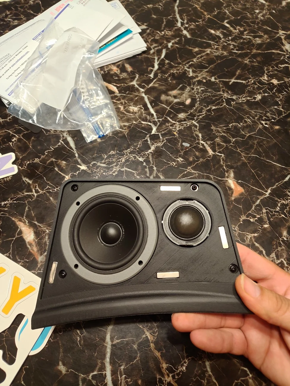

I'm not sure I'd call my in-progress build super high end but I'll still list what I've done so far and my future plans. 3-way Dynaudio components up front in the factory location using custom dash mounts made by a user here (onefaststang). 6.5 inch pods in the rear with hi-res Sony coaxials. I also upgraded to an 8 inch low power sub in the factory enclosure running off the factory amp for now until I can find a good place for my amplifiers that won't fit under the seat. I have an eight channel DSP waiting to go in so I can run the front stage active. Sound deadening in the rear cargo area that is only about 50% done. I too have the rattles that everyone else has but I also have a rattle that can be hurt on the outside of the vehicle from the passenger rear quarter panel.
