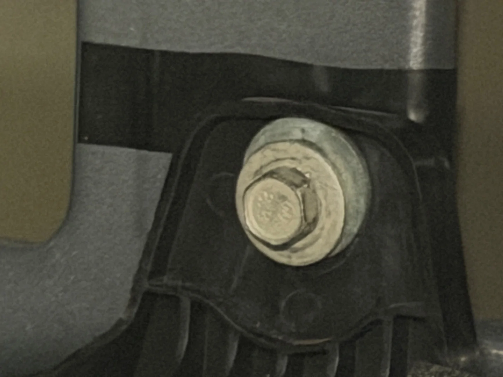

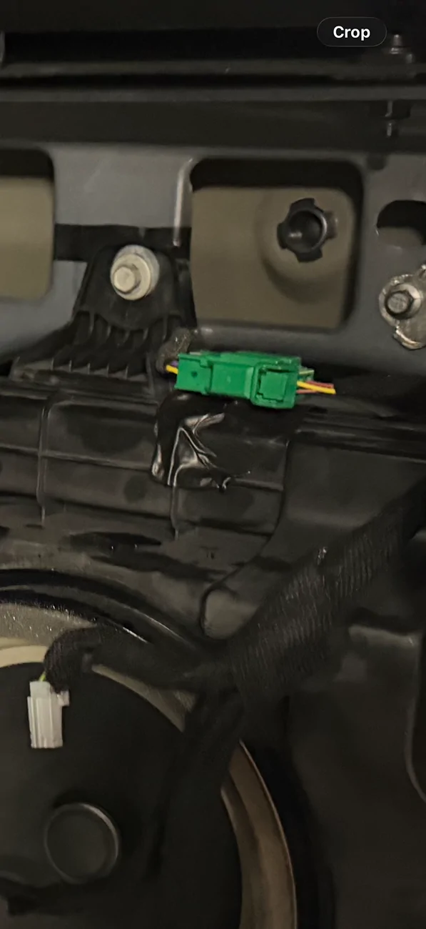

The bolt on top goes into a clip that rattles too. I put some rubber tape right above the clip and used a larger washer on the bolt. It seems much better.

That is a thicker rubber tape than electrical tape. I also put some of the thicker rubber tape between the green connector and the Sub housing. Seems another point of possible rattle.
