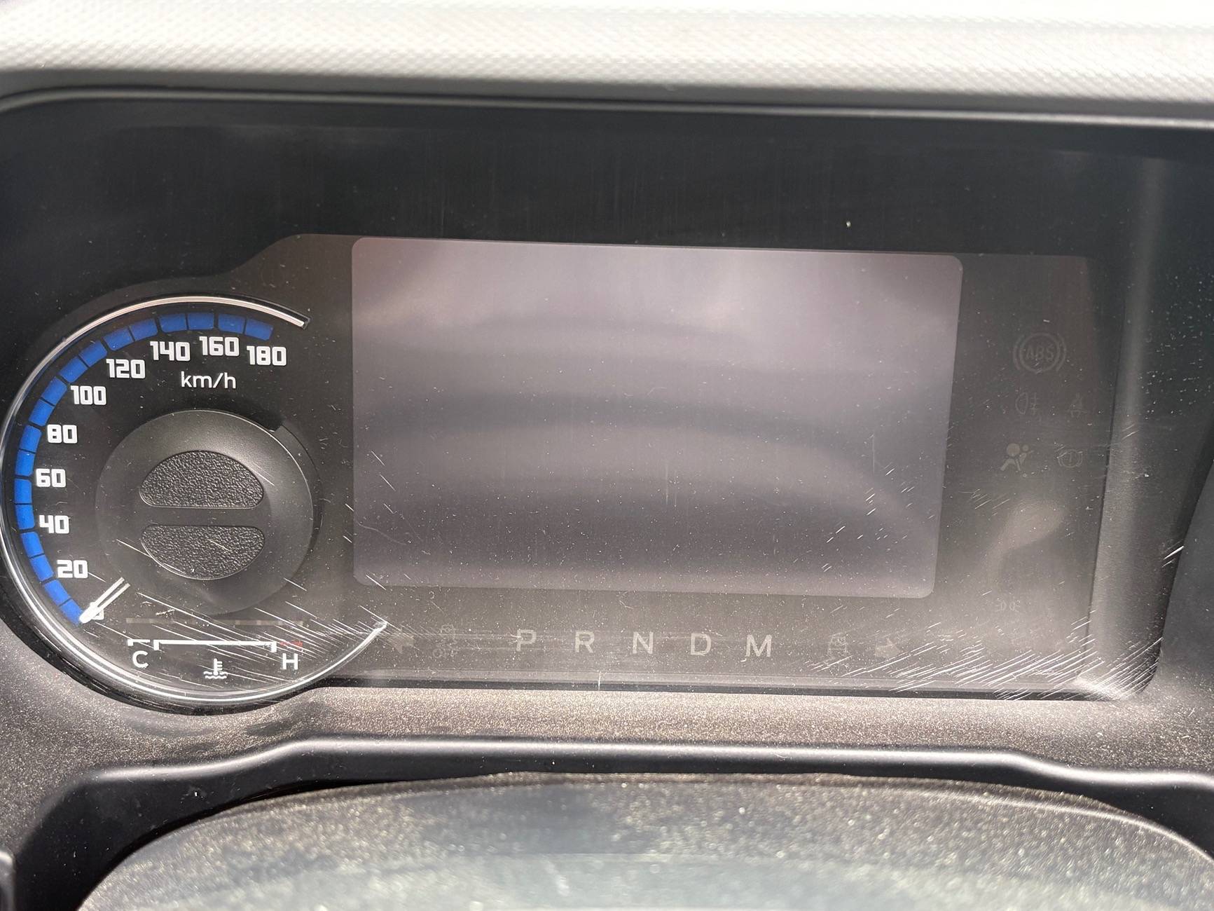

Had to catch mine in the right light but it looks like mine completely spidered.

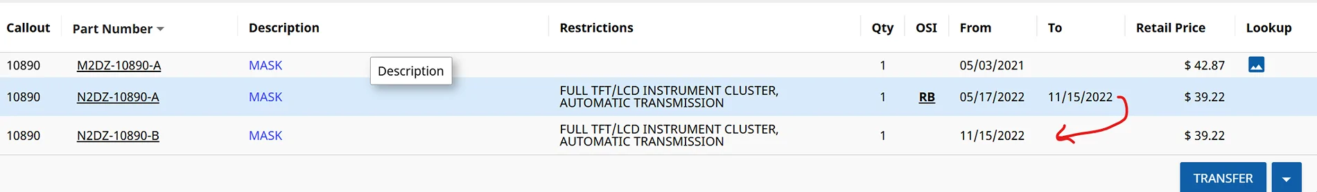

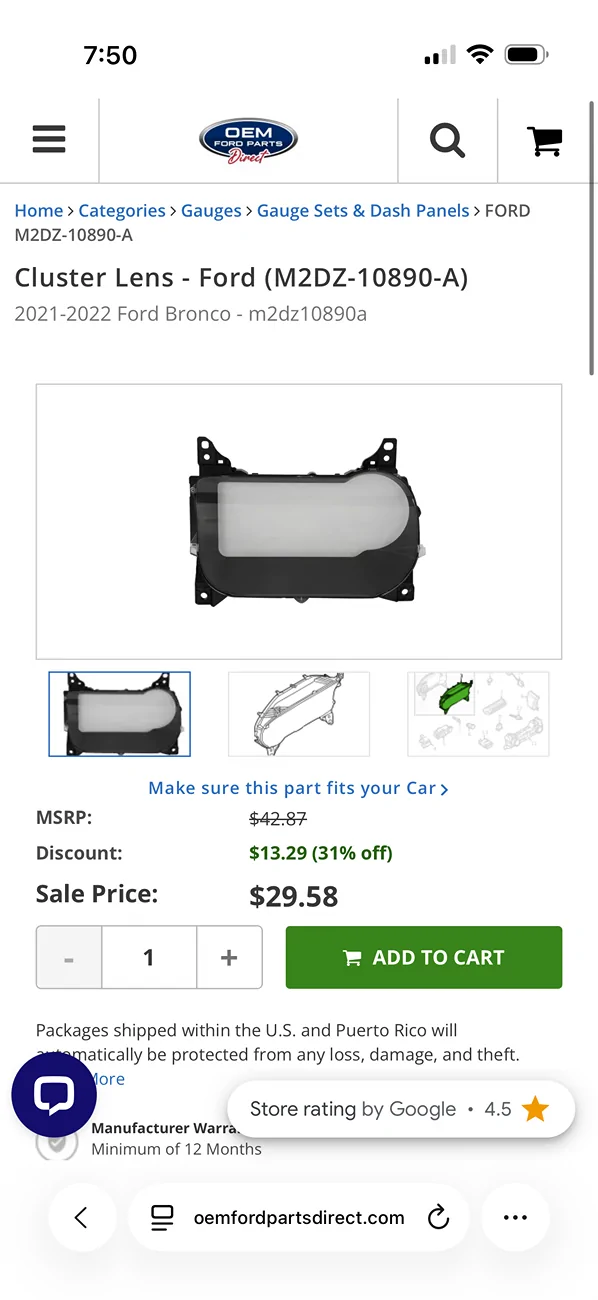

M2DZ-10890-A FFS, it's a $40.00 part. Unless it has impact marks from the outside, which it probably won't, it's likely an adhesive or plastic weld induced stress crack. Pick your poison, temp related or just general stress. Stress crack, when void of evidence of mechanical impact or chemical induced failure, can be covered (glass is a different beast but still has limited coverage if a structural failure below it is the cause and within coverage limits).
Was this the part?? Thank you!

There are two possibilities depending on your build date. The N2DZ -A supersedes to the -B
The N2DZ is for the Bronco Raptor cluster or all clusters 25MY+
