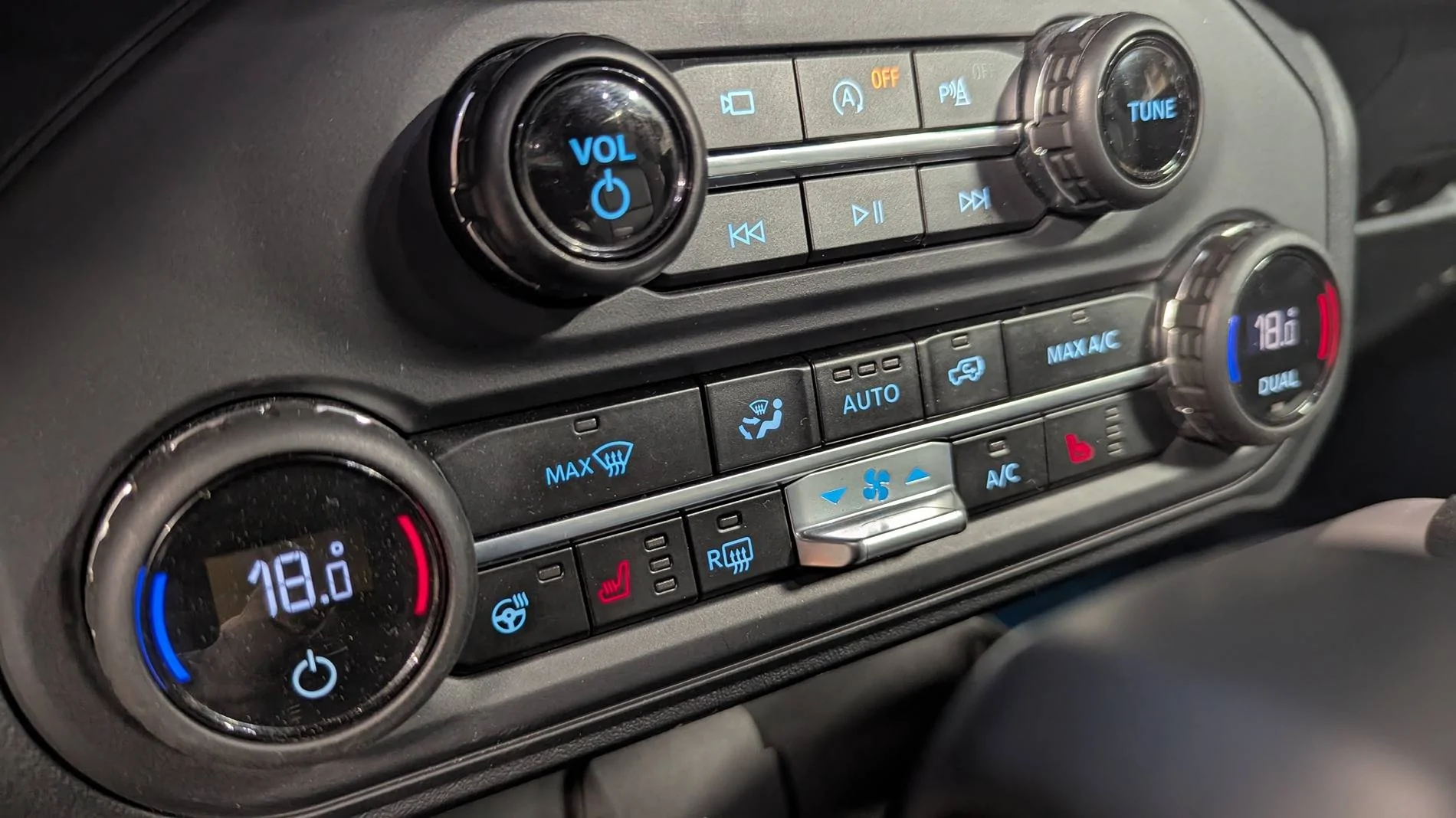

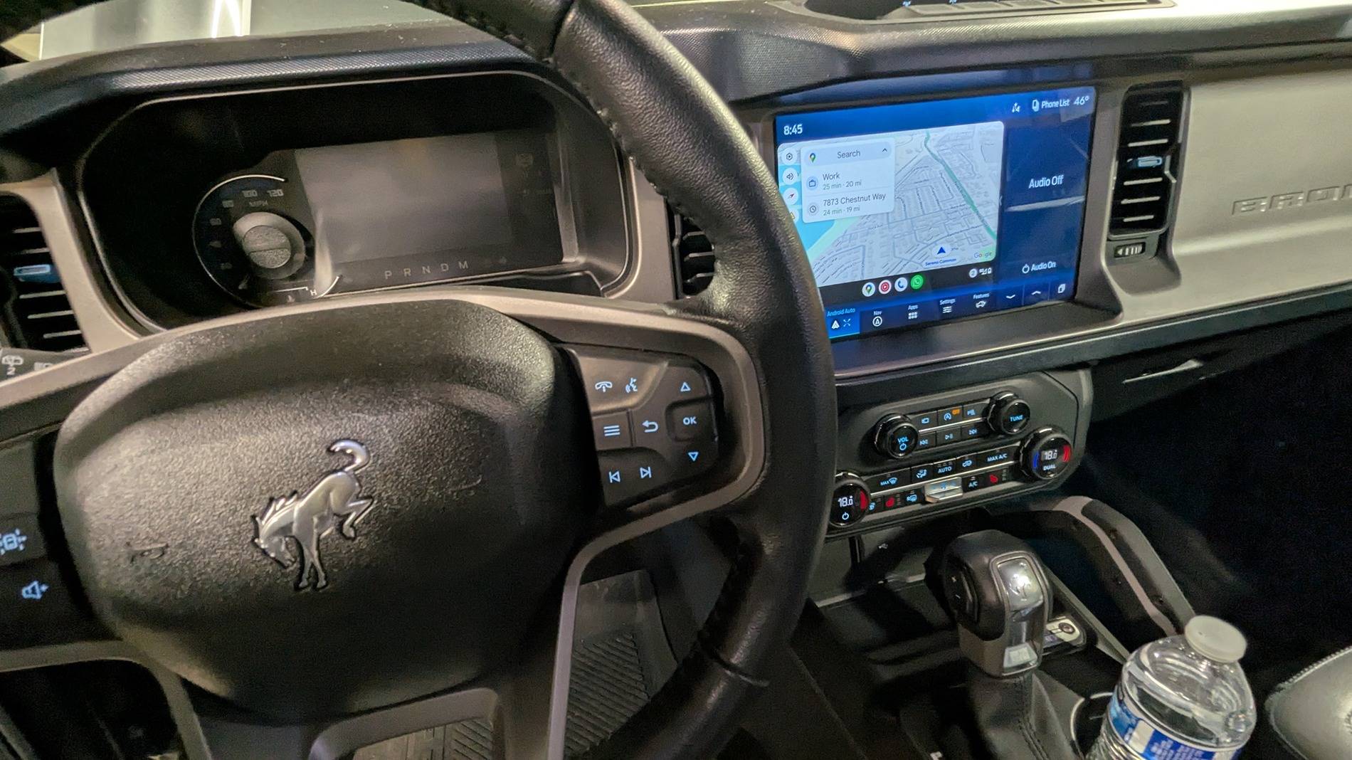

This issue happened on my Bronco today. The gauge cluster went completely dead. The temp control readouts turned to C°. The most weird thing was that the parking brake stopped working. The Bronco seemed to be running and driving just fine though.
I disconnected the negative battery cable for 5 minutes, and the issue went away.
I've owned my Bronco for over 2 years now, and it was the first time I had this problem.
