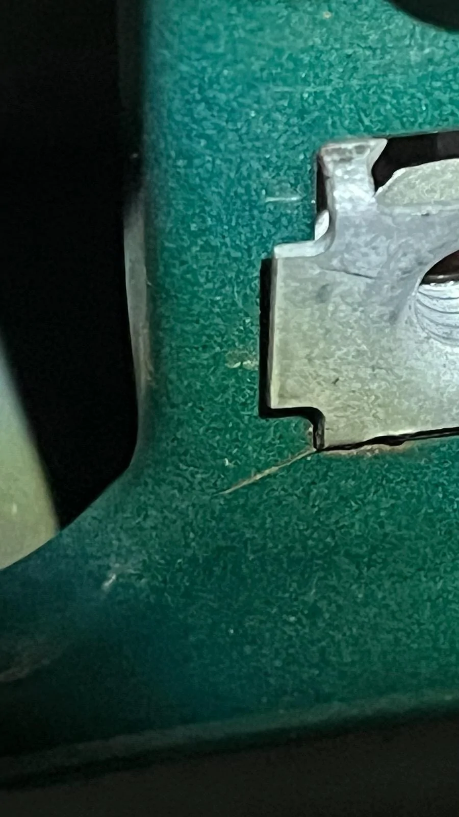

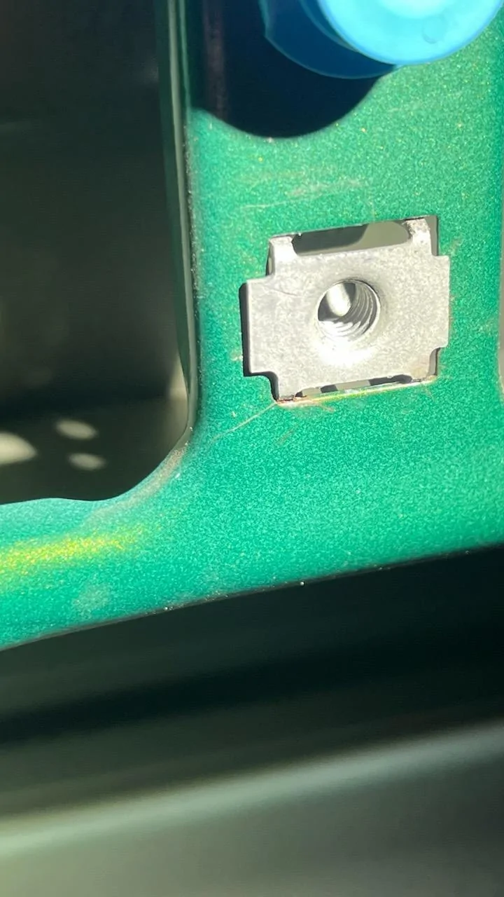

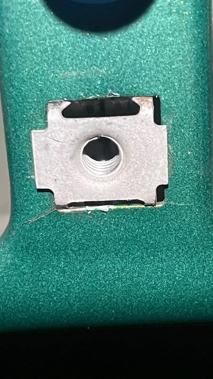

Woofer main bolt. Cracked both sides. All plastic plugs snapped and woofer basically hanging off. Split right through the metal.

Gotta say I can’t imagine a bass level high enough to crack that steel mount point (I think that panel is steel and not aluminum but I can’t recall offhand). The speed nut looks fine too. Has to just be a bad panel?
Seems like they could just pop the speed nut out, touch up the panel with a patch weld and drop a rivet nut or something back in. Yeah it’s painted but it’s underneath trim and behind the sub, so just some rattle can to keep it from oxidizing.
That said under warranty they would probably want to replace the entire panel.
