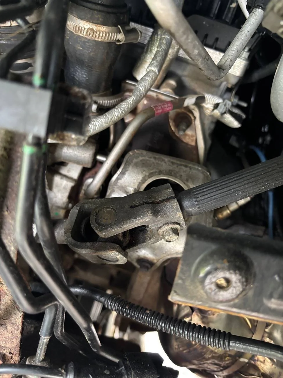

Next in the saga.. watched a video and apparently after disconnecting the steering bolt. It slides out easily. Nope stuck for me 😭

Which steering bolt? The one I’m looking at is still in. The bolt has to come all the way out because there’s a groove around that shaft so it can’t come off if the bolt gets loose . and you can drive a screwdriver or small chisel in the slot to spread it open if you need to.

Yeah that 10mm bolt is out now. That was my before pic so I can compare when reconnecting it. I’ll try a bigger screwdriver. Mine might be too small 😬

I would go ahead and soak anything else you plan to remove with some penetrating oil.

Yep, you need to spread the yolk open & then it should slide out. Make sure you mark it before taking it apart 🤠
