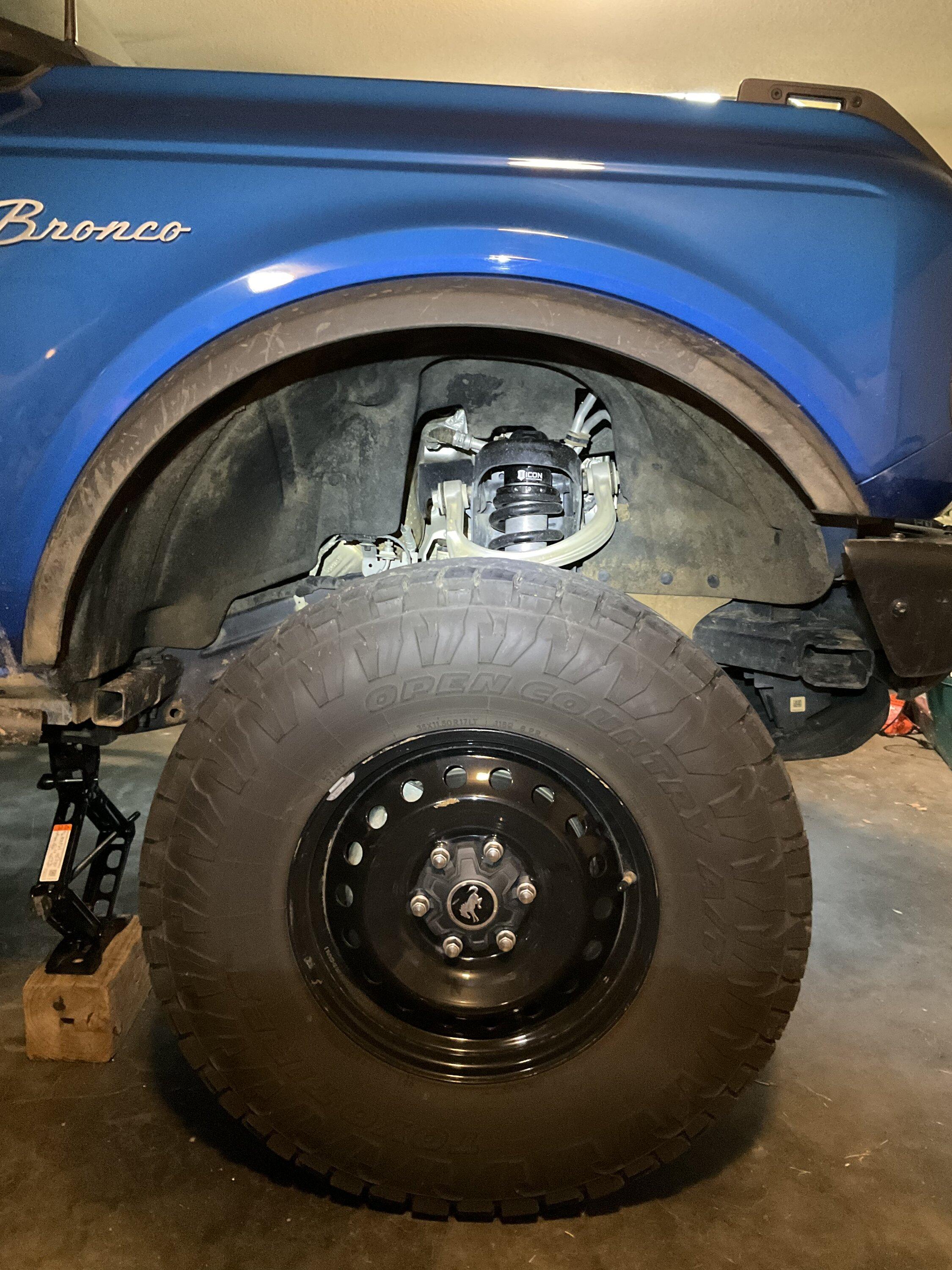

Thanks man!!!! :). Very helpful. I just installed my 1.5 inch spacers.....loooks good. Gettting the suspension stuff done Monday or Tuesday and will update with a post here. BTW - I would recommend getting the BroncBuster Tie Rod Brace.....I have it. Black Friday sale is BIG and 25% OFF! - https://cdn.shopify.com/b/shopify-inbox/luidb9qlxme0kka8yqvkbzk2s622.jpg?syclid=cdr6h6r7k0448pqlfjag

Finally got it all installed :) and you were right - no need for an aftermarket UCA! :) But of course - I will still get one in the near future....hahahaha!!! I have to say - it rides GREEEEAT!!! Better than I thought it would. Wow. Firmer, smoother over small bumps and road undulations, plus less body roll. I love the setup and am SO happy I did it. Thanks again for the clutch advice and here is a link to my upgrades and reviews:

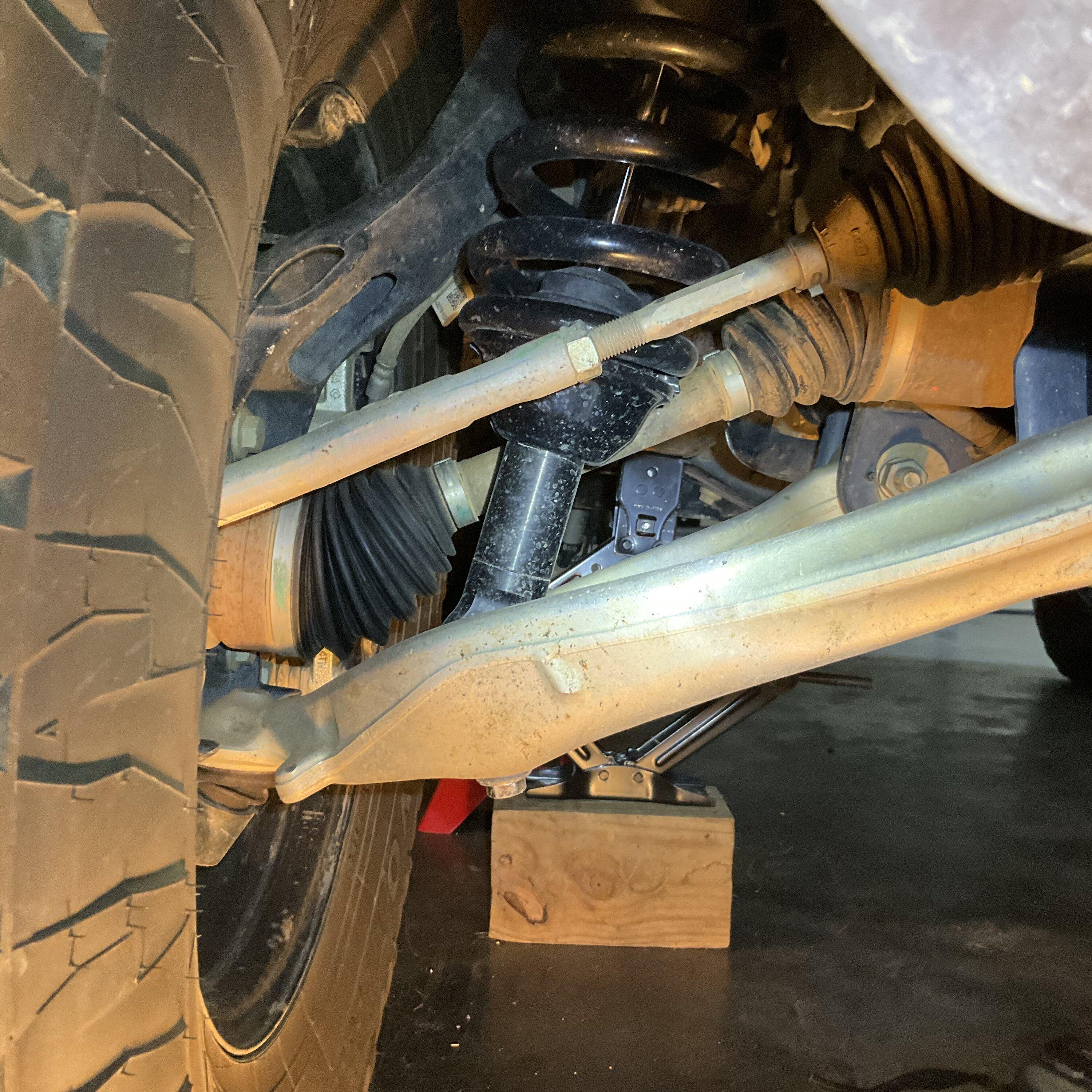

How is the angle of the UCA ball joint? I lifted mine 1.5" and at full droop it sits at quite an angle.
kodiakisland
Jul 10, 2020
6,164
17,768
Arkansas

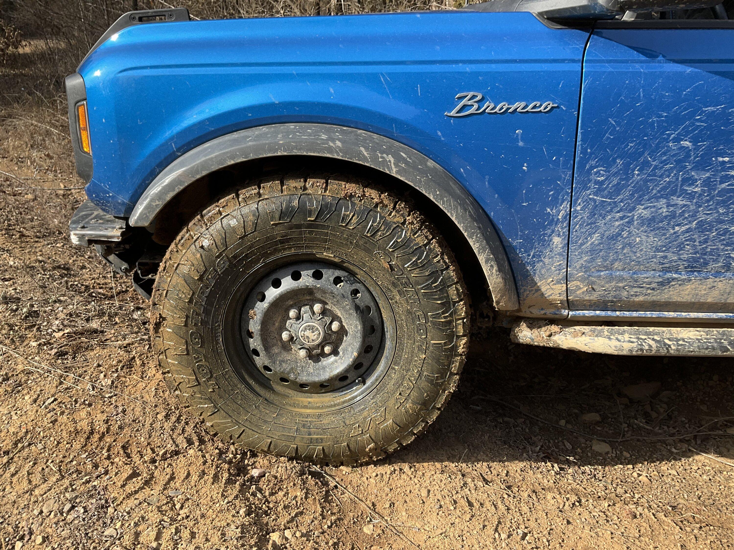

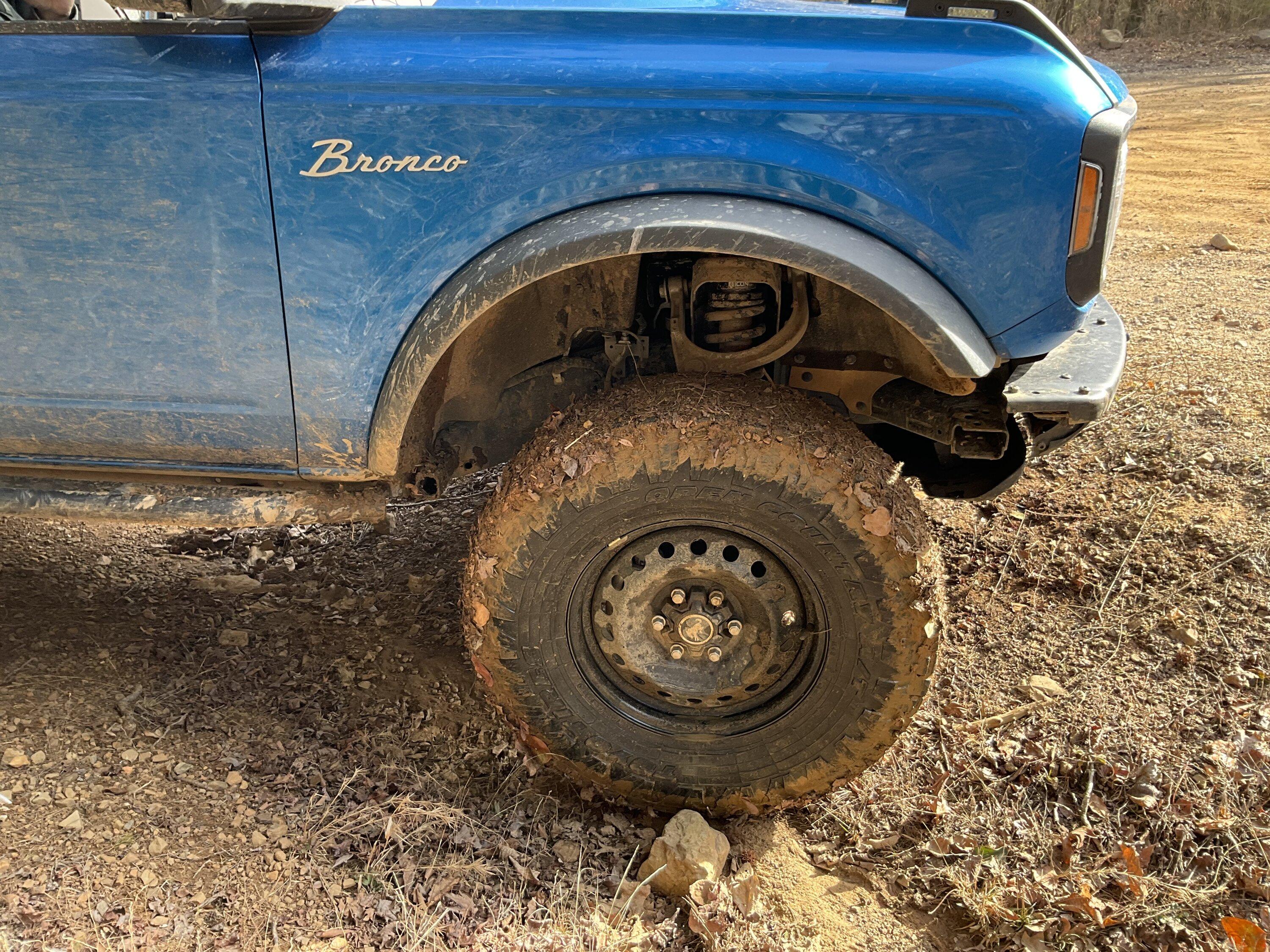

It’s going to be quite the angle at full droop regardless of which UCA you use. That’s kinda the point. More range of motion. The point I was making is at full droop for me, 29.75 inches center axle to metal fender, I’m not limited by the stock UCA.
This was earlier today. Almost full stuff on one side and almost full droop on the other. The stock UCA isn’t at its limit. I’m happy.
Ford Bronco BEST Tubular Upper control Arm? E1480923-ABFE-4E37-B6C4-77051A9DEC2E
Ford Bronco BEST Tubular Upper control Arm? BB349069-AC99-458C-990A-F534F67232A7
Also, when I’m at full droop, it’s low speed. Not bombing through the desert. I’d probably upgrade sooner if it was subjected to high speed abuse.

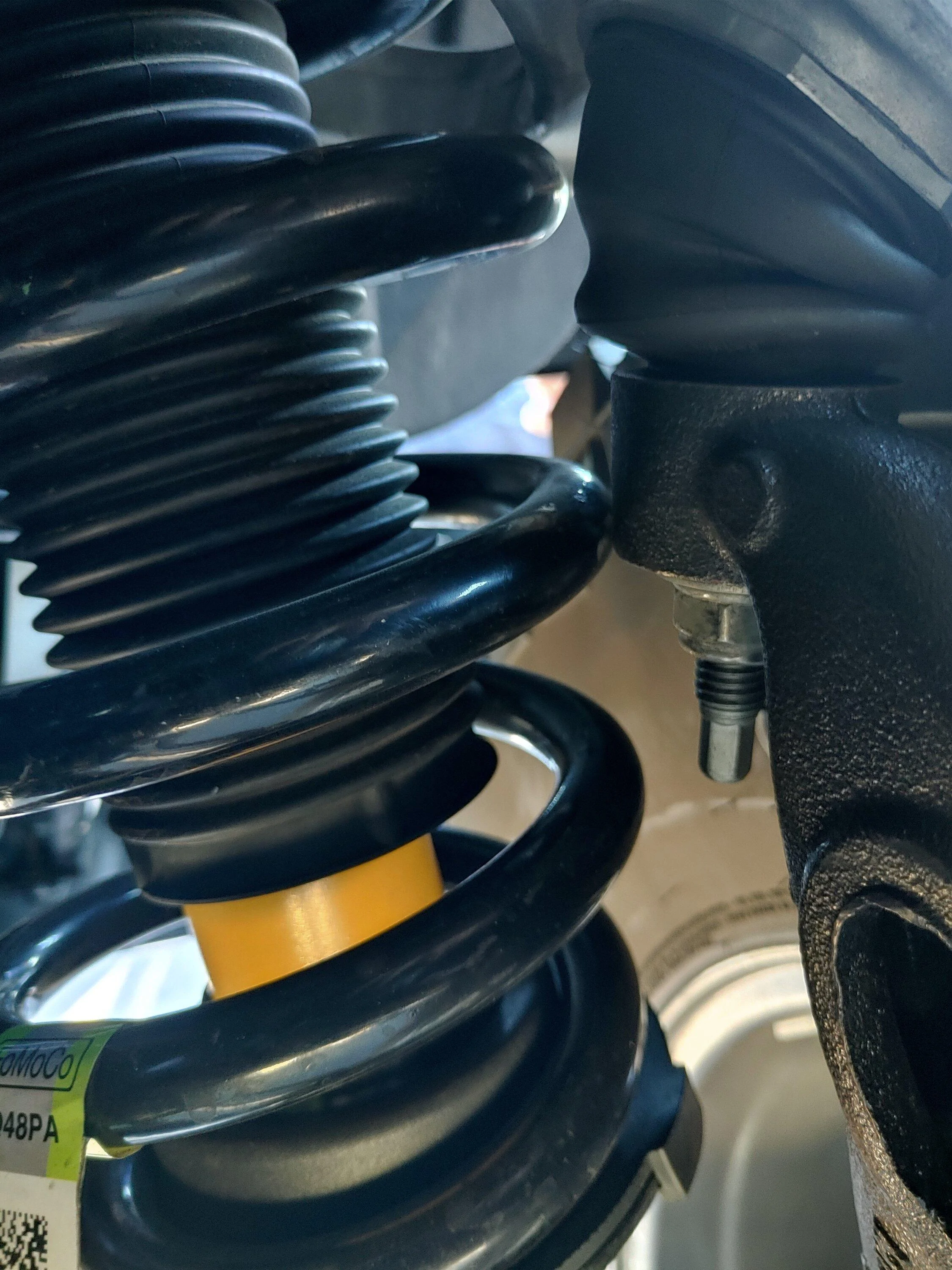

Thanks for the input. Here's my UCA while flexed. Im not jumping it by any means, but I dont want to stress that ball joint either. How does mine compare with yours?
My knuckles and control arms will make some contact with the coils, so Ive been researching UCA's, but will they fit with an oem Badlands wheel and 315's?
The aftermarket uca's are for the most part the same dimensions as oem, its the mounting angle of ball joint and ball joint used that makes the difference. Strength comes from design and material only. But the aftermarket uca's are direct bolt in. Take a close look at the oem vs aftermarket, you will see the difference at the ball joint and the angle it is mounted.
That's a clearance issue, not a range of motion issue, but is a good reason to replace. The factory springs are actually wider than many of the aftermarket springs, so I guess this will happen more with lifts that use the factory springs.
As long as the ball joint is not reaching it's full movement and stopping travel, it's not causing undue wear on the ball joint itself. The ball joint has as much or more range than many of the replacement UCAs. The new UCA will have the joint at a different angle to start with, but over all have the same or less range of motion. It just resets where it is at rest so it should give more down travel over stock. I would not be concerned with a UCA that uses the factory ball joint as it's good.
An issue you may face is if your wheels have the correct backspace for the new UCAs. To gain clearance, they usually protrude more and have issues with some factory wheels. Unless you want to buy new wheels, make sure whatever you get works with your particular wheel.
