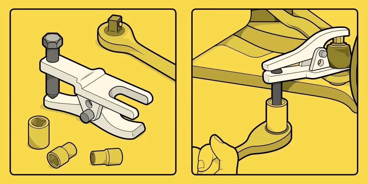

WOW!!! That’s NOT good!!! If I had that issue I’d be be considering pulling the knuckle off and using a balljoint tool to put some pressure on it while beating on the knuckle with a 5-lb hammer. The balljoint tool looks like this:
Ford Bronco Stuck upper control arm bolt IMG_9447
If you can put the tool on and still have room to swing thd hammer you may not need to pull the knuckle. Be careful that you don’t swing the knuckle out too far as you can pull the cv-joints apart unintentionally, then you’ll have more work ahead of you.

I don't think that tool is going to be of much help as the head of the ball joint went bluetooth :unsure:
you need a "c" clamp style with the cup

Ordered the C-Clamp with the cup. I tried stacking an impact socket over the the top with a nut on the bolt on the bottom with a regular clamp, got sketchy pretty quick.
This tool worked! I had to use my foot against a wrench to really turn it.
