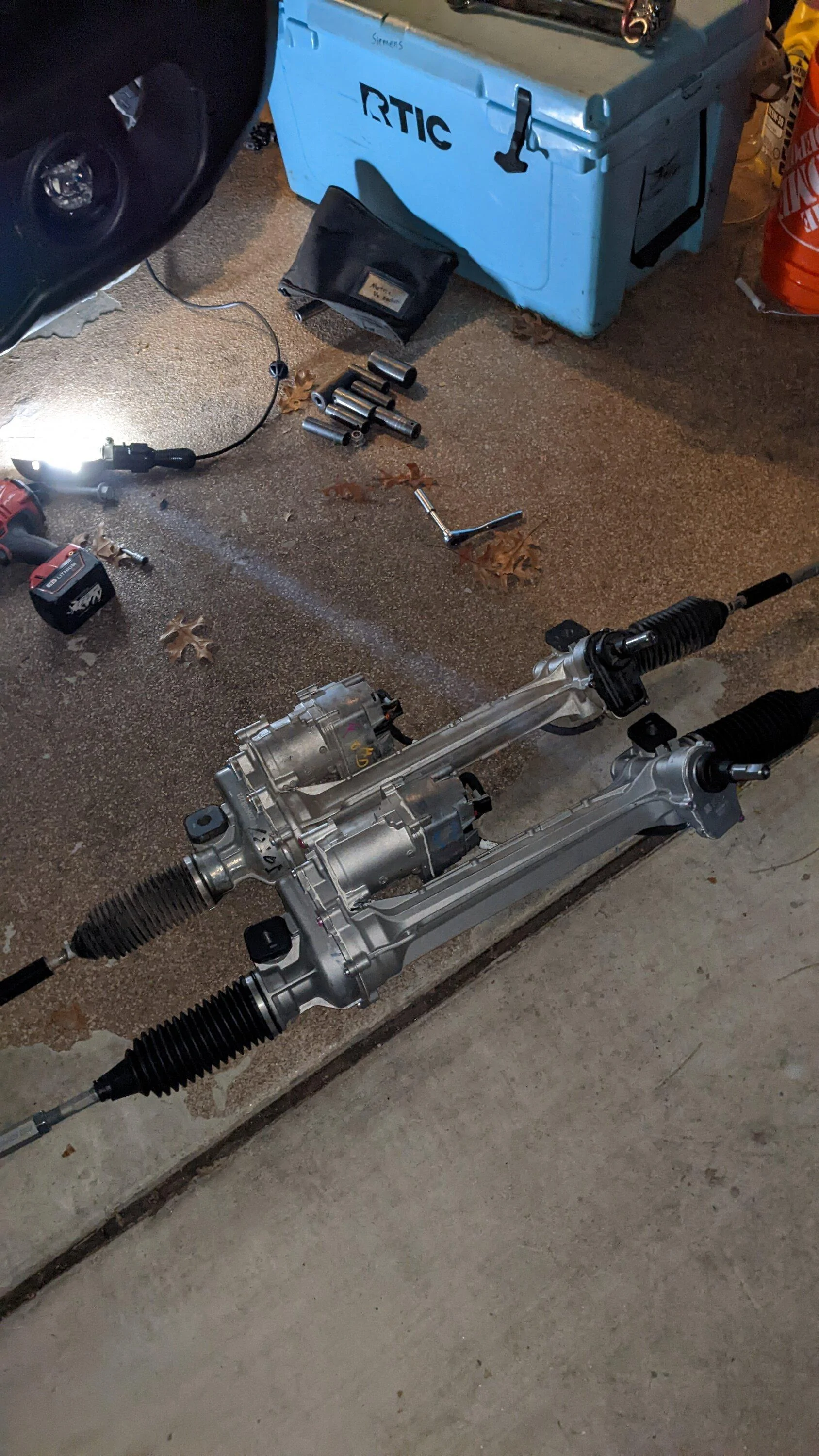

I would say another rack would be my next move. I just don't see 37s causing the overheating issues over something internally wrong with the rack.
3.0 is beefier, but I still think it will break.

Bronc Buster Billet housing is suppose to reduce stress on motor because it keeps the rack out of a bind. I am thinking that will help with heating issues. It sure looks a lot heavier than the housing on the 3.0. I was very interested in the 3.0 rack but I went with Bronc Buster housing and bushing because I was afraid the 3.0 would still break over time. I can also say that the BB housing is very heavy duty with hardened steel bushing inside of it.

I believe my eyes 😳 it’s physically bigger. Are the gears inside the same🤷‍♂️.
