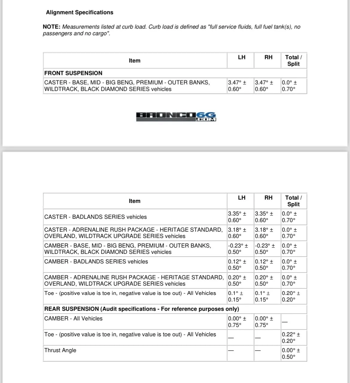

I had to call a couple though as one didn’t have the program updated for a 2022 Bronco. Which seems weird.
That's funny, the same thing happened to me; had to drive 25m away because "we haven't loaded it into our machine yet". I just figured they were lazy or hadn't had any (fat chance now), but I guess it's a thing.
SierraBronco
Mar 27, 2024
5,278
14,260
Surprised me too! And apparently they can’t do it manually off the numbers in the attachment above. I know nothing about the machines so I can’t say whether it’s true or not 😂
It can be done manually, they just likely didn’t know how. I have to do this frequently when a new model comes out before the alignment machine gets updated to current model years.
