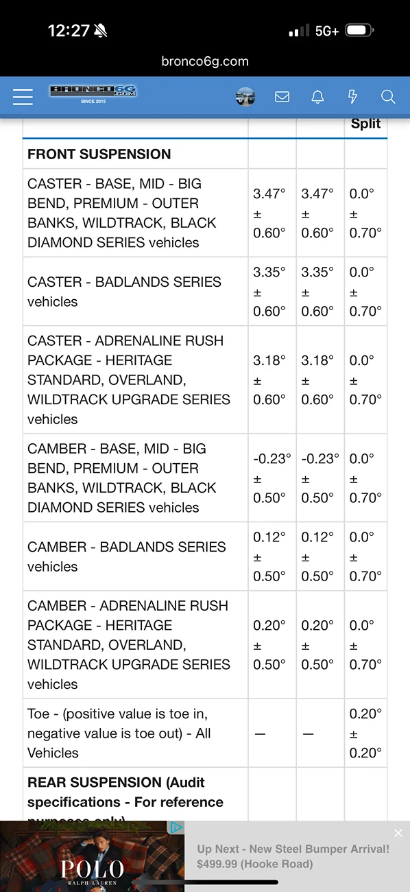

I had my 2025 outer banks non sas lifted 2”. Seems like I have some camber issues with inner front tires wearing faster. Had alignment checked and they said it was good. My question is should
I use the alignment spec sheet and use the numbers for the Badlands model?
Yes, use the Badlands specs.
