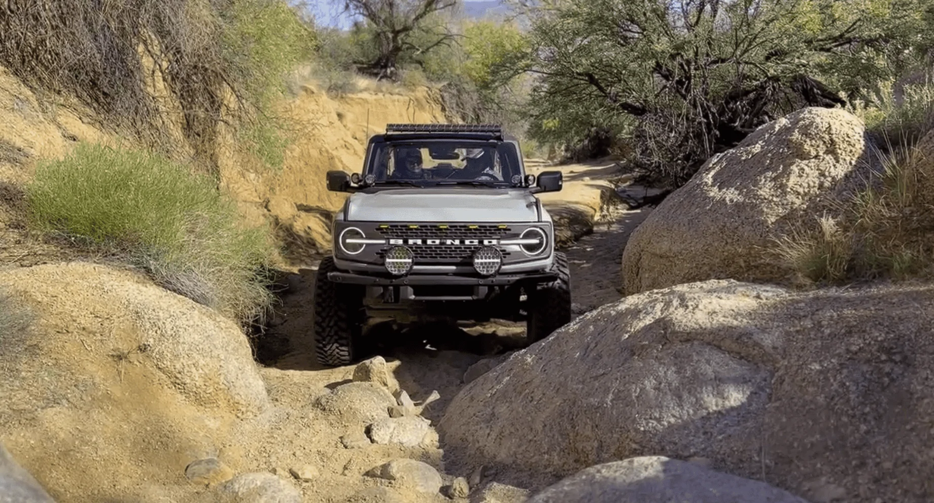

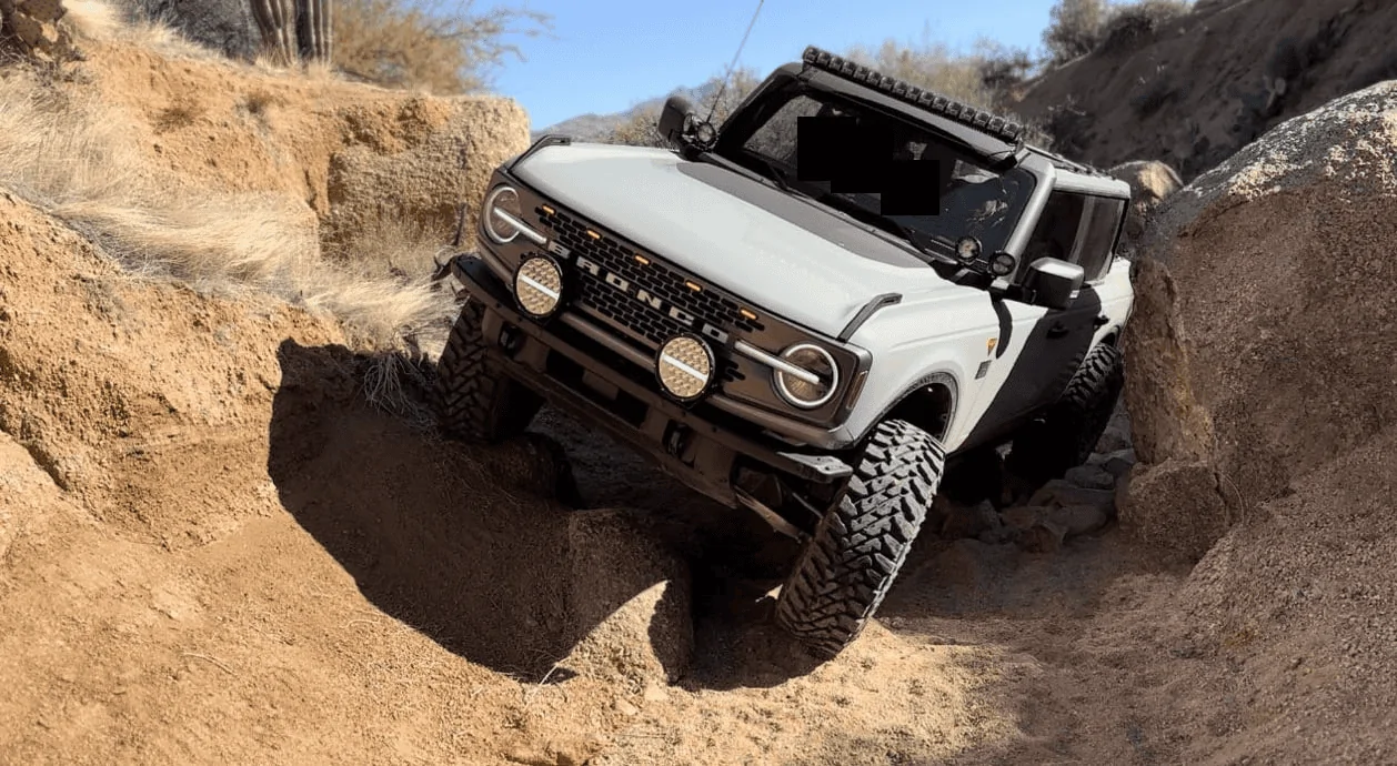

Hi guys!
So, I was running a 9 rated trail yesterday and had a very curious issue that I have not experienced prior with any vehicle and I'm not quite sure where to even go for help. This issue hasn't popped up on rutted roads or in washes etc. Only when I start crawling on rocks does the steering become unresponsive. Yesterday was the worst.
My steering would get so tight as to not be able to move the wheels at all without forward motion - even the tire in contact with the ground was on a somewhat slippery surface. As you can see from the photos below, the surface is very loose/sandy and even the rocks are crumbly. I would not expect very much steering resistance, even on 37s.
No grinding noises, no slipping feel.. nothing. Just an incredibly tight steering wheel. It almost feels like you would expect if you were trying to turn your wheel with some type of object in the way, stopping the wheel from turning. Once I'm back on flat ground, the steering feels just like the day I got it.
My only guess is I'm binding up the steering rack some how, but the only issue I was aware of with the Bronco steering is when the rack/pinion separate and teeth get damaged. Nothing like that has happened, and my steering wheel is still dead center (I would expect it to be crooked if the rack/pinion slipped.
Could it be the camber? I know camber plays a roll in steering. I do believe my camber may be a little positive right now..
My relevant rig setup is as follows:
2021 Badlands Sasquatch w/2.7
37x17x12.5 Yokohama Geolandar MT 003
Factory wheels with 1.5" spacers to clear UCA's
Icon Dynamics Adjustable Coil Overs
Icon Dynamics Billet UCA
.75" bump stop spacers installed front and back to limit rubbing with 37s
JKS Max Clearance Kit
JKS Tie Rod Braces
Lots more mods, but I think those are the only that matter for this conversation. Steering is still factory other than tie-rod braces being installed. Photo 3 shows the problem the best - you can see both front tires are on pretty slippery surfaces (the entire obstacle challenge is to get through without slipping and smashing your entire vehicle body into that car sized boulder)
So... any ideas? Anyone else have this issue?

Not sure if someone has suggested this already, but next time this happens, turn the Bronco off and back on again. If the steering magically starts working again, it's the motor throwing in the towel.

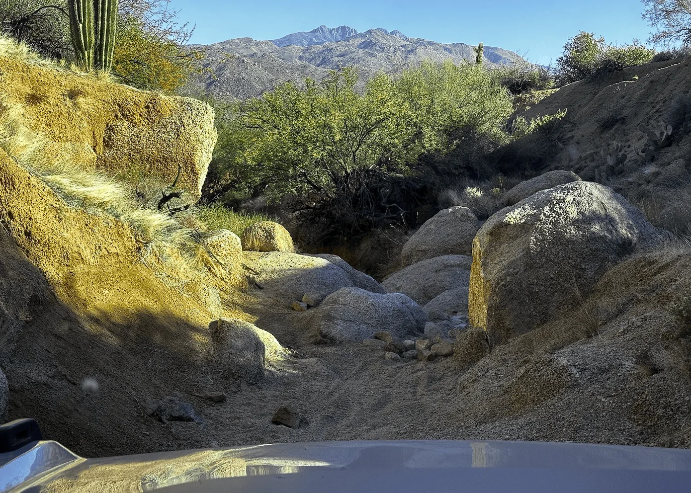

Where was the trail and was that a wash, possibly Sycamore Canyon? I noticed 4 peaks in the background. (I live in Mesa)
Yep. Rocker Panel Pass connected to Upper Sycamore. Started having the issue going back through the first two obstacles after clearing it the first time. Really washed out this year after the crazy monsoon we had.
I map trails for OnX Off-Road and was out looking for a connection between Upper Sycamore and the trails to the north (Thrill Ride). No luck that trip - the old mining trails are crazy overgrown right now.
