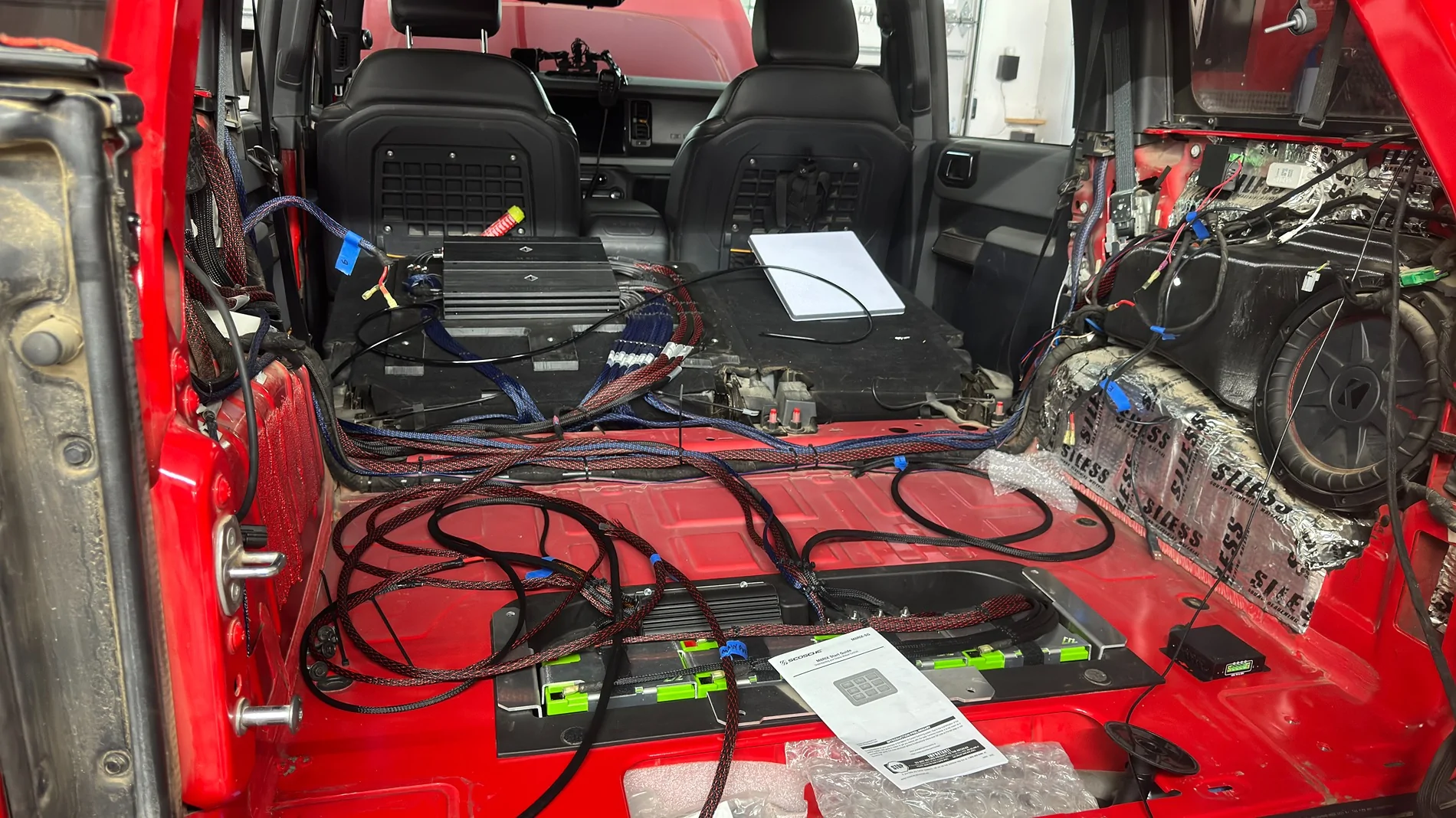

They did fine after DSP tuning, otherwise they were too bright. At the time I had the ZenA2B and a JBL DSP4086, plus a kicker amp for the sub. Since then, I've replaced everything except the A2B. I'm like 2 years behind on my build thread, should probably make an update.
