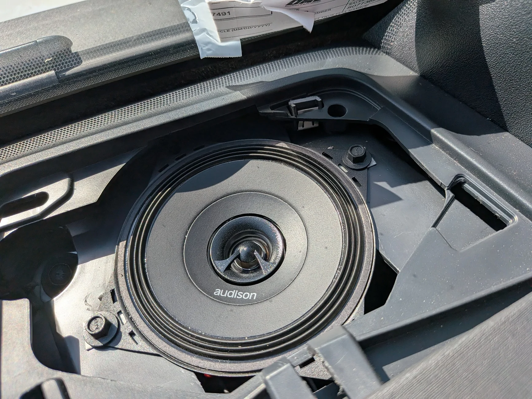

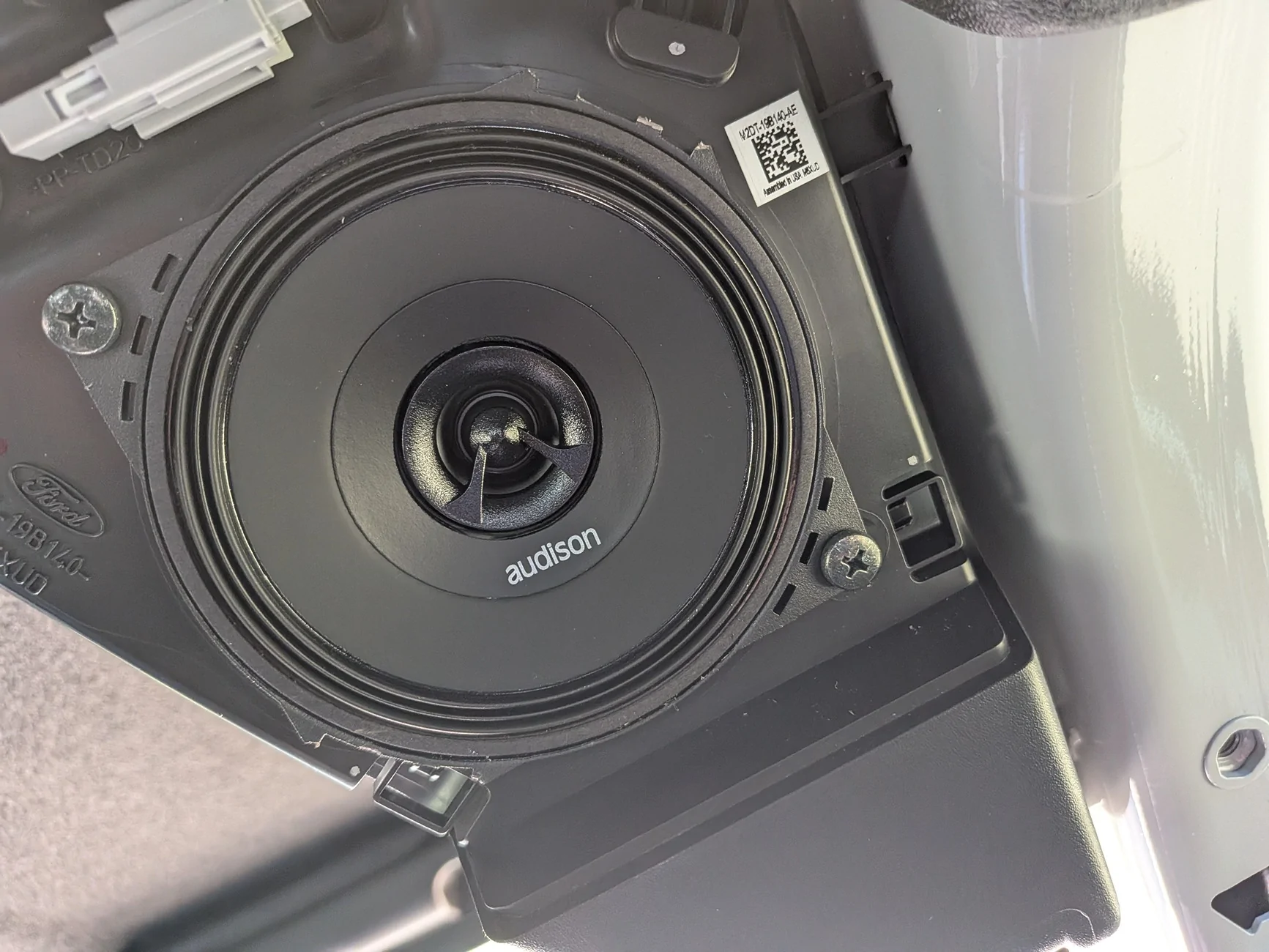

I received the Audison speakers yesterday and installed them this morning. Defintely a huge improvement. The OEM full range speakers look and feel cheap, no tweeter.
I did buy the Forscan USB to OBD adapter. I'll take a look at doing that. Not sure it will make that much of a difference on the base audio system.

I used the AP for pods....

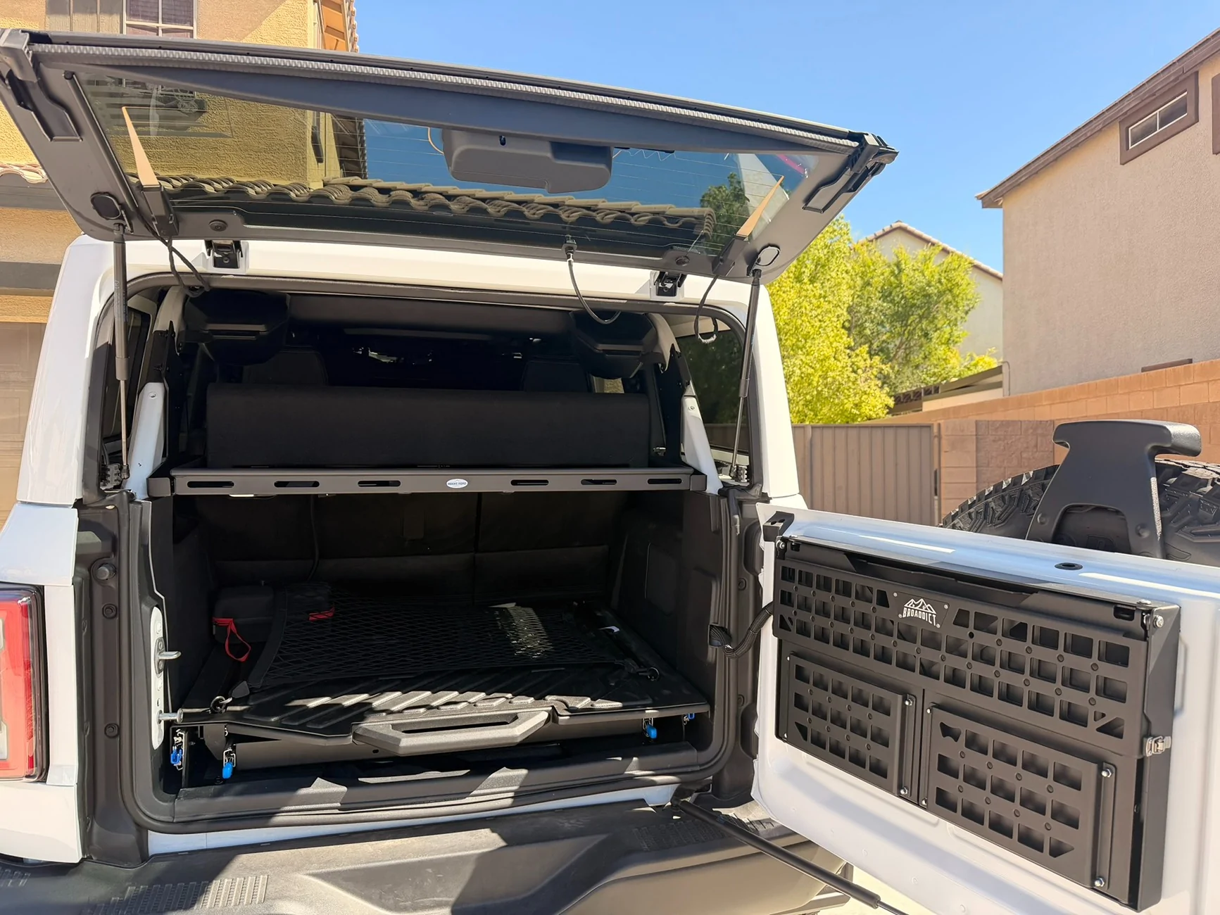

Downfiring Enclosure Kicker 49DL7TDF122 / with dual 12" L7T (Mounted on upper cargo shelf with 1/2" gym mat on shelf for sound deadening)
Factory Sub Location 3d printed enclosure with Kicker CompRT 10"
I have the Wolfbox G900 Tri Pro Dash Cam with rear view mirror cam so I don't have worry about anything blocking my view. I can remove the enclosure on the shelf easily (quick disconnect anderson plug) if I want and still have the 10" in a 3d printed enclosure.... in the factory location. I do the work. Took a while for me to figure out tuning and speaker choice.

Very nice! I like the idea of a quick disconnect if you need the area for storage. Might have to get one of those racks too.
