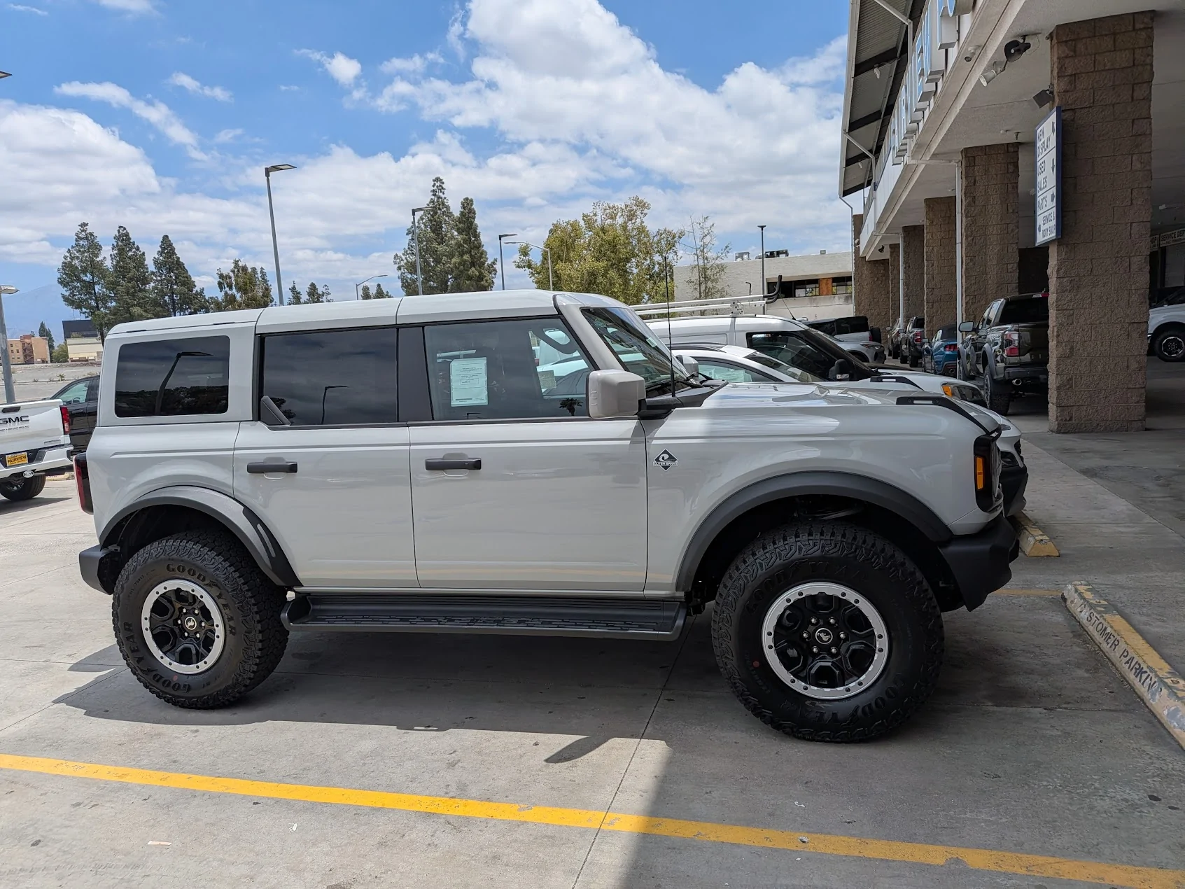

Picking up an OBX that doesn't have the Lux system. I read the the Lux system can be a pain to replace, which made my decision to get one without it. Thinking of getting the Focal ACX 100 to replace the front corners. I don't have an amp, but will likely add one later. Any other suggestions that are good before and after adding an amp? I had the ICU 690 (6X9) in my last vehicle and really liked them. I do prefer bright because I have hearing loss. So can tell good quality, but anything too expensive would probably be a waste of money for me.
Probably add a 5 channel amp. My last truck had the Infinity 5 which was good enough for my use. Mostly Rock and Country music.
I saw Focal also has the ICU 100, but Crutchfield says they won't fit. I don't mind spending a little more for the front. Amazon has the ACX 100 for $68. I don't mind spending around $200.
I'll probably do the rear and sub too, but not right away. Looks like an 8" sub?
The only thing I kept from my old truck is a JL 12" in a downfiring sealed box. I could use that, but was thinking of trying to keep the sub in the OEM location so it isn't in the way of storage.

First, your truck is GORGEOUS. love the combination of the all gray and the wheels with the trim rings. Just bought those wheels and BFG 35’s for mine.
