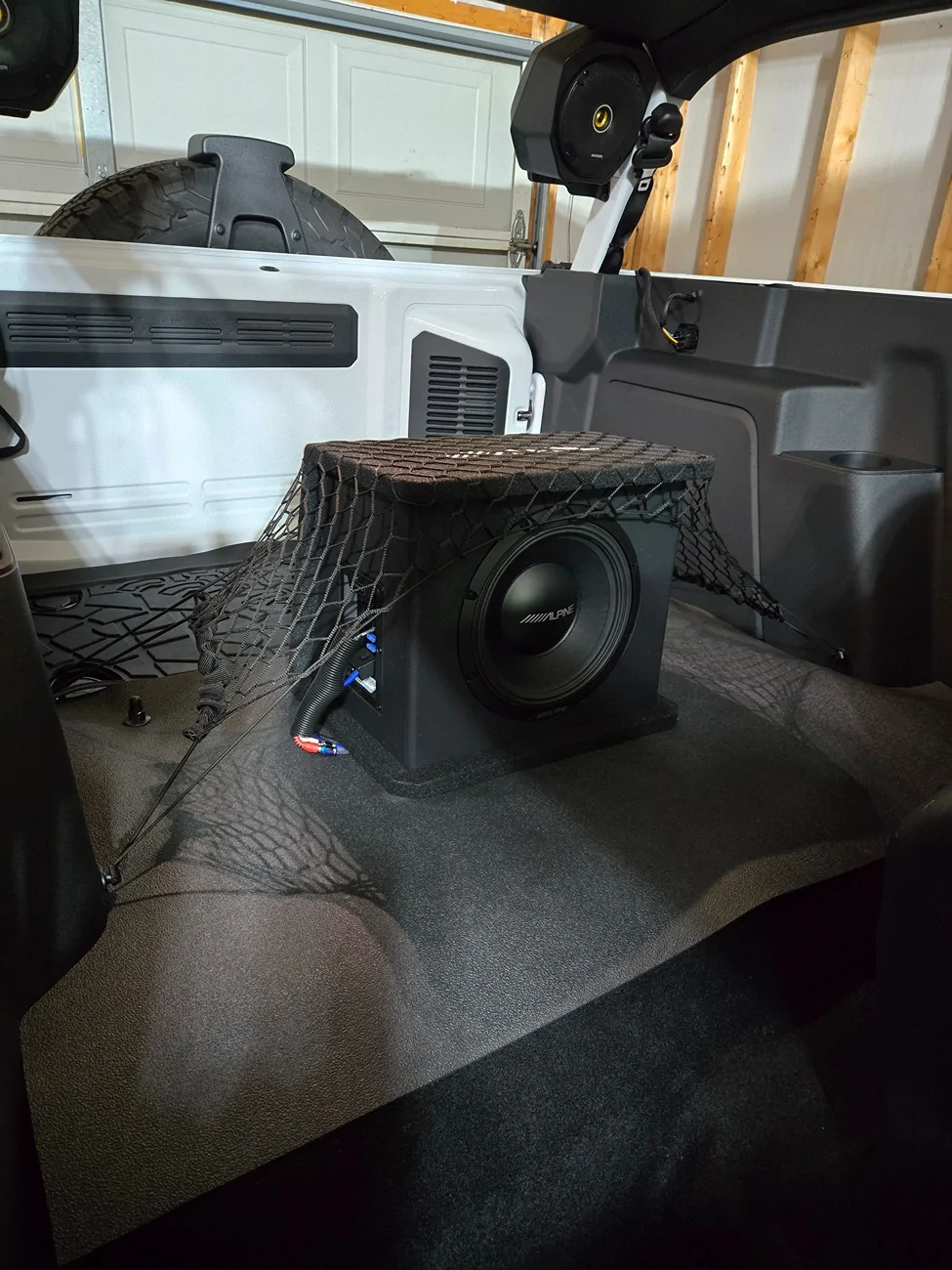

I didn't want to tear a bunch of the rear apart. Adding more bass to the rear panel was not going to fly with the....rattles, vibration and such. I upgraded the dash speakers to Kicker DS 4"ers and did the SSV rear pods with Kicker CS 6.5"ers. I left the kick panel OE speakers alone. I then added the plug-n-play 200 watt Beat-Sonic amp for the speakers. Fit like a glove under the steering shaft. I then added in an Alpine PWE-SB10 powered sub and pulled the fuse for the OE sub amp/speaker. I used a cargo net to hold the sub in place so I call pull it out if needed. Made a VERY noticeable upgrade in both sound quality and volume. I did nothing with FORscan for the rear pod speakers.

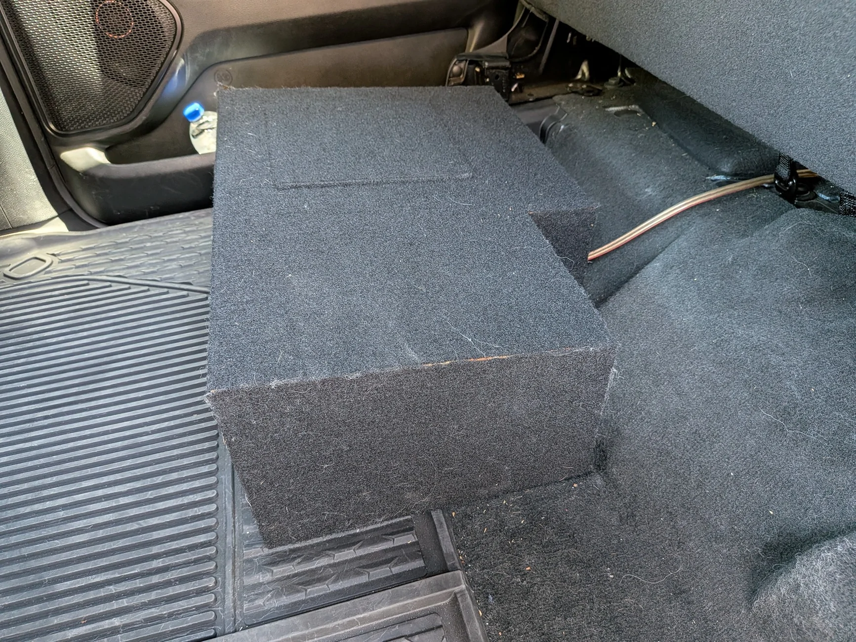

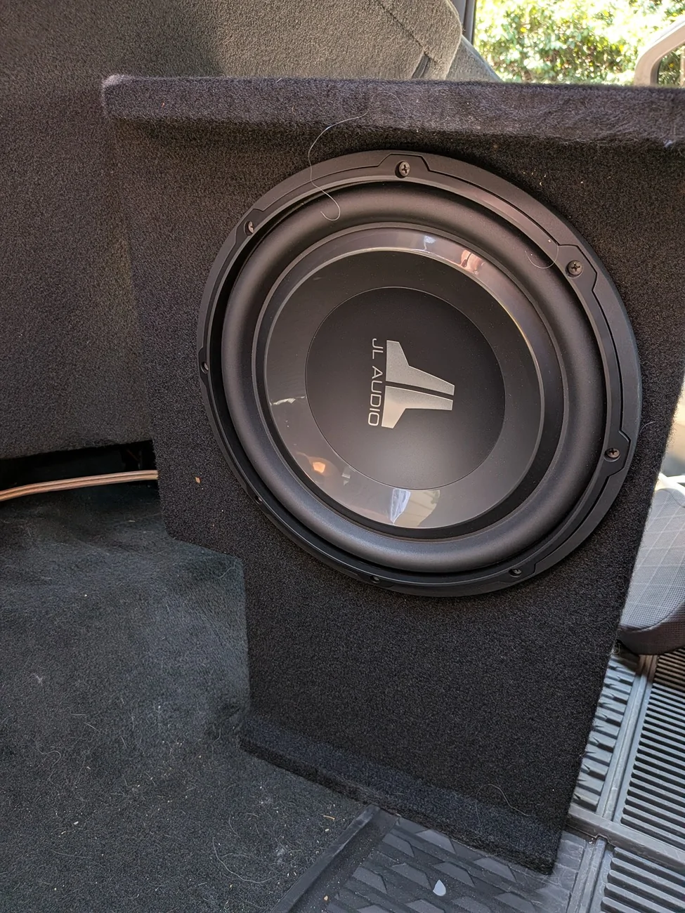

So phase 2 will be an amp and install the sub that I pulled out of my last vehicle: A single JL 12" in a down firing sealed box. Might be temtped to get a tailgate 10" or something else that won't take up storage space. Though the box I have will work decent storage wise: down facing and all black carpet. So if I have to put cargo on top, it won't hurt the sub. Probably not the correct decision sound wise, but I do already own it. So 0 cost.

Looks like some have put an 8" sub replacement in the factory rear. Many seem to think it isn't worth it because of rattles. So probably just unplug the OEM sub an use my old JL 12" in the storage area.

Using current JL 12 is the way to go.

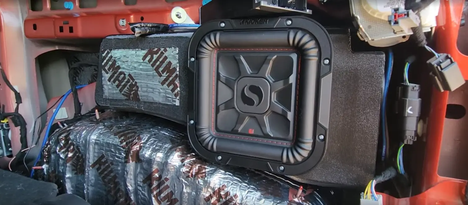

My sub & amp came from factory not working, so since I was replacing both, I figured I'd upgrade the box to this: https://additivecaraudio.com/shop/bronco-subwoofer-square/
Fits in the factory location perfectly. Just had to run a thicker power cable for the amp, but that was pretty easy.

You can use the OEM enclosure and fit the Kicker Comp 8" (and probably others that are shallow mount as well) with minor and easy modification. It's highly recommended that you seal the back port up on the enclosure if you upgrade the subwoofer though.
I have an OEM enclosure, sealed, wrapped in Kilamat and ready to mount another 8" Kicker if you want it - but I'm not mailing it out. The sub I had in it started to fail, but I still have it laying around if you want to see how it fits.
There are replacement enclosures that fit the OEM location that can size up to a 10". If you want larger than a 10", you need to look elsewhere - hanging off the tailgate is a popular location, there's several that mount in the cargo area in various ways - but you are gonna lose some amount of cargo or storage space any way you go there.

The Beat-Sonic is plug and play. The large plug going into the head unit is interrupted and fed through the amp. It comes with a T plug. I did not use the blue signal wire. The self-amplified Alpine sub has the ability to turn on sensing music to the sub via the RCA cables.
It was as simple as using the supplied wiring harness.
