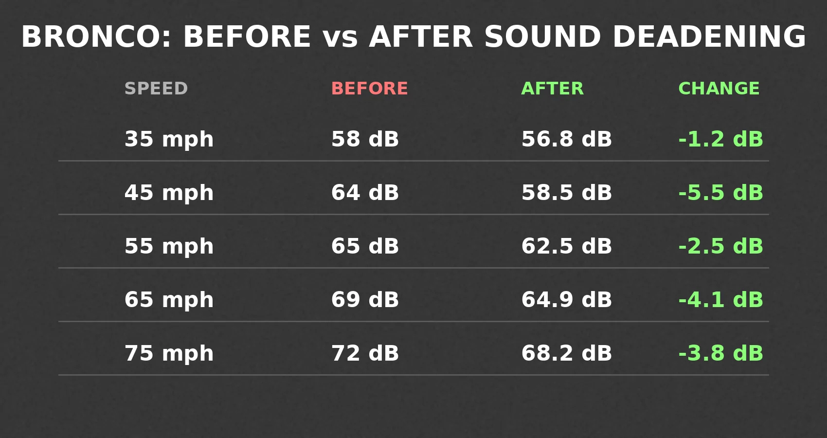

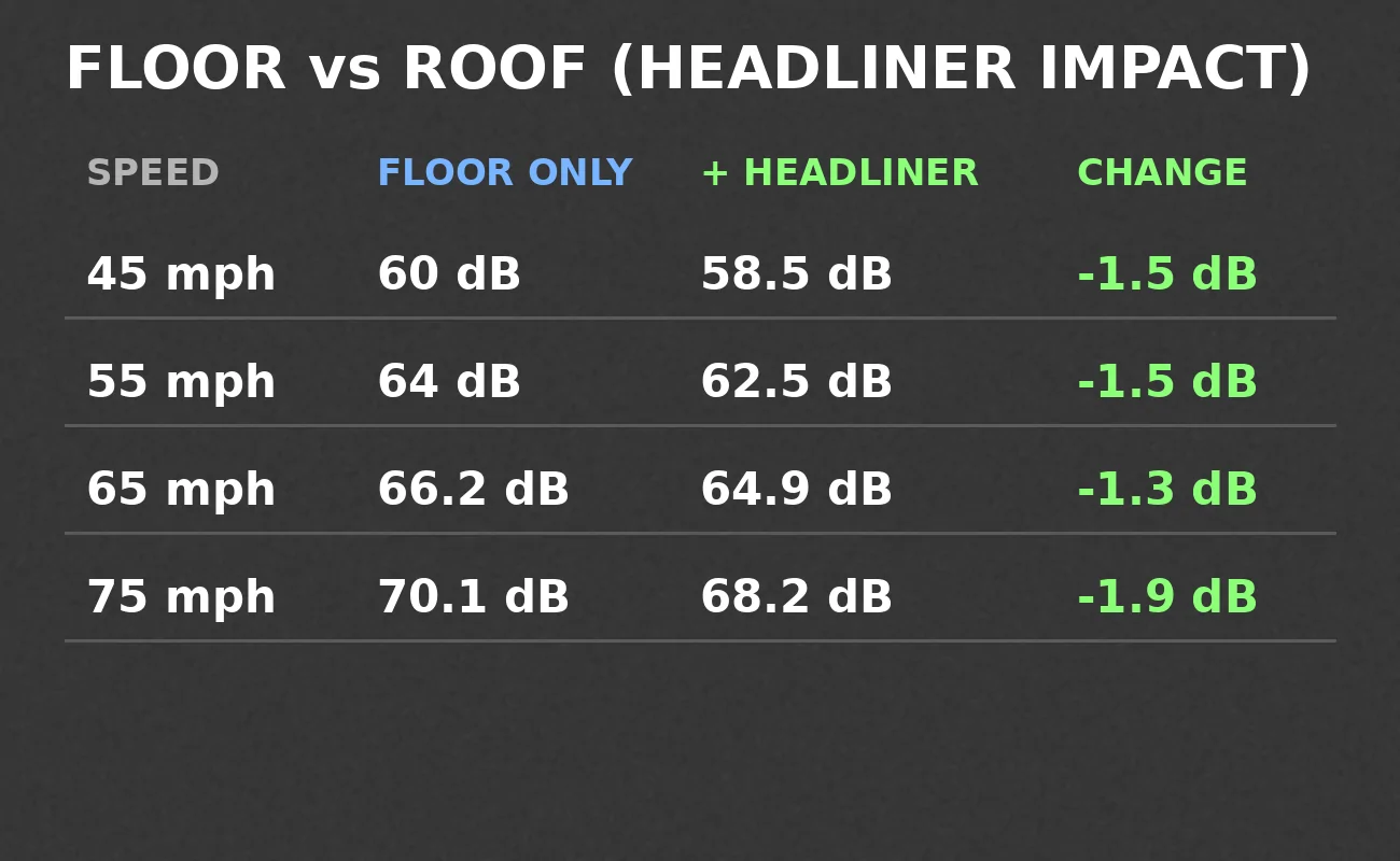

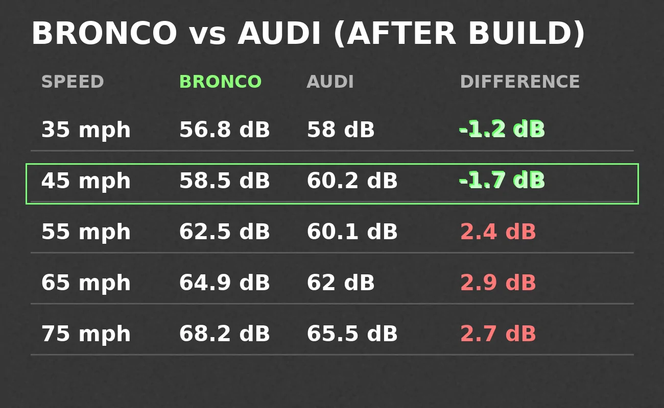

I agree with others here. I’ve done extensive work and trial and error. The kilo mat plus closed cell and 3m thinsulate works amazingly well. I have a video I’m editing on how I did mine. Should be done soon. Did lots of Db testing. Doors are big and so is floor. The headliner is not a big bang for buck but does help absorb sounds once’s in cabin to give a more premium feel. Also believe it or not the largest change of frequencies in the cabin was adding Mat to inside of skid plates. I have full skids and I used neoprene washers. Huge change in road sound. The bronco can be nearly as quiet as a nice suv such as an Audi q7. Just takes a few afternoons and $5-800 in materials. But your sound system will be the big win. I thought about upgrading but now it sounds premium and we found we can’t turn it up as loud anymore ha!
The testing charts I attached are probably a little louder than what you should expect. I have icon uca and those things really transmit the road noise and I’m on portals which don’t add noise but push tires well outside the wheel well so that adds substantial turbulence along sides.
Also as other commented. It’s a brick so above 60 mph you lose the battle to aerodynamics.

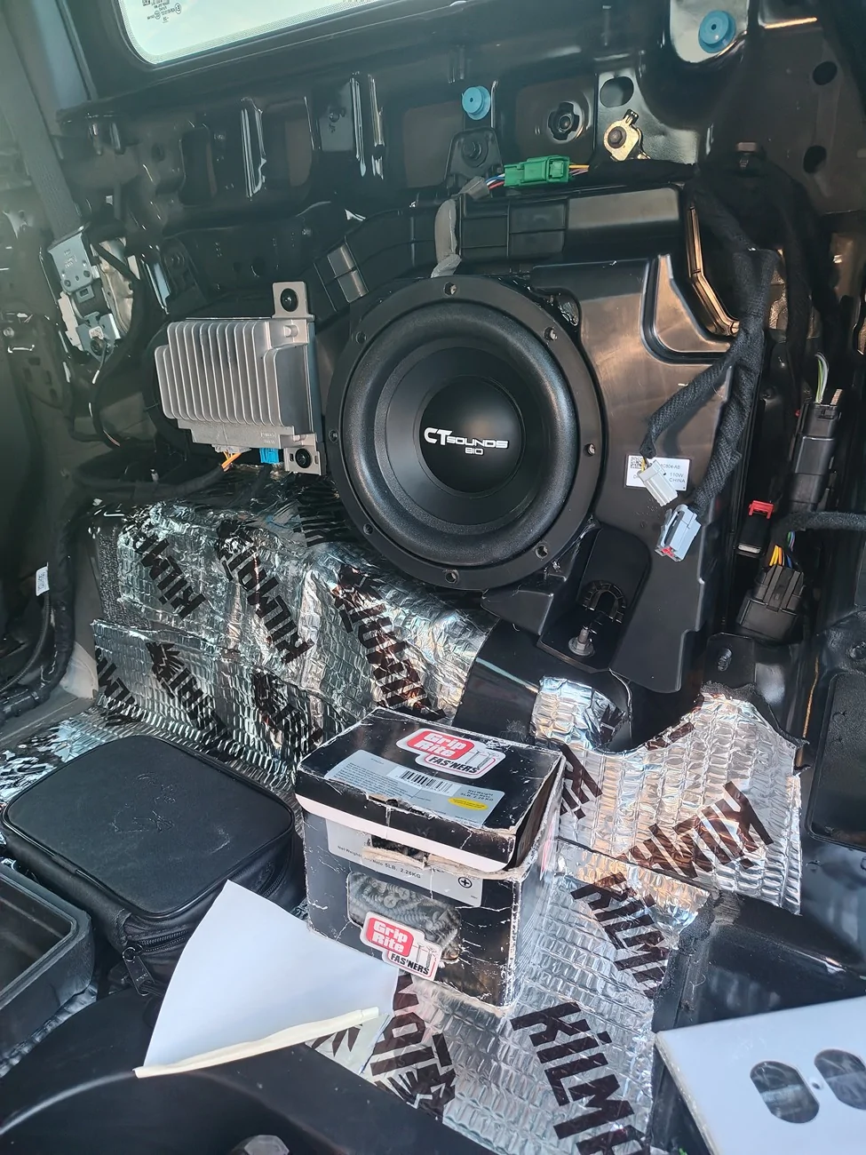

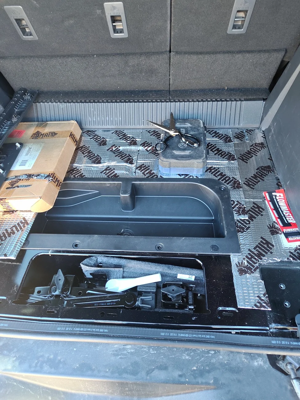

I did the cargo area and the bottom of the cooler in the rear floor. I also did in the passenger side around the factory sub. Going to be pulling the enclosure back out to do a little bit more since it rattles still and going to be completely doing the back of all the rear plastic panels since they also rattle from bass. Definitely a quieter ride but I also have a louder exhaust that I installed. Planning to do doors soon. I honestly don't know if I'll ever get around to doing the floors. I really don't feel like tearing all the interior out.
