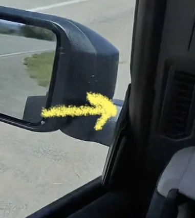

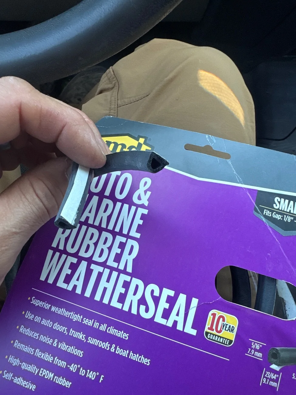

Go to Home Depot and buy the self adhesive backed weather striping. Separate the 2 and cut a piece about 3” or so. Roll window down and slide the strip in there so the adhesive sticks to the upper part of the triangle trim then roll window up and close door so window presses up against it. Then cut the access material with razor blade.
The air comes in at the top and shoots inside where the gasket flexes or pudges.

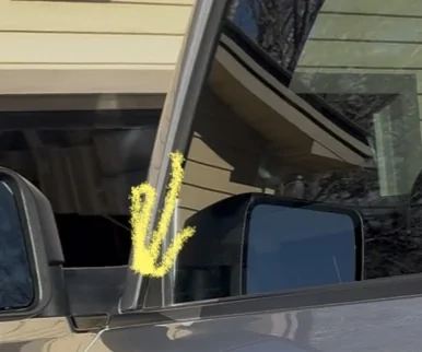

I’m not around the bronco right now but here are some photos of the location. The weather striping sits inside the channel so when the glass is up it compresses the weather striping and seals the air coming in. Follow the contour of the window at an angle so the strip takes up slack in the channel. The. The window is up you don’t see any evidence of the weather striping

If the triangle gasket is whistling there in my photos that is your issue most likely. If your door is whistling at the top by your ear then carefully pull down the window gasket on the hard top and even a tiny bit eliminates the whistle. They move down a little.
