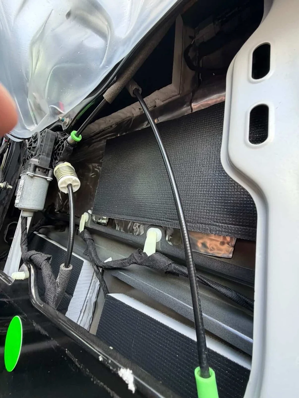

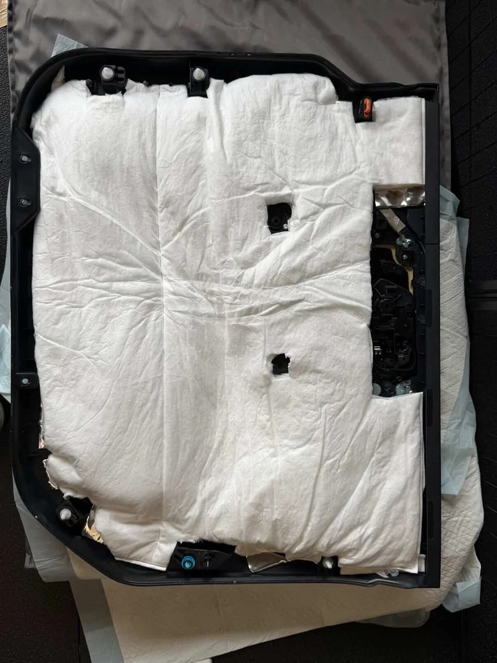

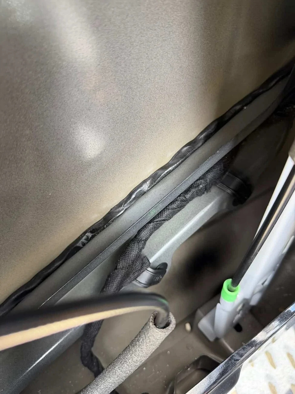

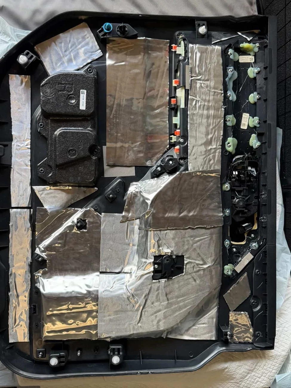

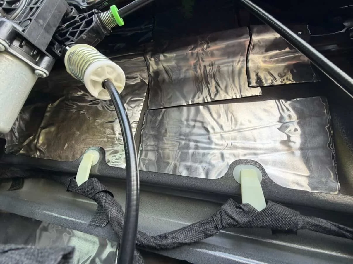

I did multiple stages of Resonix in my Bronco Raptor. All doors done, all door panels; full cargo area, cargo panels, and firewall
Full resonix treatment- butyl rope to tie the door bars to the outer skin, mega cld tiles, guardian - Hydrophobic Melamine & MLV Automotive & Marine Sound Absorbing Pad and Fiber Mat - Self Adhering Automotive Sound Absorber & Decoupler

wow! Did you take apart the dash for the firewall application? Id appreciate any insights into the process, I’m looking to start with the doors, then cargo. Have you done the wheel liners, I’ve heard this can be effective for road noise? I was contemplating upgrading the wheel liners to the aluminum aftermarket first and maybe sound deadening those instead of deadening the plastic.
