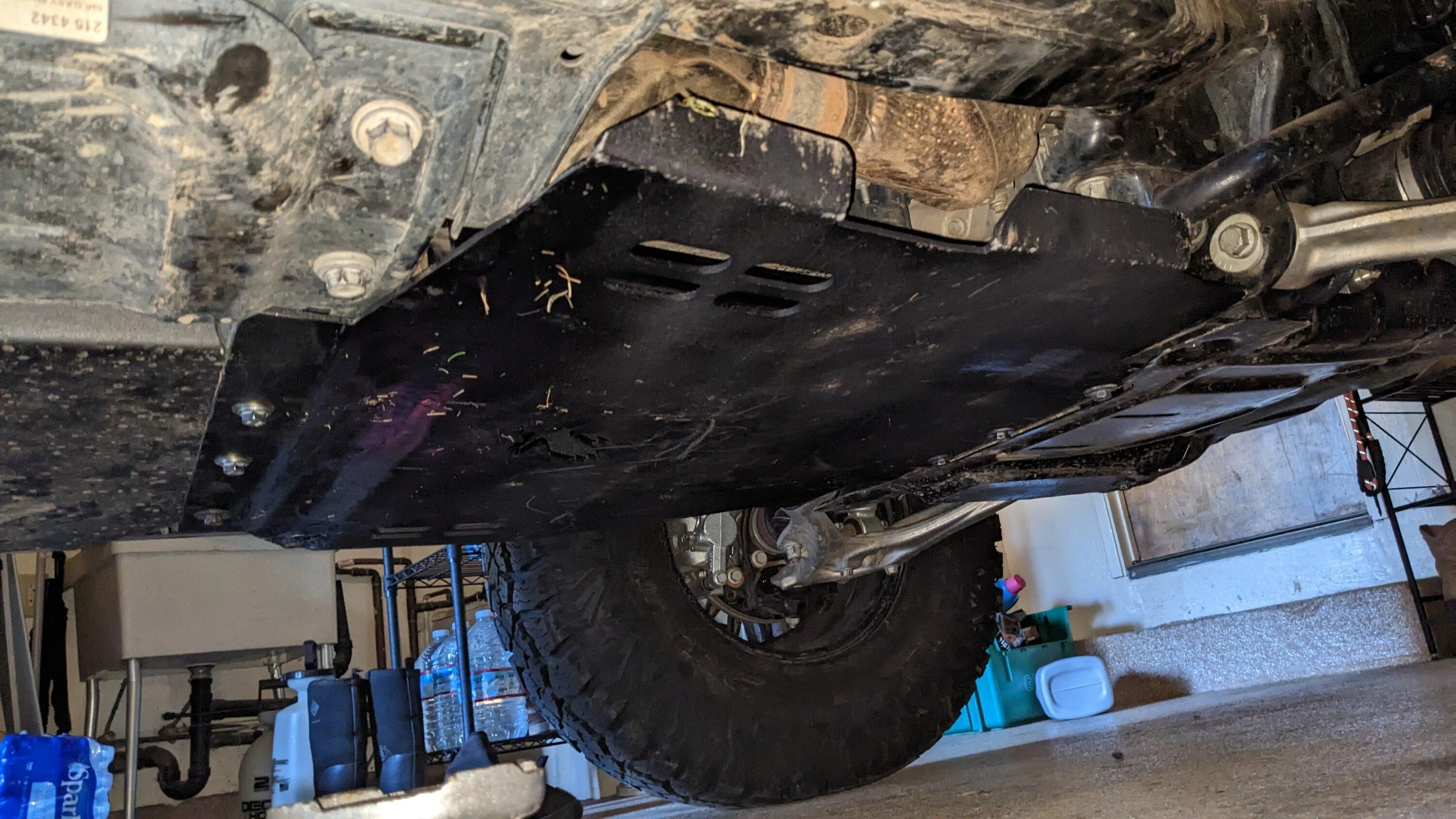

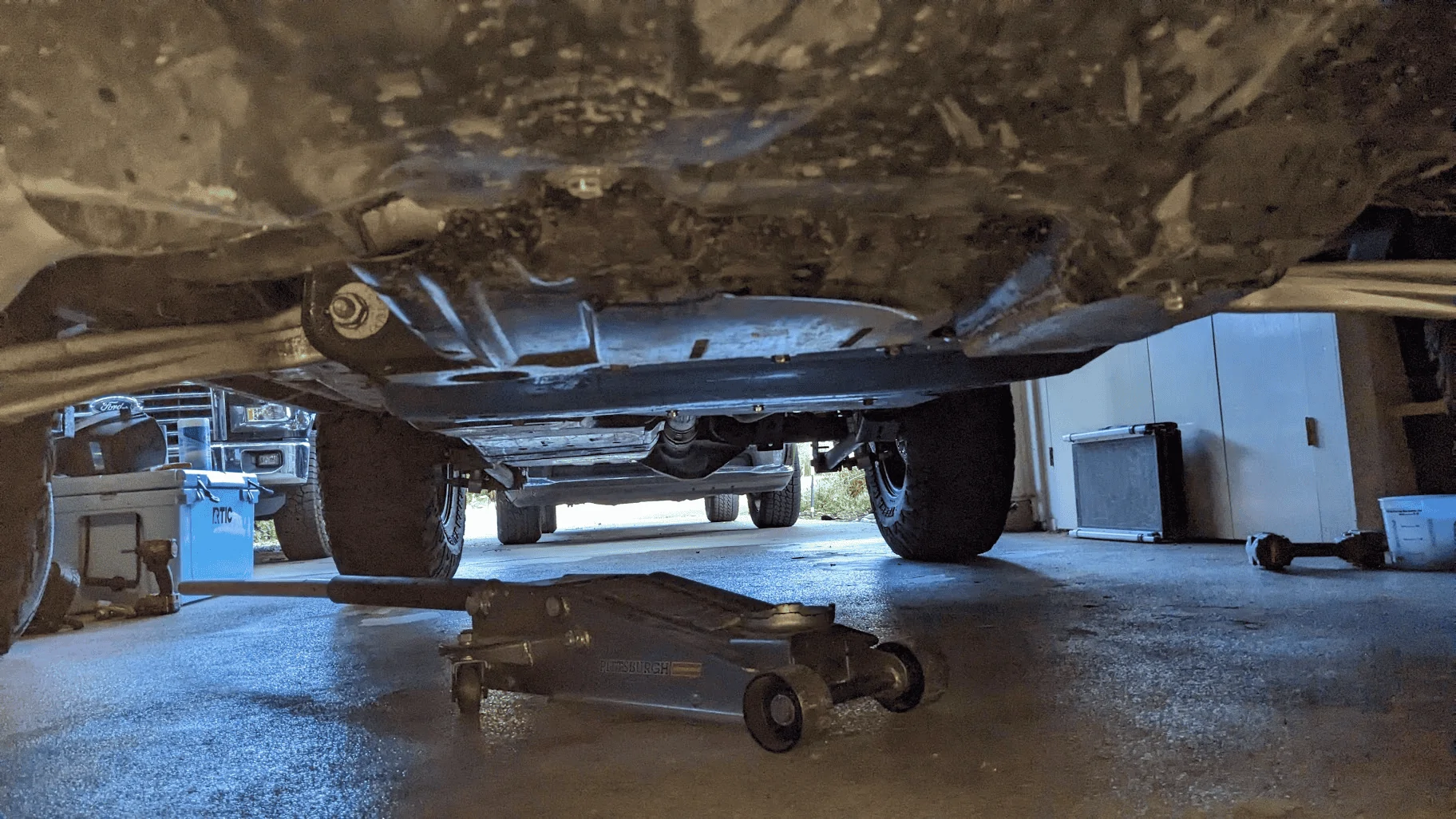

Ohh it's bad... Like 3-4" of dead space
Lol I like it better upsidedown, go figure
Ohh I forget to bolt up my sway bar all the way so that next
I had thought of getting the Mabett and mounting it upside down, but that would have required some bending to clear the crossover pipe. So, I went with the Asfir, it runs dead level, on those w/o sway bar disco, so that's better, but still a lot of dead space to transmission pan. It's minimal width so least hangy down area and good air flow.

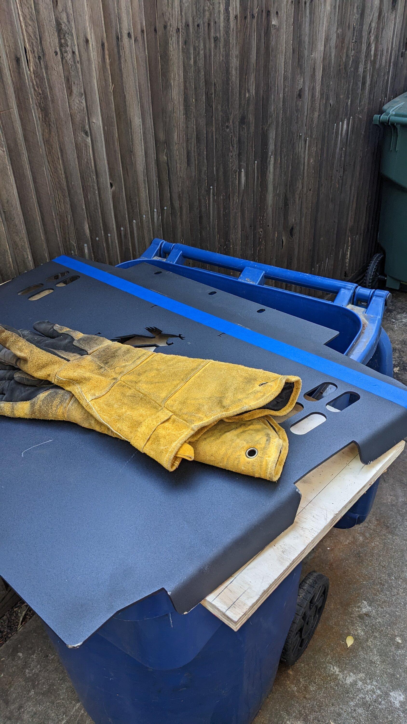

If Mabett or Asfir was steel I would have jump on them and add steel. This is just the biggest skid plate I could find in 3/16 steel.

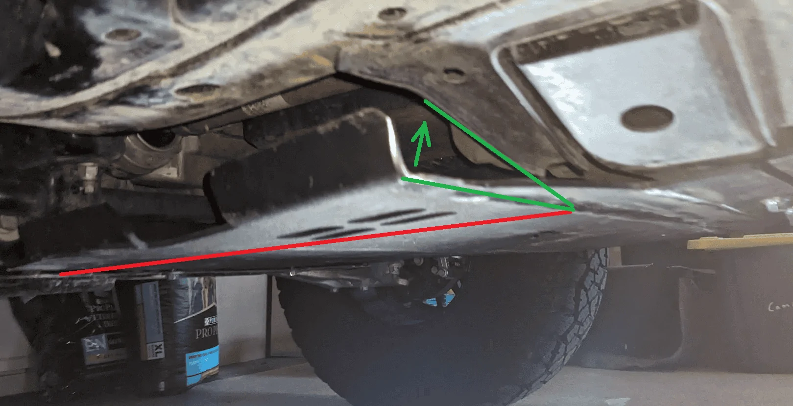

So, are you modifying to go upside down or recontouring right side up? I think they make them drop to clear those with sway bar disco,

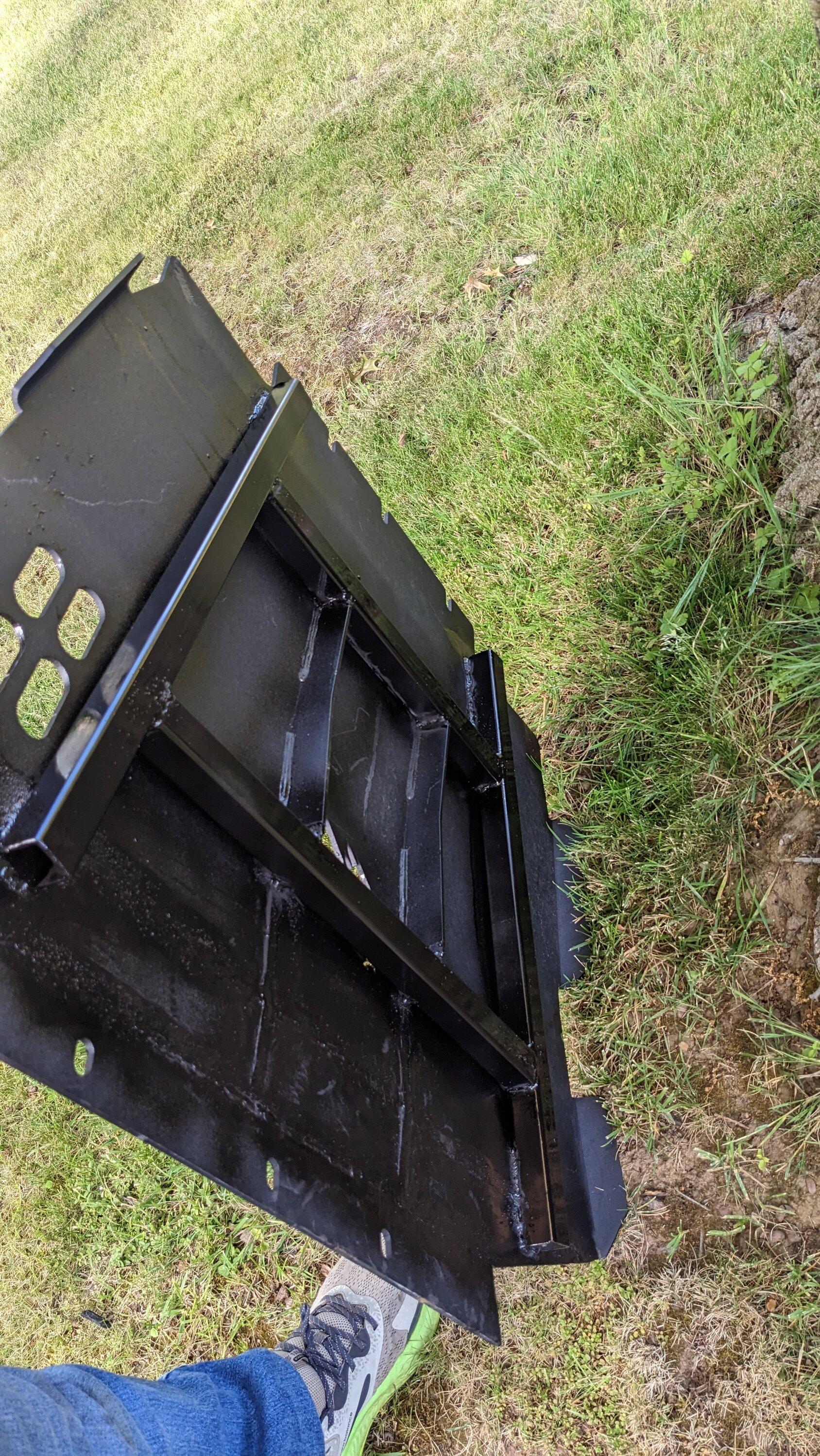

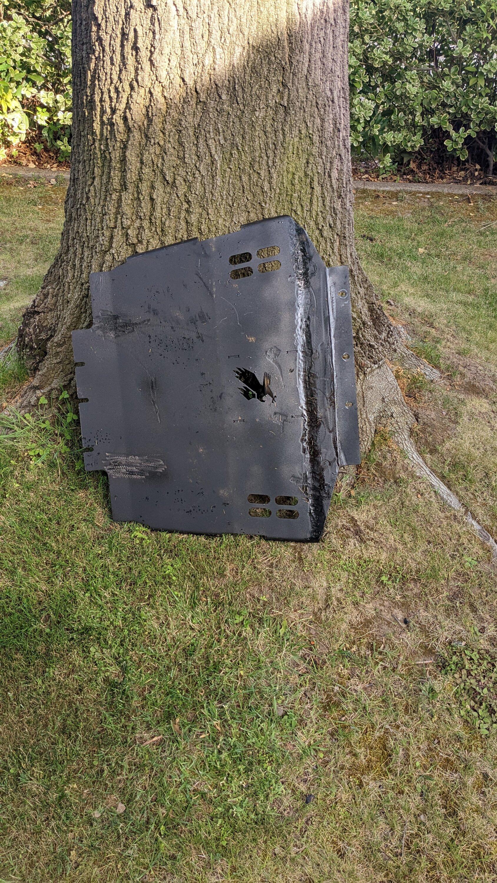

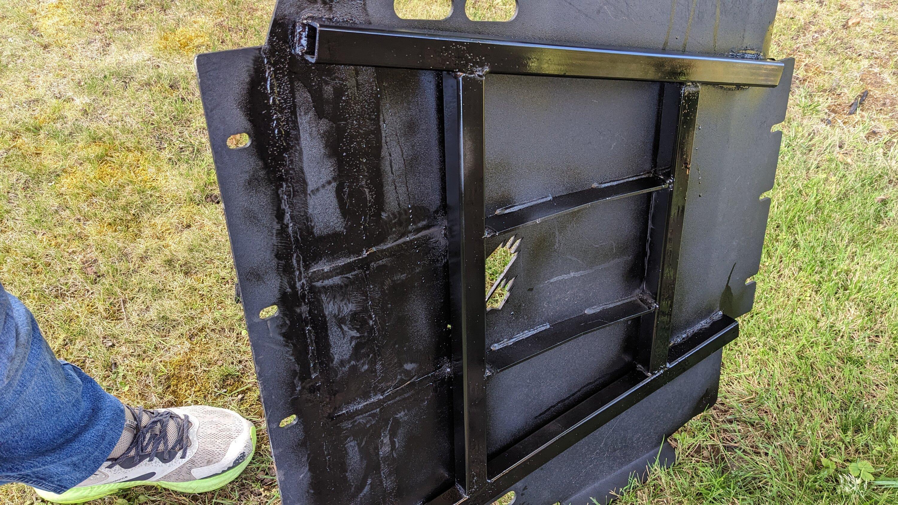

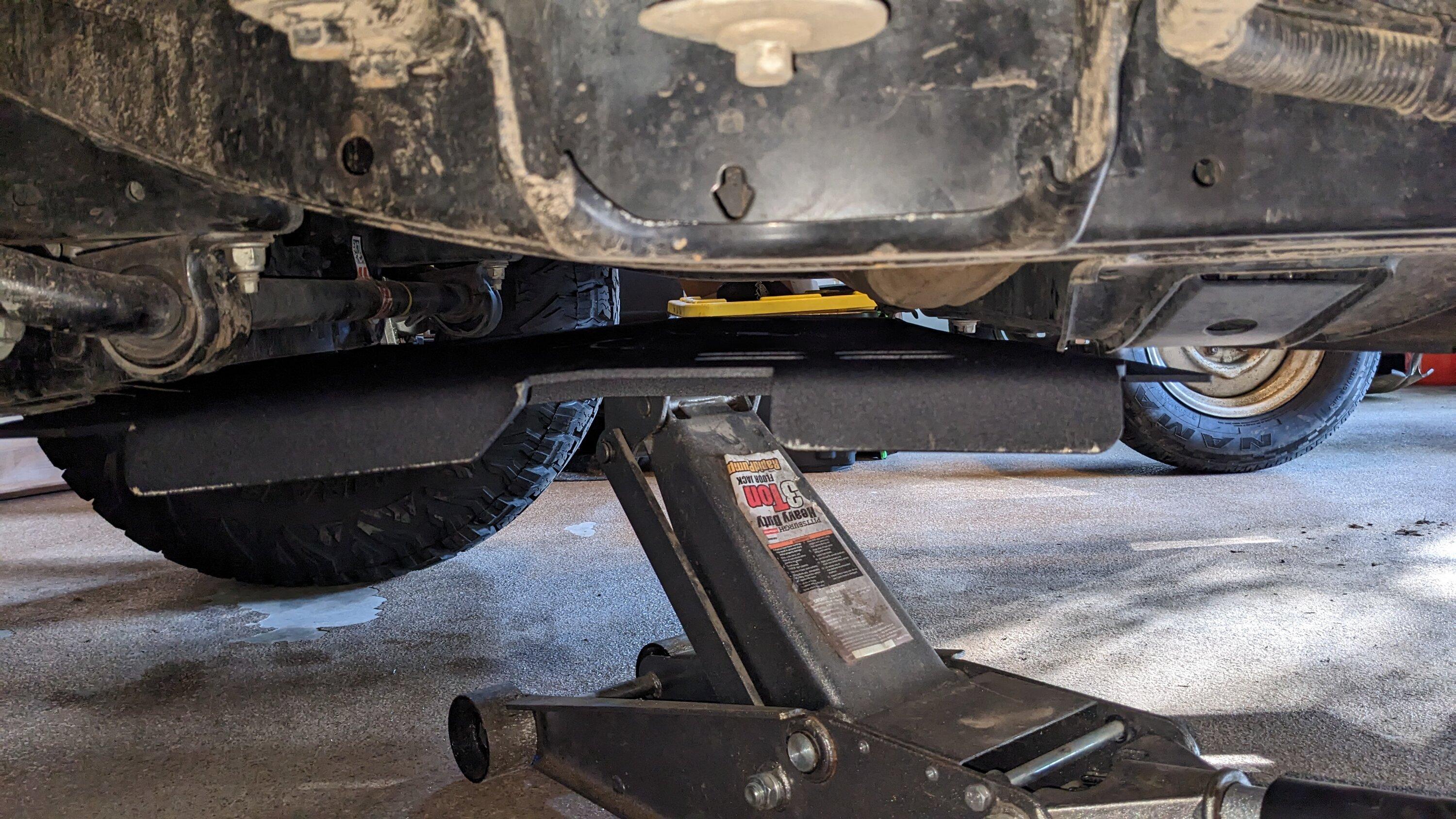

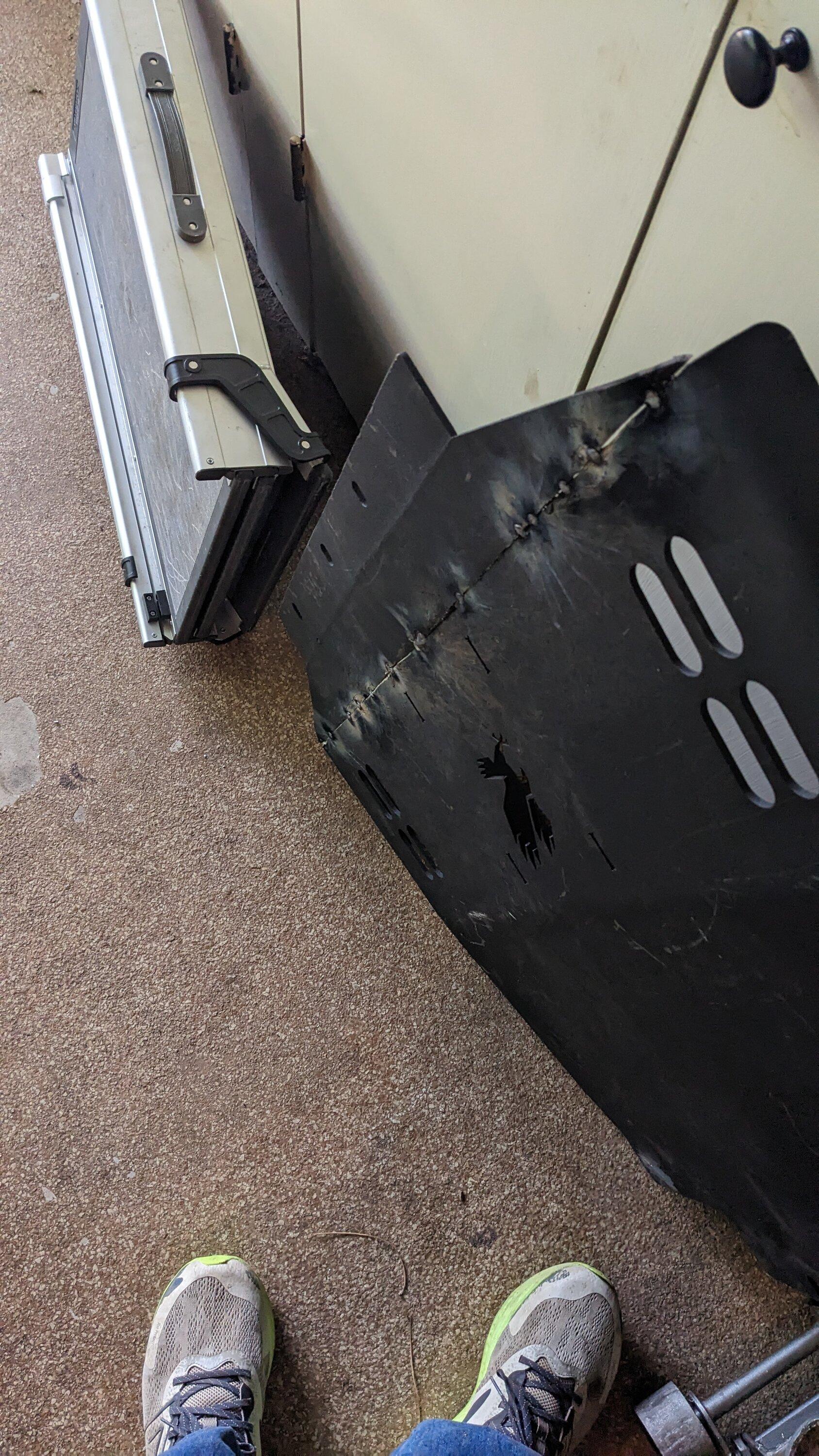

Flattened one side out. Need to test fit and see what else I can do. This got me another 1" of clearance. I can still be d.it for more if needed it's on tacked together enough to mock up.

Time will tell, it's always that bottom inch that hangs up...and you eliminated that??:unsure:...Right?
I noticed you flipped the lower bolts (also the bottom inch) on the 5100's like I did, not sure why this would not be universally recommended in the instructions for all lifts.

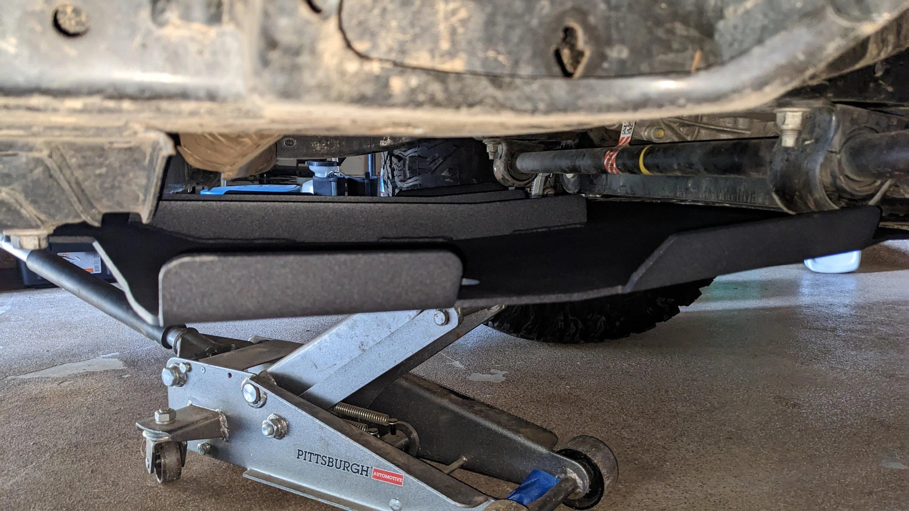

I gained 2" of clearance over my metalcloak, I am pretty happy with the current clearance. With time rocks will get me another 1" as the modified skid starts to deform. I am shopping some different hardware (better clearance and large head) but my only concern is the 6 10mm bolts holding the skid on.
I flipped my strut a arm bolts so I can pull the lower leveling kit spacer if I want to lower the front down.

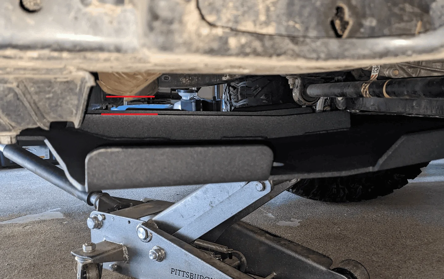

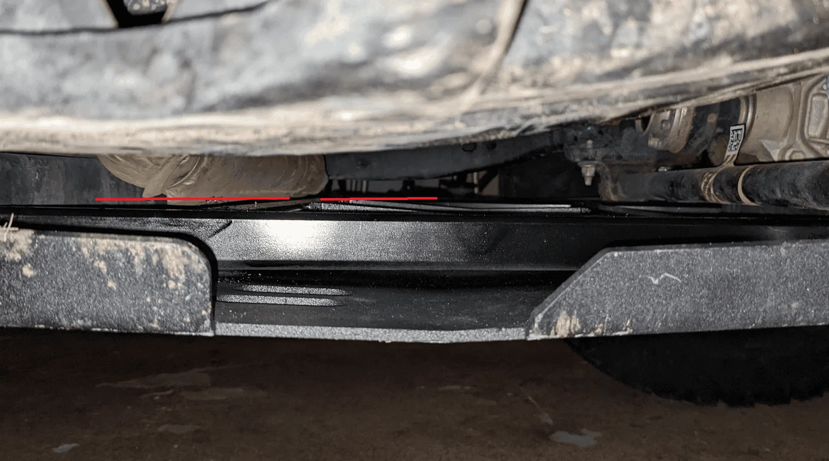

Bad resolution, but the sides should bend up and self clearance with time. The red line is the 1" square tubing reinforcing the plate and hopefully become where the skid plate will yield.
