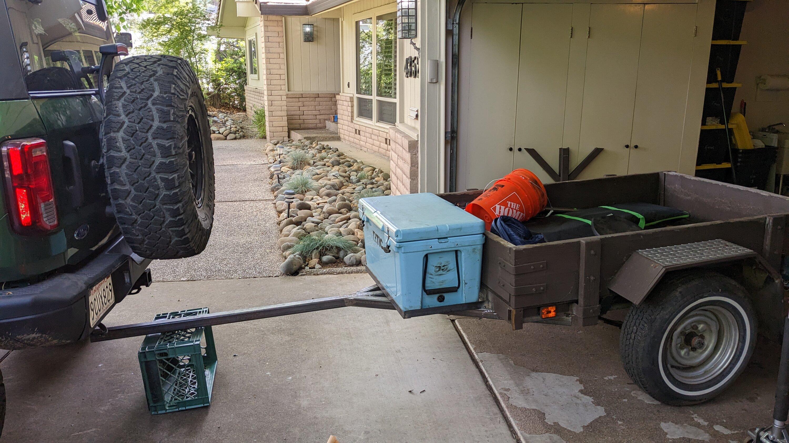

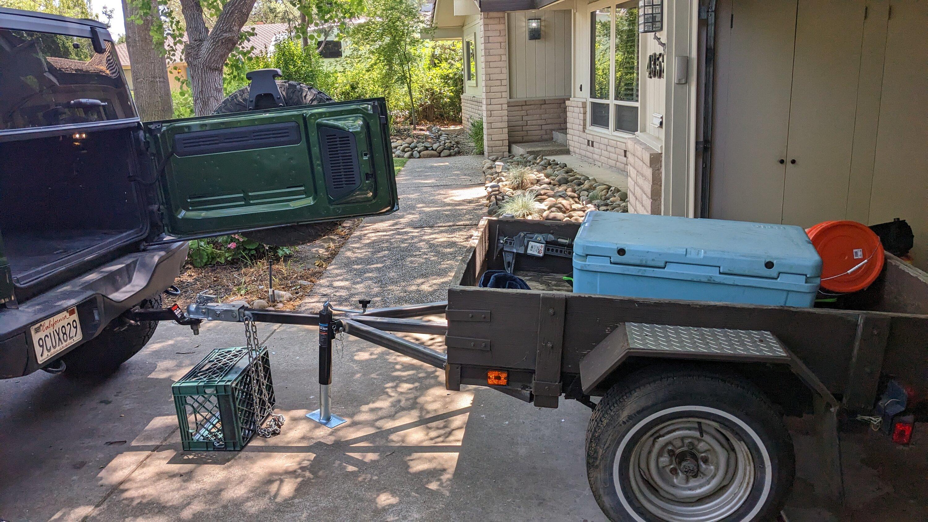

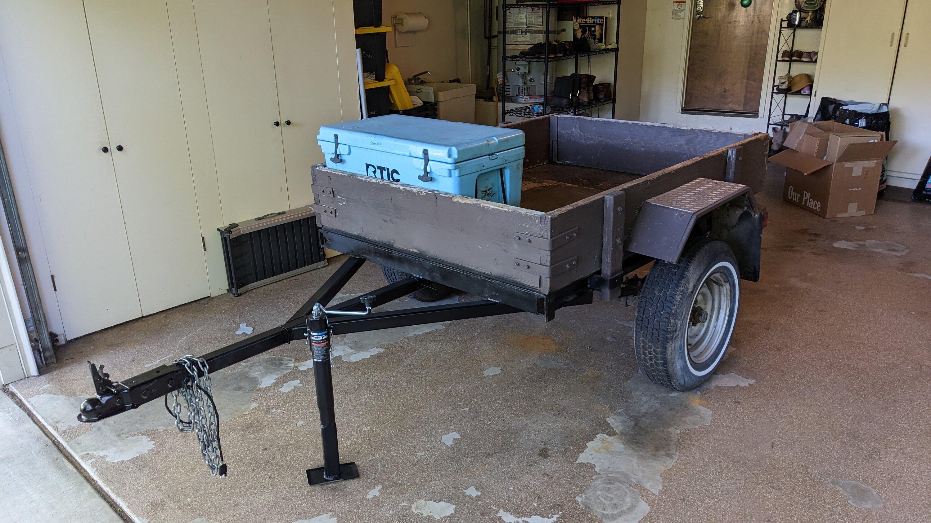

Well I don't think I can keep my ice chest on the front of my trailer. It just makes it to long. Started jacking the trailer up to lift it and the front tongue moved an inch so I cut it off and fixed it.

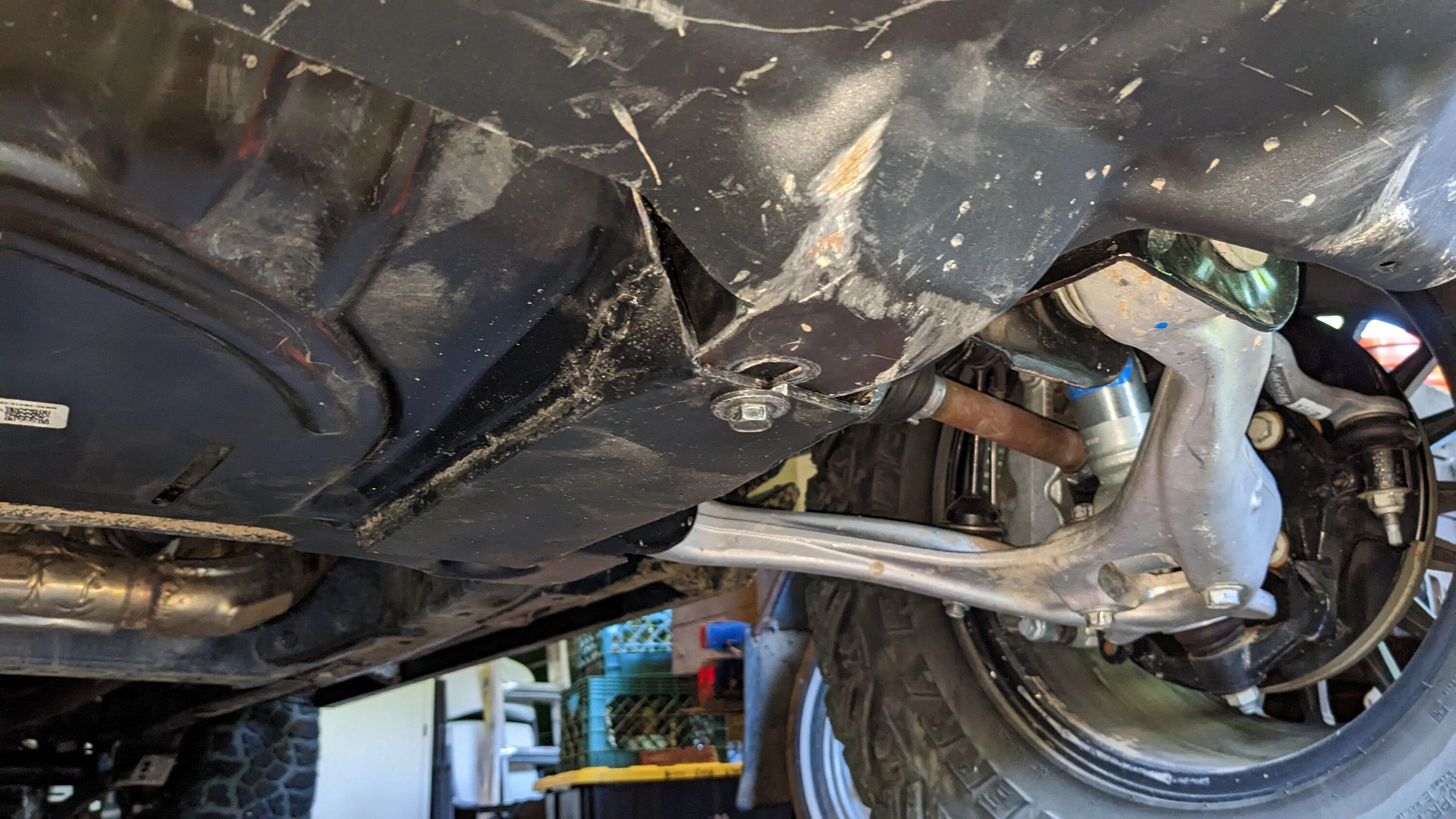

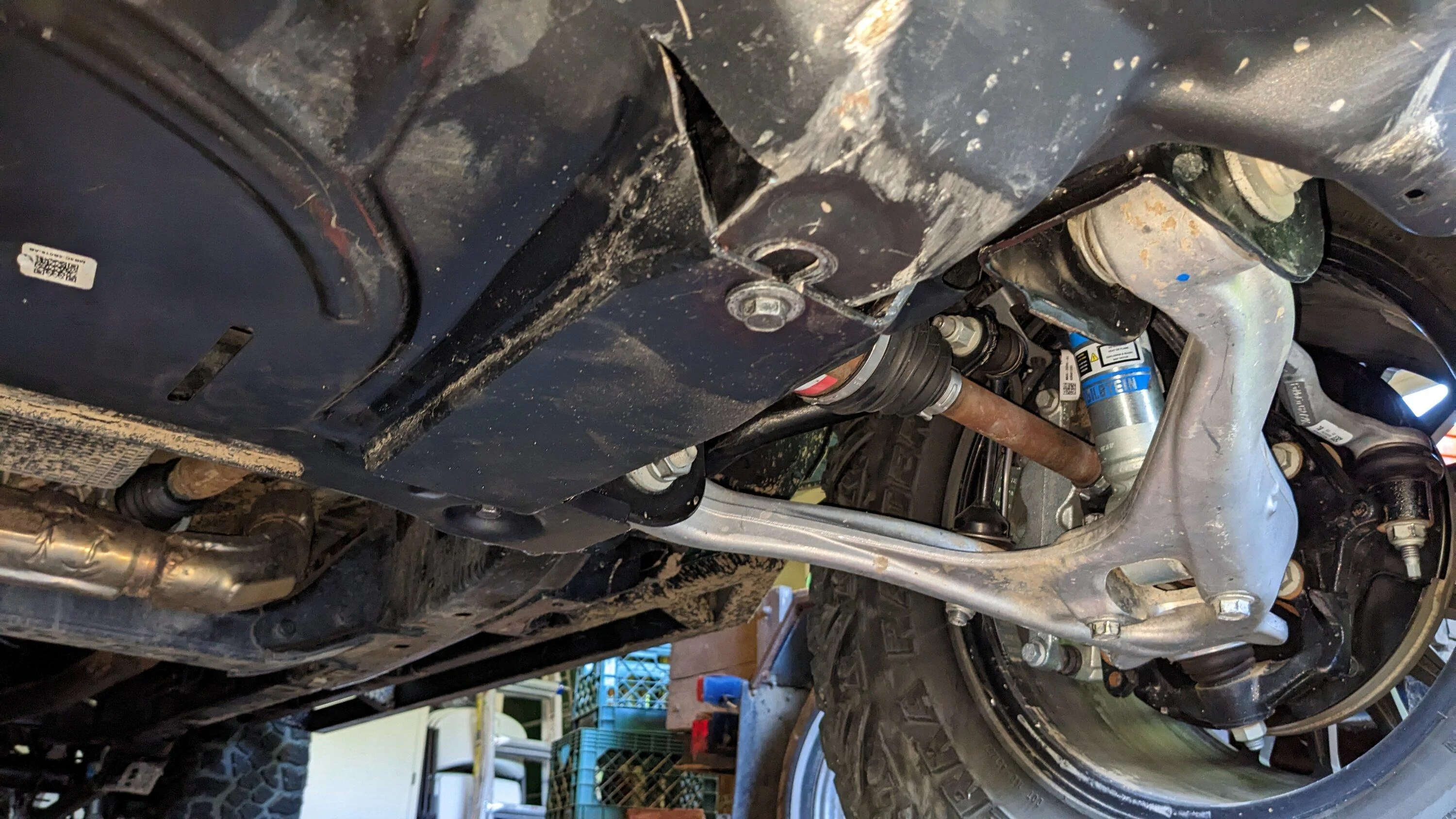

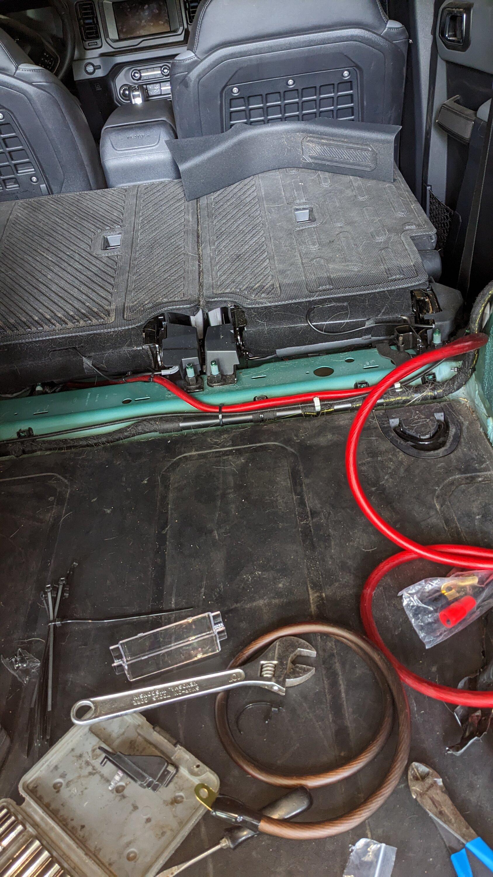

Memorial weekend break down. After hours of retaping bolts, pulling all my skids off. I boxed in my factory front skid for my diff drop.
Ford Bronco Snacktime's Broken Bronco Build PXL_20230527_223401074

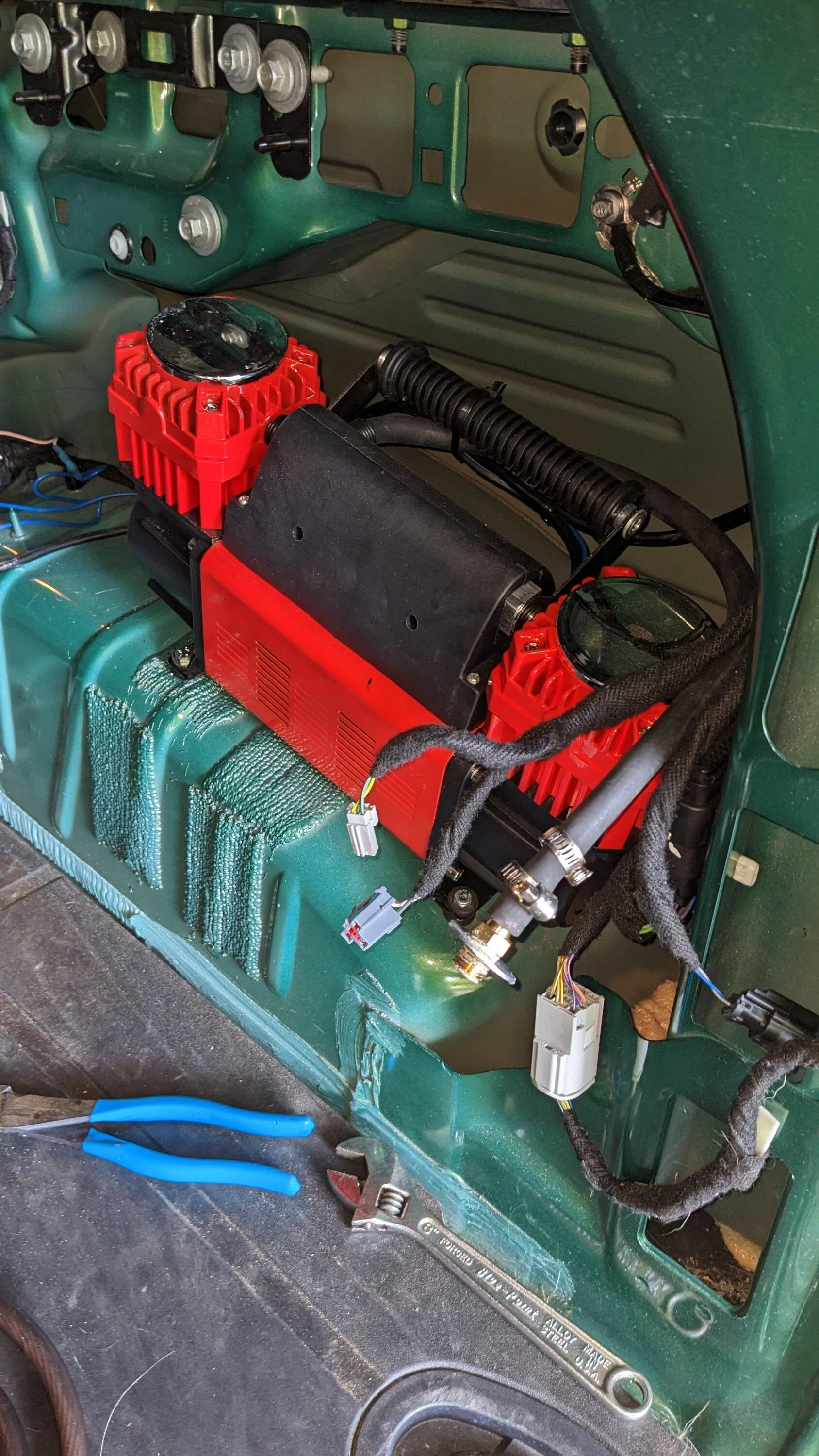

Install 1/0 cable for my compress and curt 4 prong trailer wiring harness.
Ford Bronco Snacktime's Broken Bronco Build PXL_20230528_162852306
Ford Bronco Snacktime's Broken Bronco Build PXL_20230528_171114439

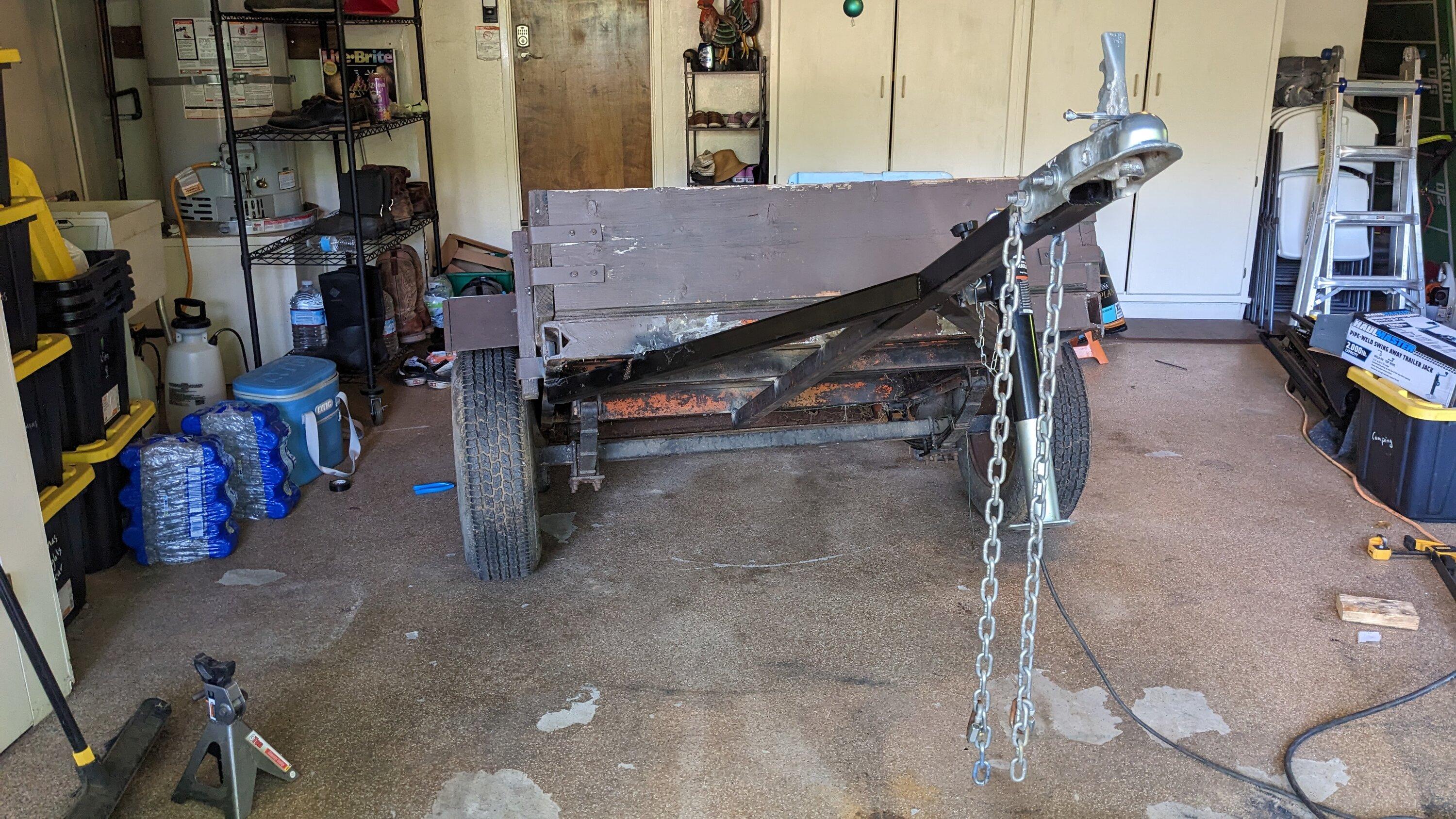

Rebuilt the tongue on my trailer, rewired the trailer and cleaned up after myself.
Ford Bronco Snacktime's Broken Bronco Build PXL_20230529_204254995
Ford Bronco Snacktime's Broken Bronco Build PXL_20230529_204636883
Ford Bronco Snacktime's Broken Bronco Build PXL_20230530_002158535

You think the compressor will get enough airflow behind the panel? I thought about installing a computer fan or similar to my panels for when I bolt in all the inverters and chargers and whatnot just to keep air moving in there.
