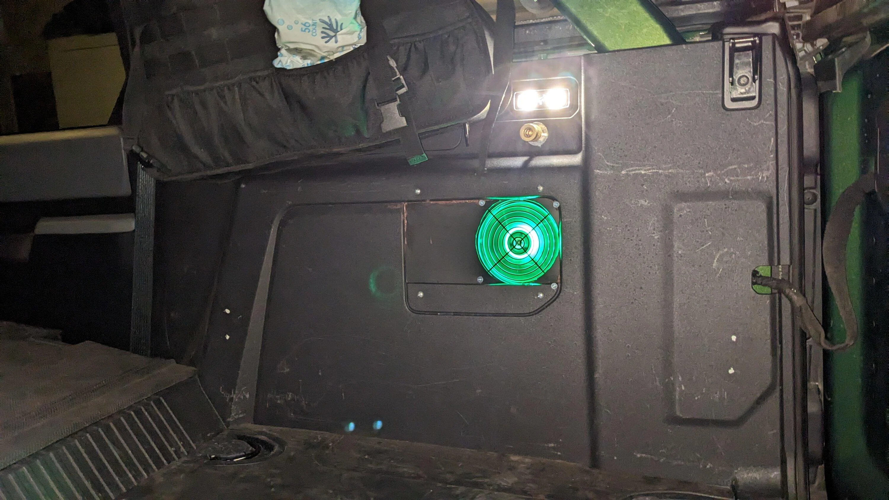

You think the compressor will get enough airflow behind the panel? I thought about installing a computer fan or similar to my panels for when I bolt in all the inverters and chargers and whatnot just to keep air moving in there.
Like this? Mine is green! I am hoping the cool air goes in and I insolated the fender to keep the temp down. I am actually thinking about a water separator as the moisture is now a bit much. The 1/0 was a massive improvement in performance I was killing 100amp fuses if I filled 3 tires in a row.

Yeah pretty much exactly like that LOL
You have it on a separate circuit or only when the air is turned on? I have one aux switch left and I'm saving it to trigger onboard electronics (inverter/radios/etc), figured if I was powering that stuff I might as well have the fan kick on at the same time.
How many amps is that compressor rated for? I think my twin ARB is in the neighborhood of 65-70A
It's wire into the rear aux switch with the compressor. Like a check engine light if the compressor blows another fuse.

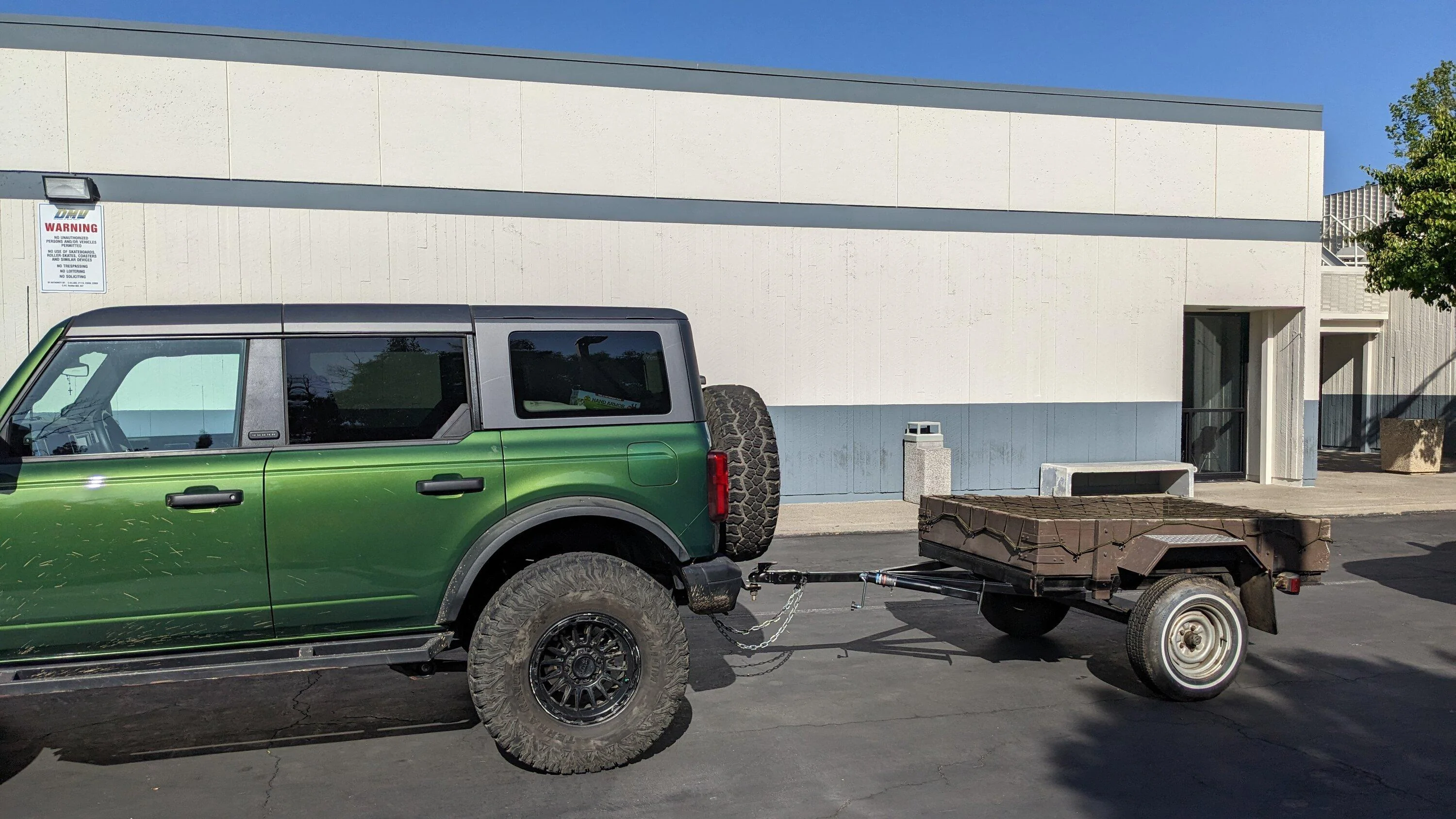

Getting legal! Next stop is the tire shop, going to stay with a set of cheap small trailer tires for now. Hope to find a bigger axle down the road and add some bronco lug pattern wheels.

Nice. Will you go with same size tire so essentially you’d have 2 spare tires? Also when you do a new axle will you do a solid or independent?
I’ve been tossing around the idea of an indie “axle” while my stock rims sit here waiting for me to build an “overland” trailer. Can’t wait to get back to MI to start many projects this fall. I miss all my fab tools and barn. Been 2 yrs since I set foot in it. Glad I can follow this thread to get a fix on my fab jonesing. My next purchase is a mandrel bender. Might have a good lead on a scotchman/ironworker/piranha or whatever else you wanna call them. You know a combo press, shear, punch, brake and nibbler

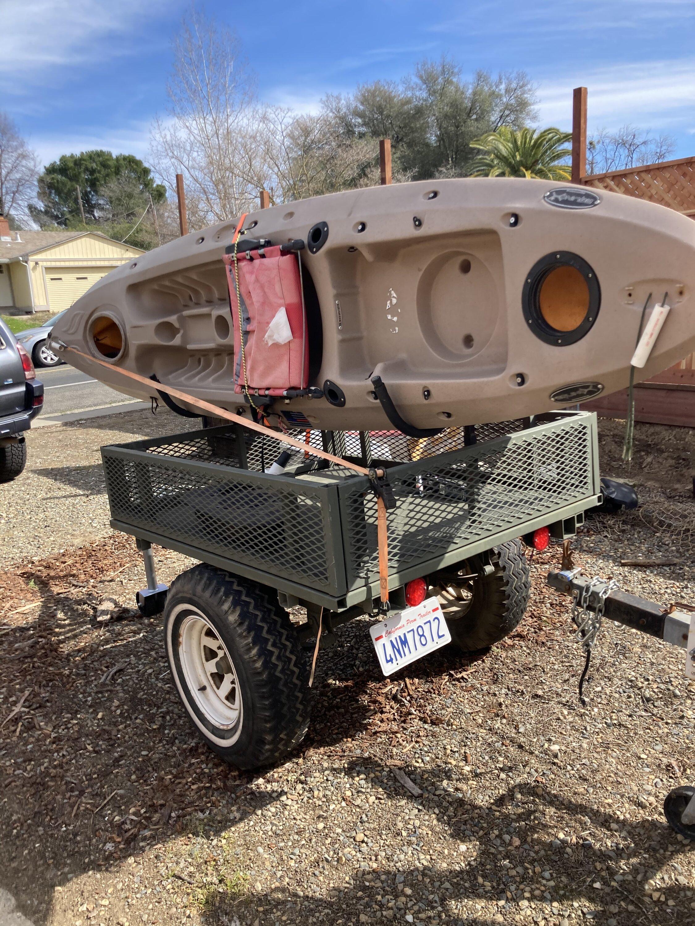

Love the trailer. I’m waiting to start finishing mine soon too. Maybe in a few months.
Between my two Jeeps and Bronco I have too much projects.
It’s an old military trailer on 33’s. The sides are modular and slide out and then slide in flat making a much larger flat bed. Also has provision for the kayaks. I wanna adda rack that slides in as well for an RTT one day
Everyone wanted to much money for a real offroad trailer. Yours looks way lighter than mine.

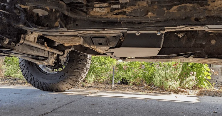

I also picked up an RCI Transfer Case Skid, going to give it a good work over before I say yes or no. I wanted flat, simple and rear mounting point this time. The rear support is bolt on, I will give a couple of whacks before I decide if I should just weld it on. Also may weld an extension plate if I decide I need more coverage extending towards the rear. Also I am not going to try protecting the bolts, I ground down the conical washer hex bolts to the point that I needed to hammer a torq bit in to remove them. I figure regular bolts may be easier to remove with an extractor or just weld a nut on.

I gave up on complex design and went for stupid and simple approach. Really a steel framed set up with uhmw would be my first choice, you could very easily make something better than most of the current offering.
It's wheeling season here, so it's an off the shelf item. My new transmission skid just got delivered, going to mock that up tomorrow and see if I like it. I bought some 3/4" x 1" steel tubing to build a frame behind the skid to help it survive. I did get the skid for free with my BroncBuster pyramid scheme points, so this is a pretty budget option for me.

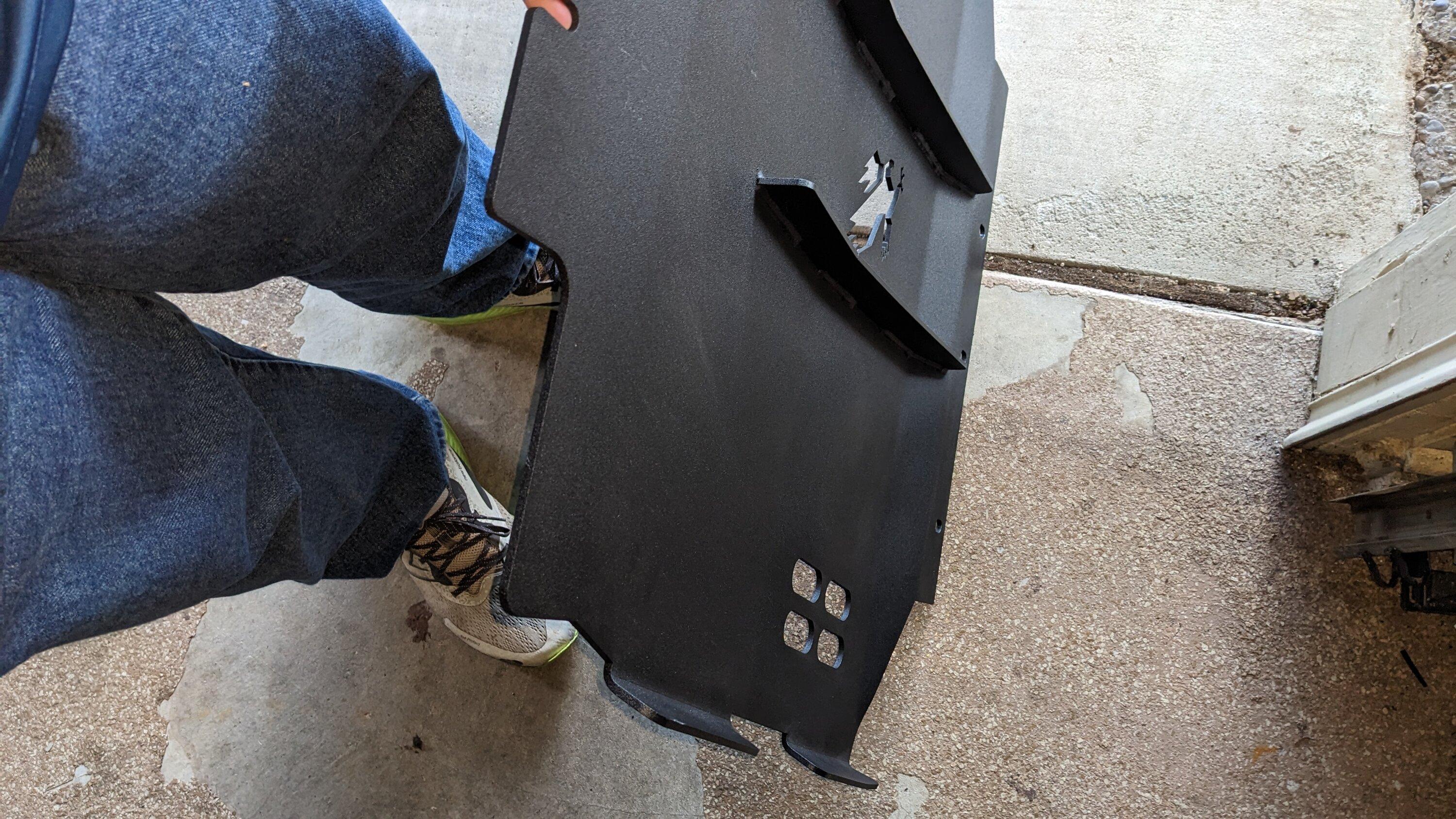

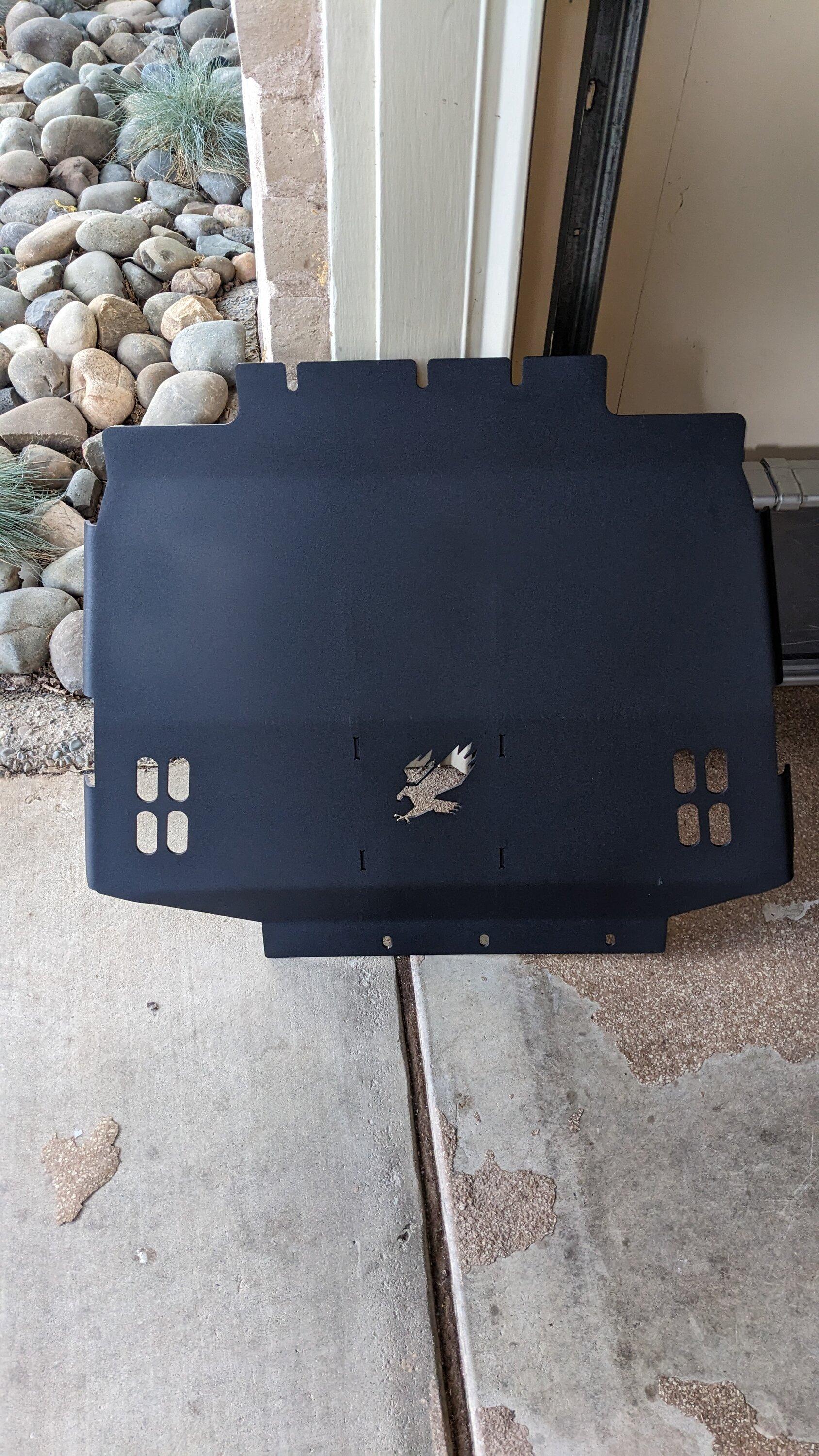

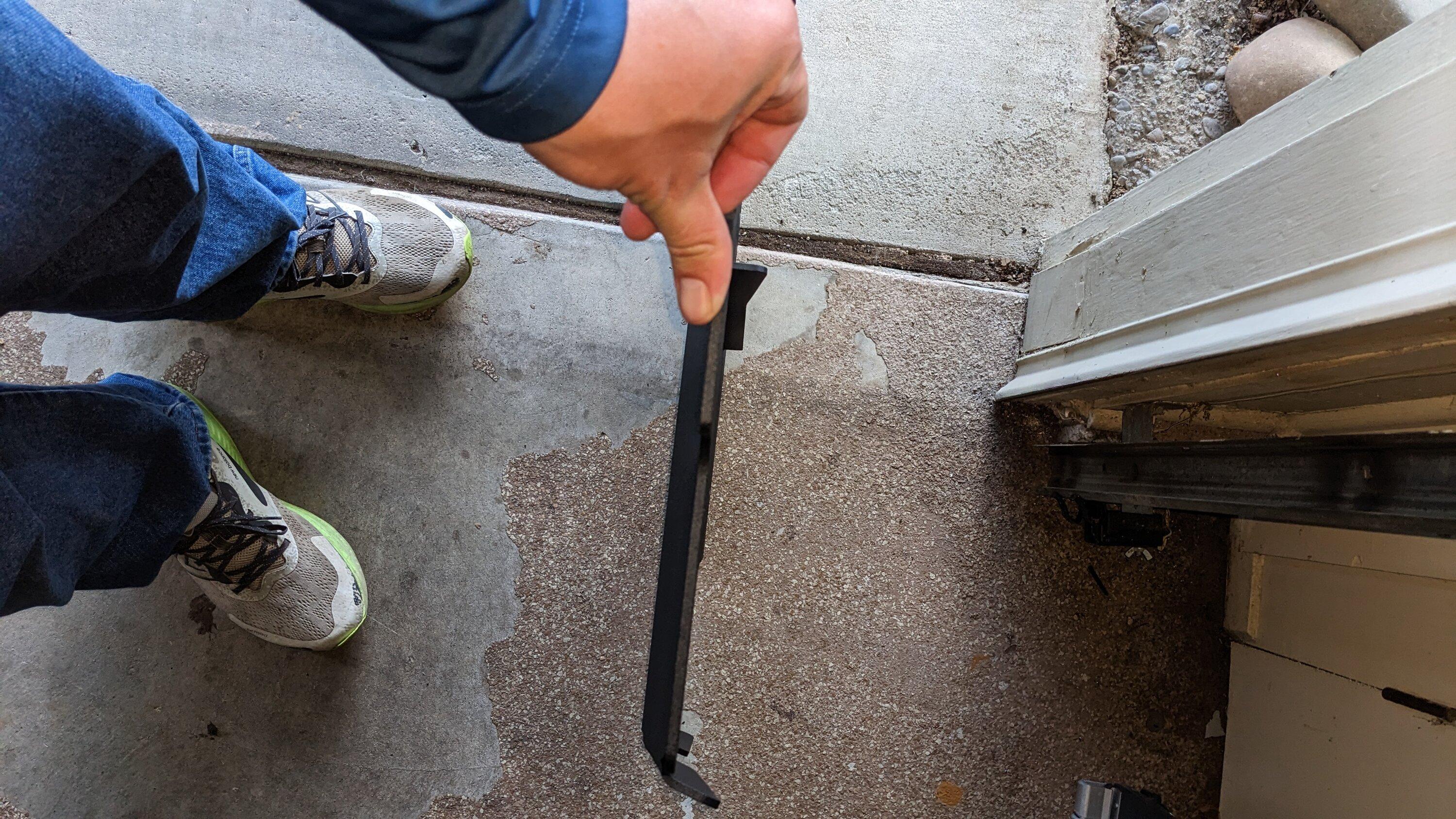

Initial pictures, pretty impressed with this thing. Much lower profile than I anticipated.
They sent me the wholesale invoice, I don't think that is fair to post.
