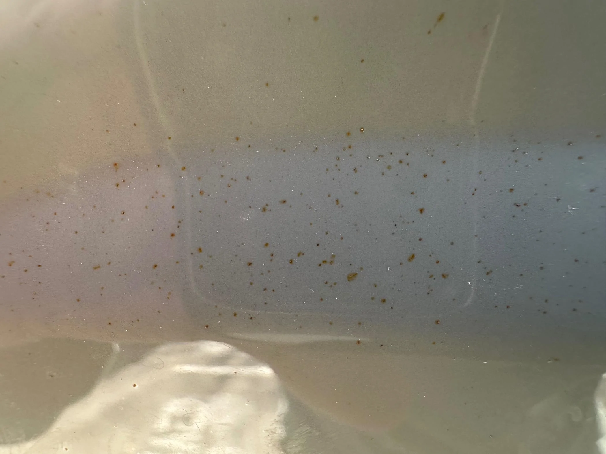

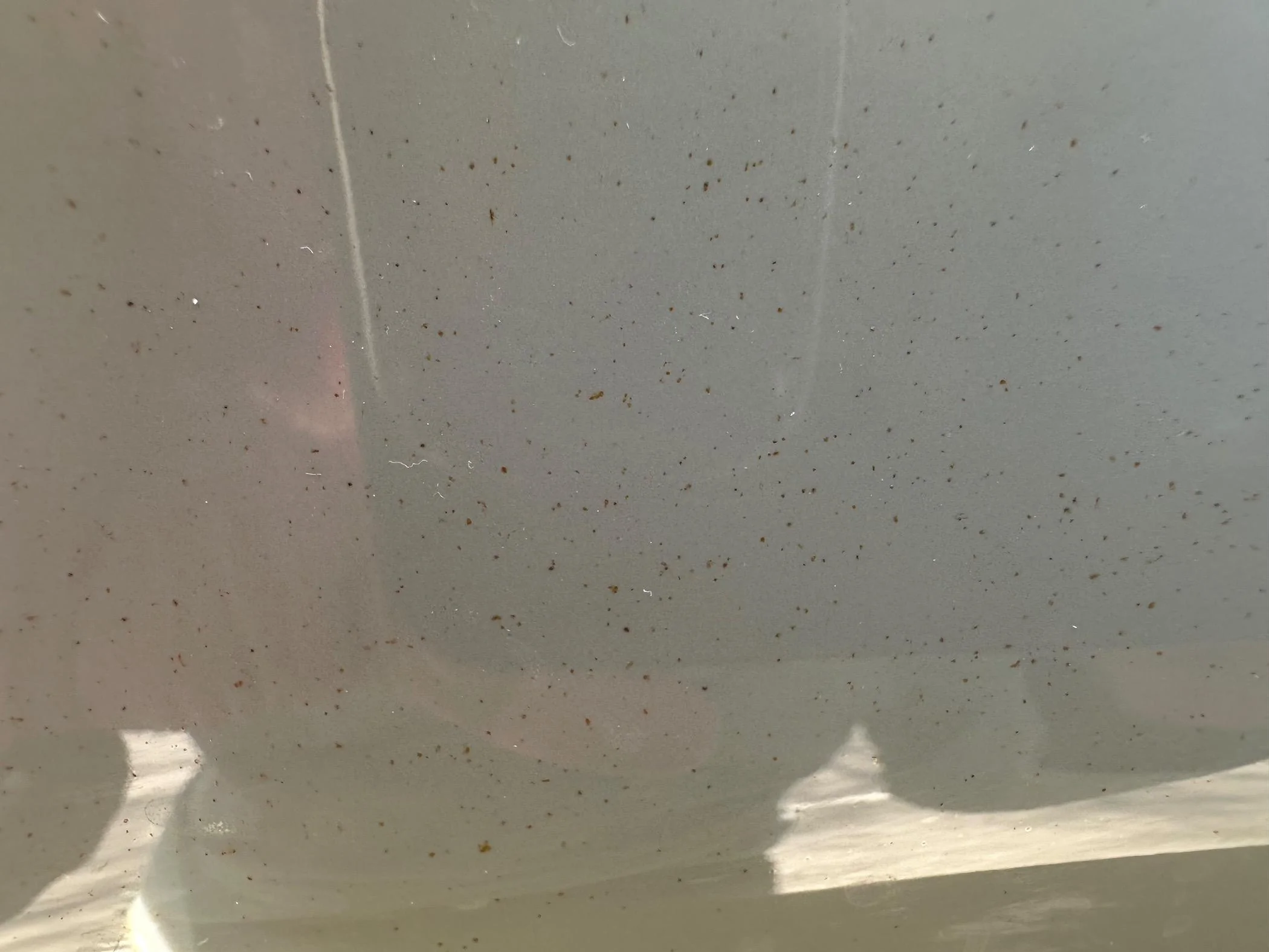

Yeah I still don’t understand why it was denied under warranty
Prob because the Dealers are supposed to Detail the cars before they sell them. That rail dust might have come off with a simple polish when it was delivered... Hard to trust the dealer network of any brand anymore.

Thoroughly detail it, including clay bar. That should lift the contaminants. Then ceramic coat it.

Like many others have said, rail dust. Just wash, clay bar, and polish.
Per the Ford warranty :" The New Vehicle Limited Warranty does not cover surface rust, deterioration and damage of paint, trim, upholstery, and other appearance items that result from use and/or exposure to the elements. You, as the owner, are responsible for these items." You'd have to prove this is rail dust from their delivery and even then, it's not really anyone's responsibility unless the sale contract said it included a detail.

Rail dust
yup - absolutely what it looks like
not a defect, but needs to get taken care of
On the plus side if you go ceramic your paint will look awesome when finished

This is why you always a do a very thorough new car detail, or take it to a good detailer if you're not equipped to do it yourself.

Spray some iron remover on it, let it soak for a few minutes and then wash your Bronco.. problem solved.

Dealer's responsibility to catch and remediate during PDI. That said, Ford had a lot of trouble with rail dust years ago and even specified a particular brand of wash to help neutralize. It generally boiled down to like others have said. Wash, clay bar, wash again, maybe buff, paint sealer.
Exterior finish or trim damage due to airborne material/environmental fallout (e.g., acid rain, rail dust, or fluid dripping) is not considered a factory defect.
Some types of airborne material/environmental fallout for vehicle prior to 2024MY are considered as an exception and may be reimbursable within 12 months /12,000 miles (please see details for what is and what is not covered below). The warranty claim MUST contain the appropriate Sub-Code, condition code and labor operation, refer to the OWS User Guide for the appropriate claiming procedure. Refer to section 3.5.02.74 PAINT DEFECTS CARS & LIGHT TRUCKS for additional policy details.
