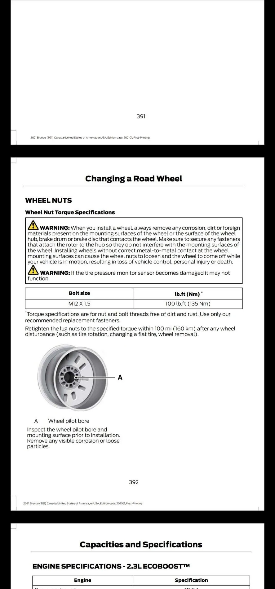

when i get my bronco, i will check the owner's manual... i have been using 85 ft lbs since i have started driving in 1983. i have never had a failure. if the new specs have changed, cool. i have always used a torque wrench set to 85 -90 foot pounds and never had a failure. also never snapped off a stud because it was overtightened with my pneumatic impact...
I believe you, but, the specs have in fact changed over the years. The Ranger is 100 lbs, as is the Bronco. This is a screenshot from the Bronco owners manual.
There you go 100 ft/lbs not 150ft/lbs.
I could live fine with 85ft/lbs but certainly not 150ft/lbs...

Dude, why? That's far under-torqued for most vehicles. Fords, anyway. A Ford ranger is 100 lbs. An F150 is 150lbs. Shoot, my Mustang is 150 +/- 15 lbs as well.
I never said the Bronco was 150, I just said 85 was too low and that some Fords call for 150. The Bronco, like the Ranger it's partially based on, calls for 100.

how many degrees of turn will it take to apply 100 ft lbs of torque over 85? or what is the difference in degrees of turn between 85 and 150? also do you torque with a wet torque or a dry torque. i always lubricate the threads on my lugs before torqueing. this is a forum, there are many things posted on here which are errant. if you don't like advice, don't use it. considering the six lug hub and the clamping force of 6 m12X1.5 studs, i feel confident when received my wheels will remain connected to my vehicle. as they have with four and five lug applications i have owned in my life. i guess we can agree to disagree. i will just remain to do what has done me right and you can use your best judgement.

While the 150 ft-lb is widely specd across Ford trucks to me it seems like way too much. I have never owned an impact wrench that would go above 120 and always felt being in the danger zone at 80-90. Are we sure this 150 number that nobody but a college linebacker will be able to duplicate changing wheels in the wild or even doing your own rotations
It’s called a torque wrench. Always did it to 150 ft-lb on my F-150, since it’s what the manufacturer specs in the owners manual.
But why would you not follow a manufacturer recommend torque spec? You know better than Ford on what the lug nut torque needs to be so it stays on the vehicle at highway speeds?
If manual says 100, I'm torquing to 100. My F-150 says 150, so I go to 150...
Also, what are you lubing your threads with? Seems like a bad idea, I've never applied lube to wheel lug nut threads.
When they say lubricate, it means use something like antiseize. Lubricated threads have a more consistent torque level. Unlubricated threads can have an inconsistent torque level due to friction in the threads themselves. I use antisieze because I have it out anyway because I put some between the aluminum wheel and the steel hub.
Edit - and you're spot on. Torque to the level specified by the manufacturer. Silly not to.
