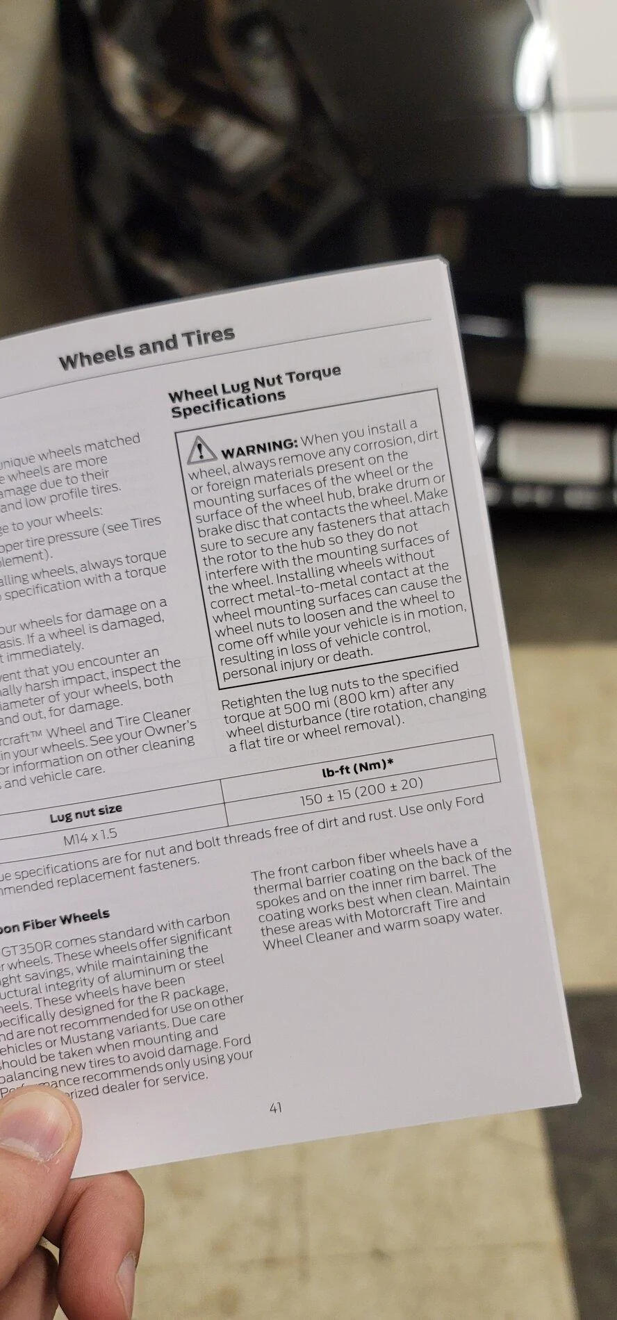

i generally use 85 pound feet of torque for wheel lugs. if you have a locking lug you may want to leave it a little looser, maybe 50#ft.
Dude, why? That's far under-torqued for most vehicles. Fords, anyway. A Ford ranger is 100 lbs. An F150 is 150lbs. Shoot, my Mustang is 150 +/- 15 lbs as well.

Dude, why? That's far under-torqued for most vehicles. A Ford ranger is 100 lbs. An F150 is 150lbs. Shoot, my Mustang is 150 +/- 15 lbs as well.
check your numbers... if you are torqueing that high you are going to be experiencing hardware failure these are wheel lugs not torque to yield bolts. anything with aluminum wheels will experience damage at the 150 range.

No, the 350 doesn't have carbon wheels. The spec applies to both. The regular Mustang is also 150 lbs, without the added +/- 15lbs note. I have the manual for that as well.

when i get my bronco, i will check the owner's manual... i have been using 85 ft lbs since i have started driving in 1983. i have never had a failure. if the new specs have changed, cool. i have always used a torque wrench set to 85 -90 foot pounds and never had a failure. also never snapped off a stud because it was overtightened with my pneumatic impact...
That sounds crazy. My Boss calls for 100 ft/lbs..

While the 150 ft-lb is widely specd across Ford trucks to me it seems like way too much. I have never owned an impact wrench that would go above 120 and always felt being in the danger zone at 80-90. Are we sure this 150 number that nobody but a college linebacker will be able to duplicate changing wheels in the wild or even doing your own rotations
