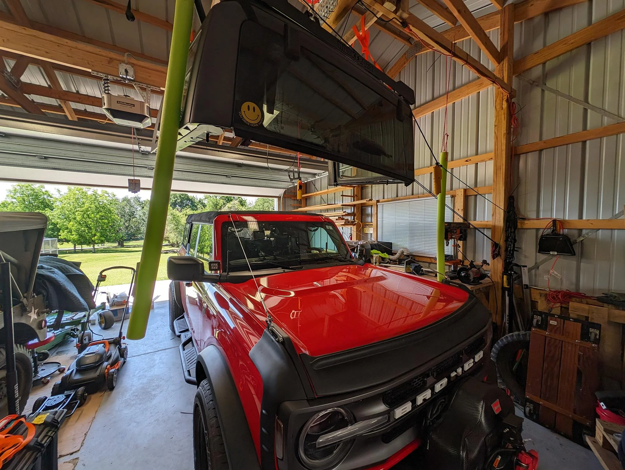

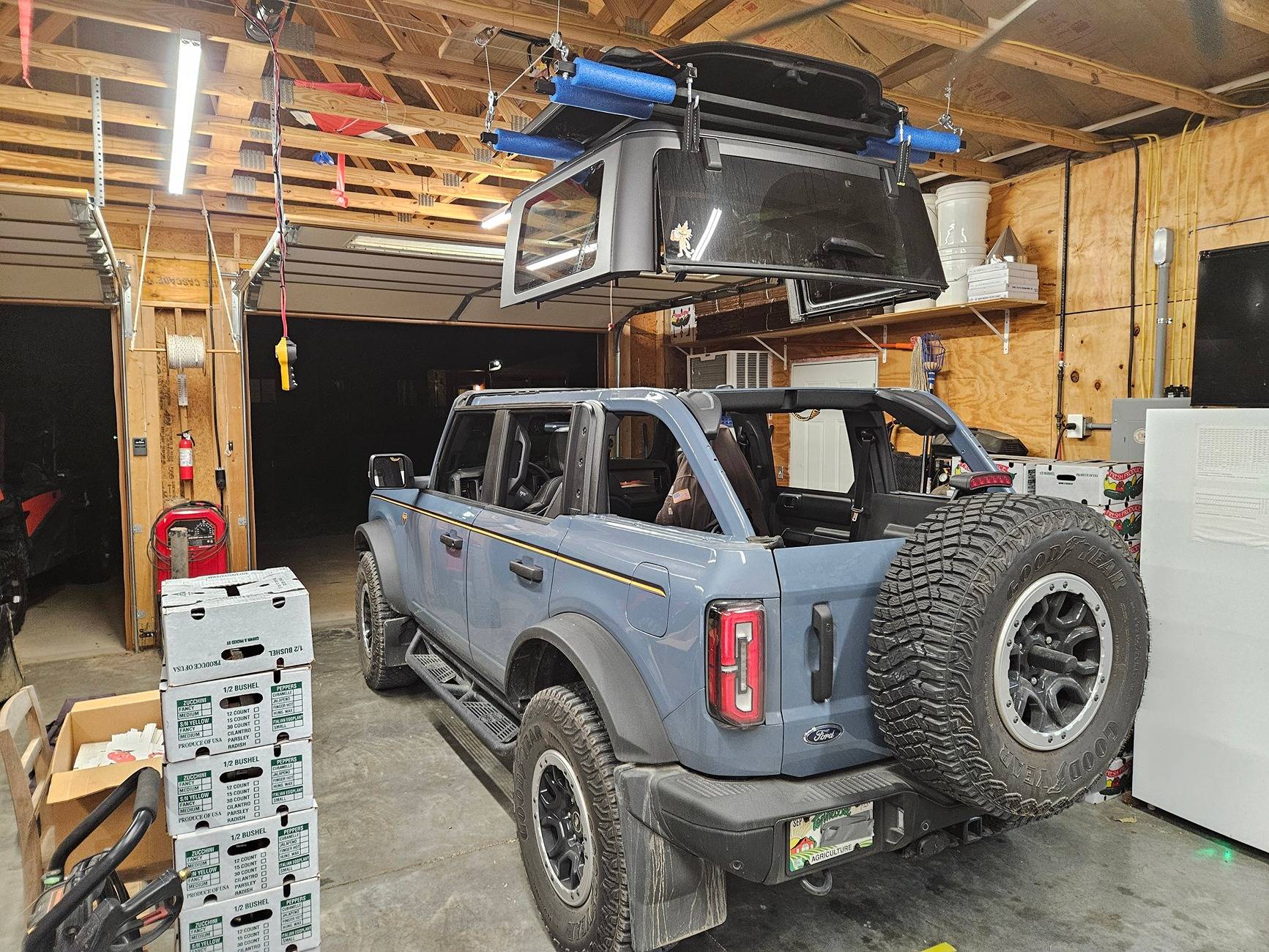

I have a 23 BB 4 door. Mine came with the dual top option. Hardtop installed and awkard and heavy softtop stuffed in the back with the rear seats folded down. Which was funny because one of my grandsons when with us to "look" at Broncos. Traded in my 2020 Colorado ZR2 Bison diesel. Had the sales people remove the soft top so I could transport my grandson home. LOL. Then drove up on the following Tuesday to fetch the top. Watching FOUR guys put this in my Bronco was interesting. Getting it out by myself was even more entertaining.

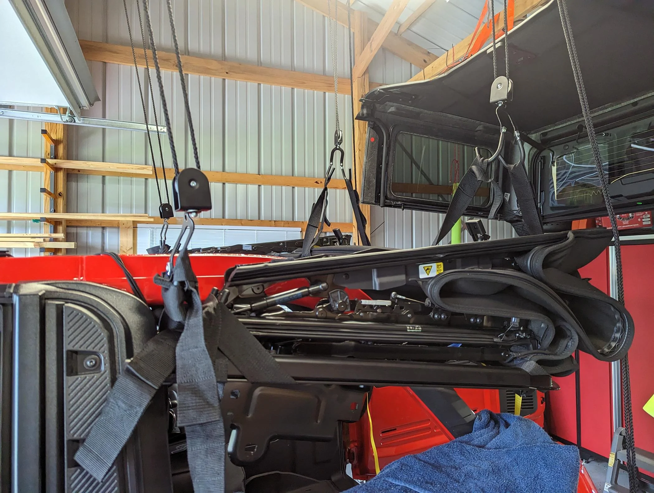

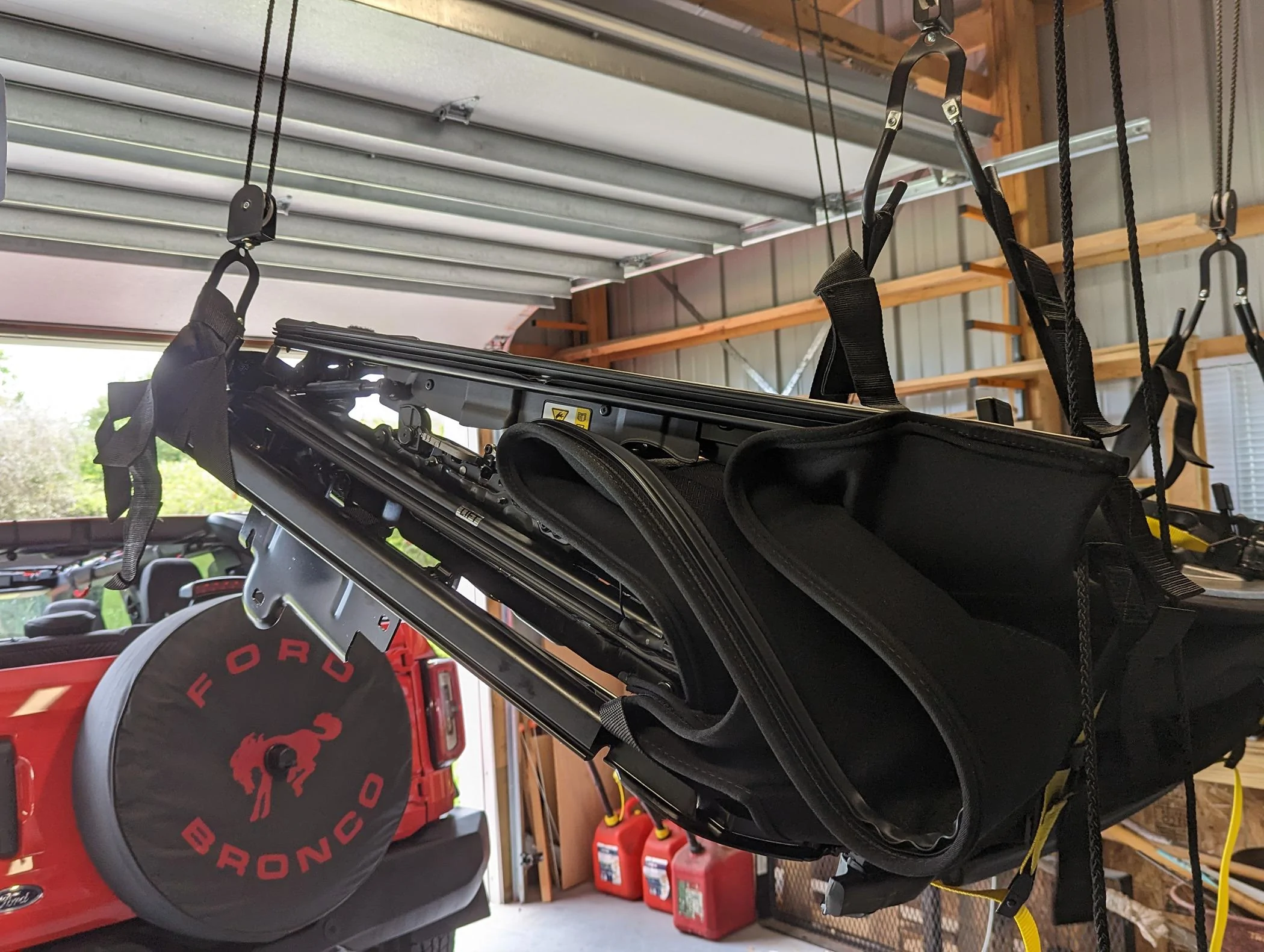

But to the main question. I had to figure out how to get the hard top off by myself. I went with the J-Bar system coupled with a small electric winch from Harbor Freight The J-Bar includes a stout metal bar with clips and then straps designed for the removal of the Bronco top. It is pricey. Mounted the winch in my barn/garage. And this made it very easy to remove the top. Next up was the soft top. There was no way my wife and I were going to be able to pick this up over our heads. So I called a buddy and he came over after work and we lifted it into place. But that sucked. So I bough two kayak hand winches and that worked but it wasn't smooth. So I bought another Harbor Freight winch and installed it. This allows me to remove and install the soft top. I use the kayak slings to wrap the folded down top. Not satisfied with the single winch hook, I'm going to try steel gambrel to spread out the loop attachment points. Once I remove the soft top, I lower it onto a it's original shipping platform that I place on top of a cart so I can move it around my barn as needed.

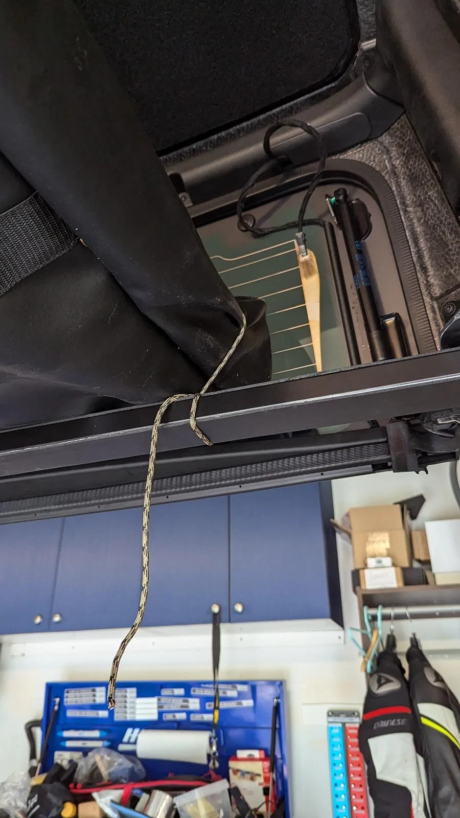

I've included a few pictures that show my hard top hanging around. I use extra straps to keep it from spinning around and maybe add a bit of safety (from falling). Also, pictures of my kayak slings in use to remove/install the soft top. Guess I was so excited that my 2nd winch worked so well out removing/stalling the soft top, I for got to take pictures. But from now on it is a one man show to switch tops.

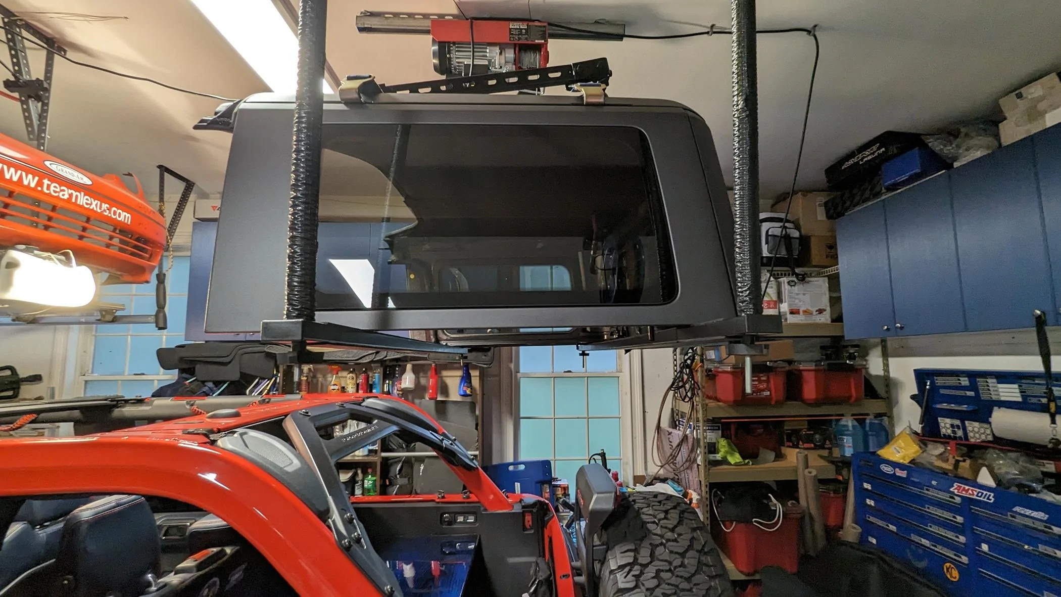

I got the Harbor Freight winch and straps to make this lift...it's pretty cheap and easy to install and you can see it has a control for operation. I'm 69 and this takes 10 minutes to hook up the straps and stays in the ceiling...just a thought
Don’t know why but when I saw the pic of your garage I instantly thought “that looks like a StL neighborhood” and then saw the license plate and your signature, sure enough! I’m in Manchester. Not many 2 doors, probably seen you around.

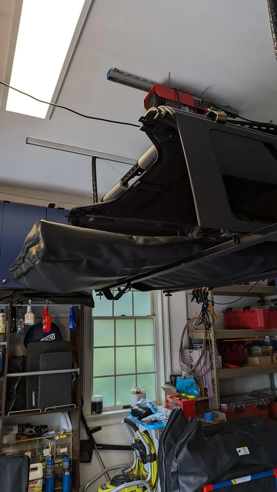

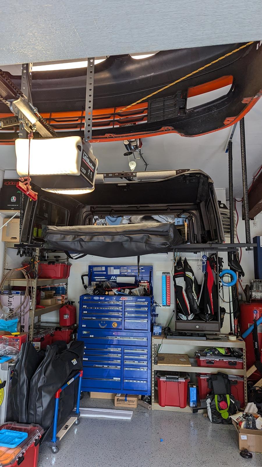

Front 2 panels easy, mid-panel at 5'9" trying to walk it off towards the back is super clumsy given the girth of the Raptor flares, so I just take it off solo to the side and that seems to work ok. The clamshell - I built a hoist and floating shelf system in my garage. The floating shelf can also support the mid panel to get it out of the way from dangers of everyday garage life - moving stuff, finding tools etc. I could probably add another set of threaded rod and shelf support towards the front, but the panel passes the midway point and I use some paracord to just tie a safety on the end so it can't tip forward.

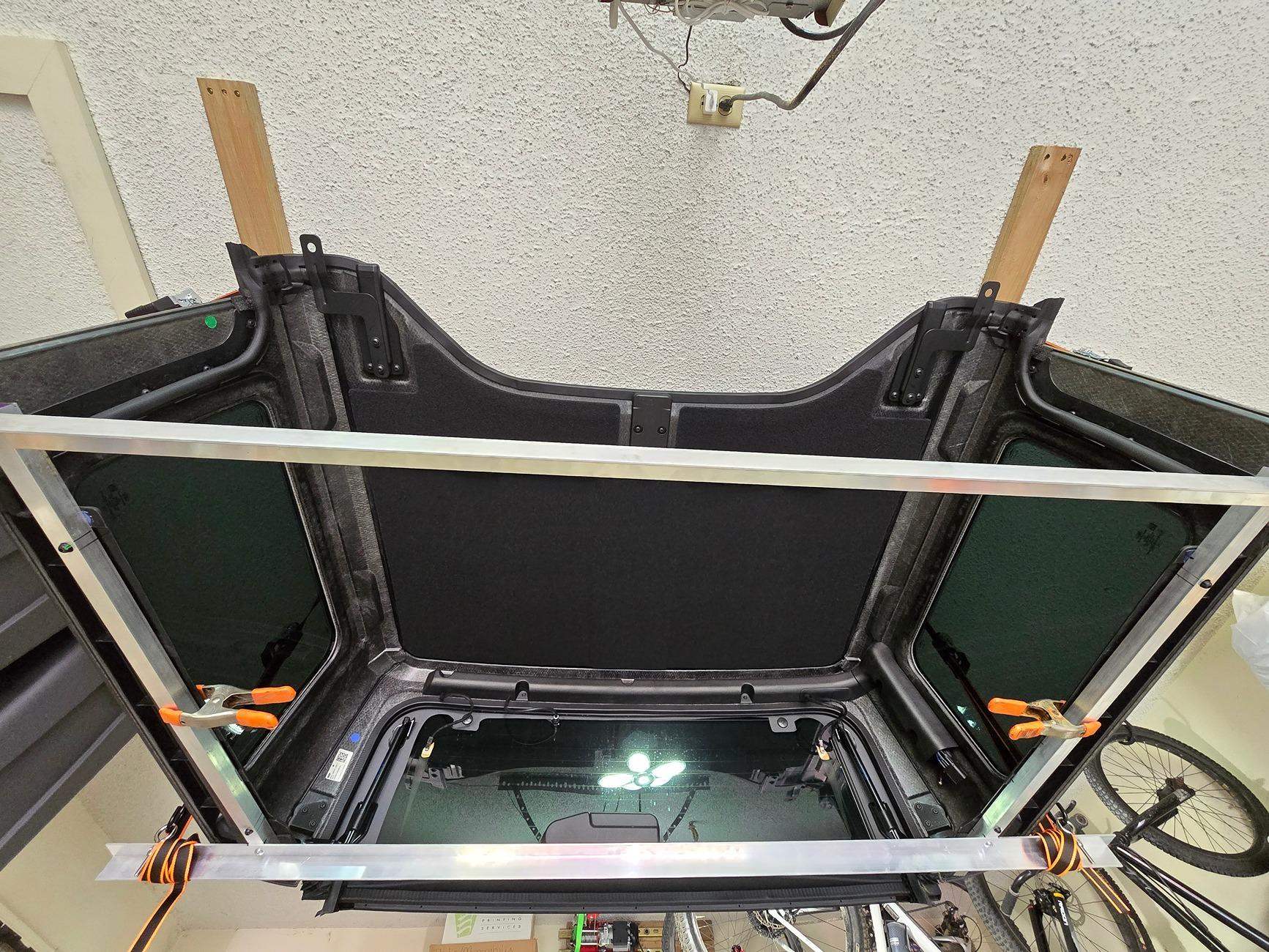

I did something similar. I wanted to have the weight of the top rest in its normal mounting surface so built an aluminum frame that the guide pins index into. I put the middle section on top of the rear cap and can put the two front panels inside if I need to.
