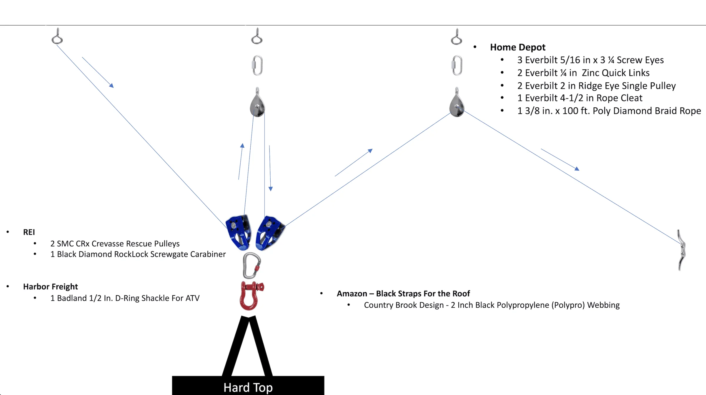

I put together a cheap and easy pulley system to remove my Bronco hardtop in my garage with and wanted to share how I put it together in case anyone else is looking for a solution. In total, the parts cost $104 but if you have some of these parts already it could cost you much less - the REI parts were expensive but you might be able to find cheaper. It is very easy to setup and I have been using it to remove and put back on the hardtop every weekend.
I'm sure folks can make improvements to this idea so feel free to share your ideas.

Parts List
- Home Depot - $38.07
- Amazon - $13.97
- Harbor Freight - $5.99
- REI - $46.85
I put together a quick 2 minute YouTube video which helps demonstrate:
