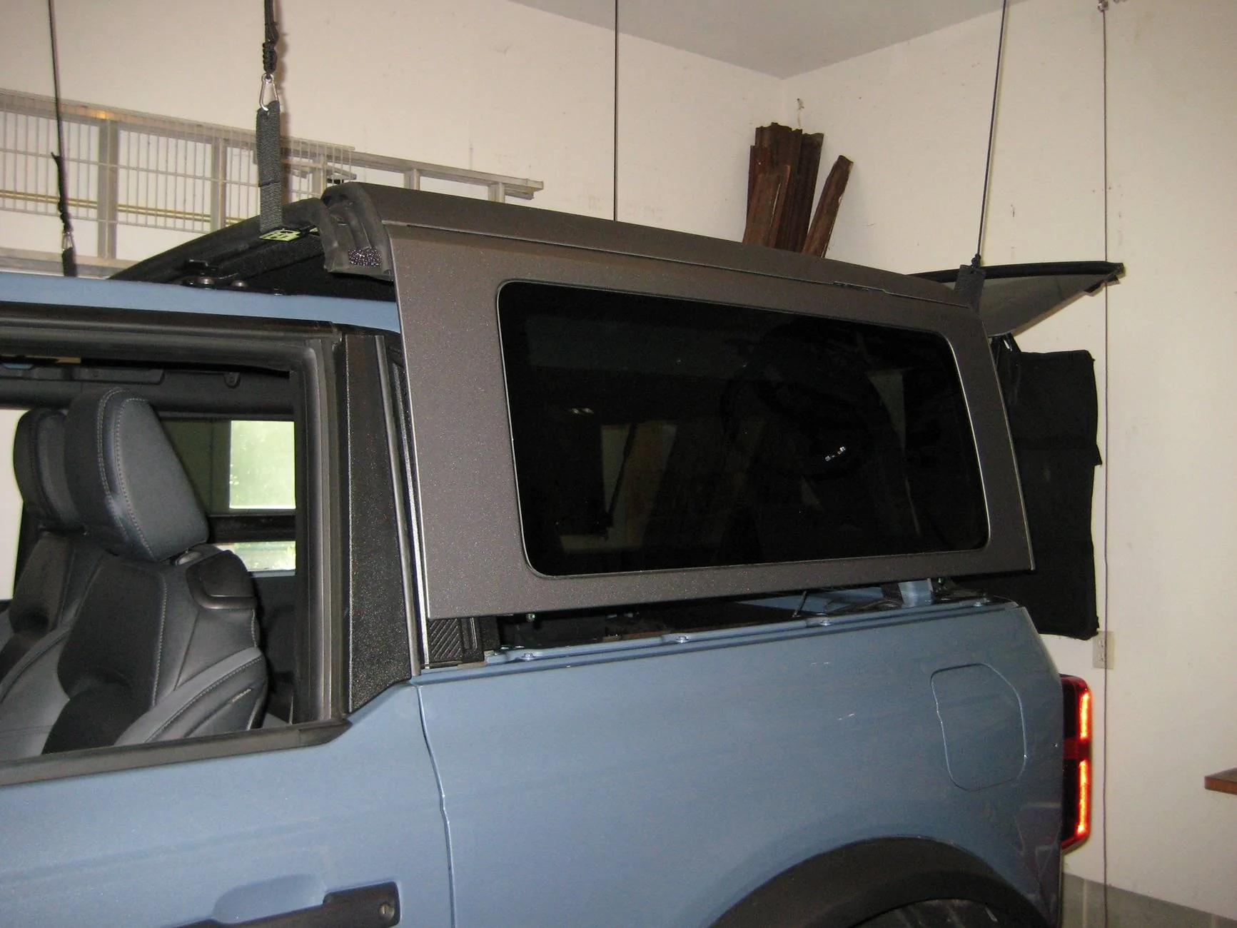

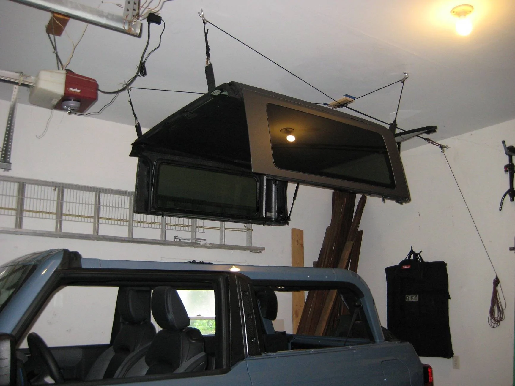

I bought one of those block and tackle lifting systems off of Amazon.com
https://www.amazon.com/dp/B0DCY6FS4F?ref=ppx_yo2ov_dt_b_fed_asin_title

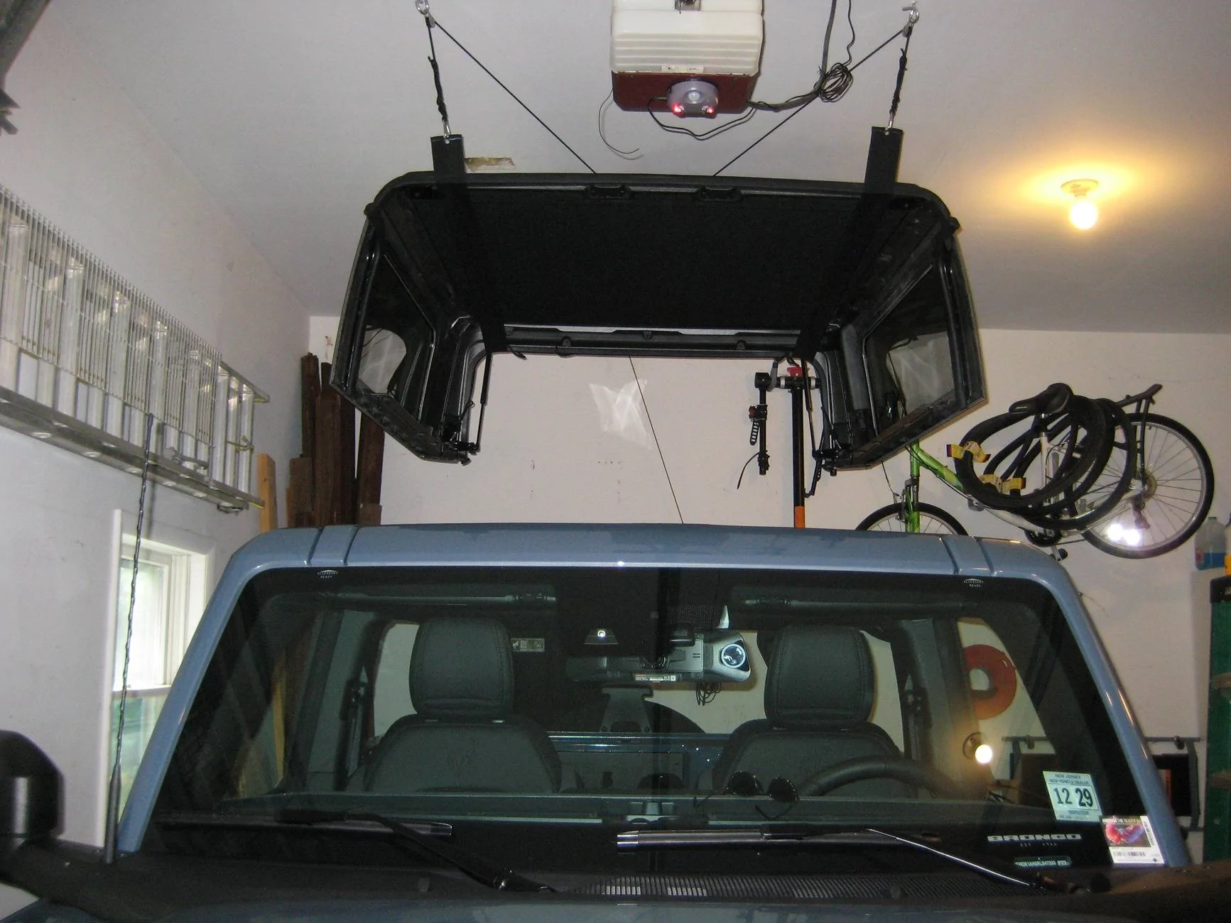

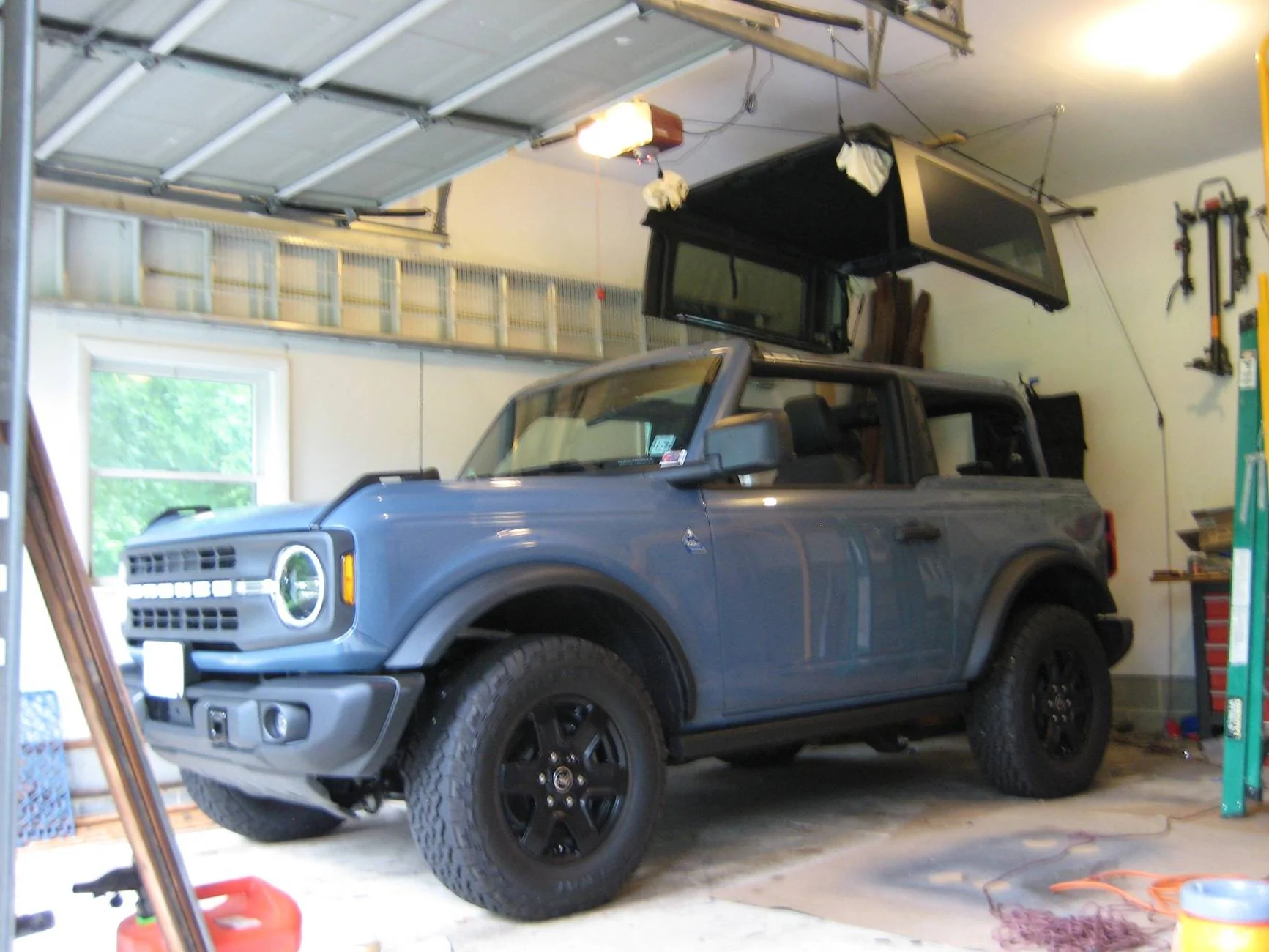

but along with the wimpy straps, they did not seem to be able to compensate for the fact that most of the weight of the hardtop is in the rear. Thus the back of it sagged and made it pretty awkward putting the hardtop back on.
Ford Bronco Share Your Hard Top Removal Tips and Tricks IMG_3374

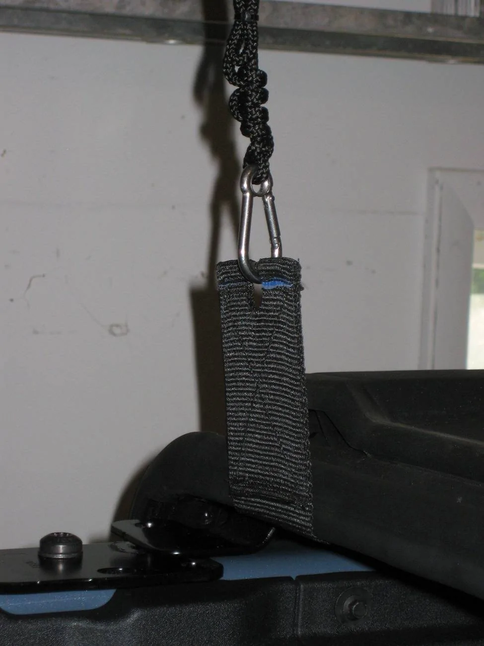

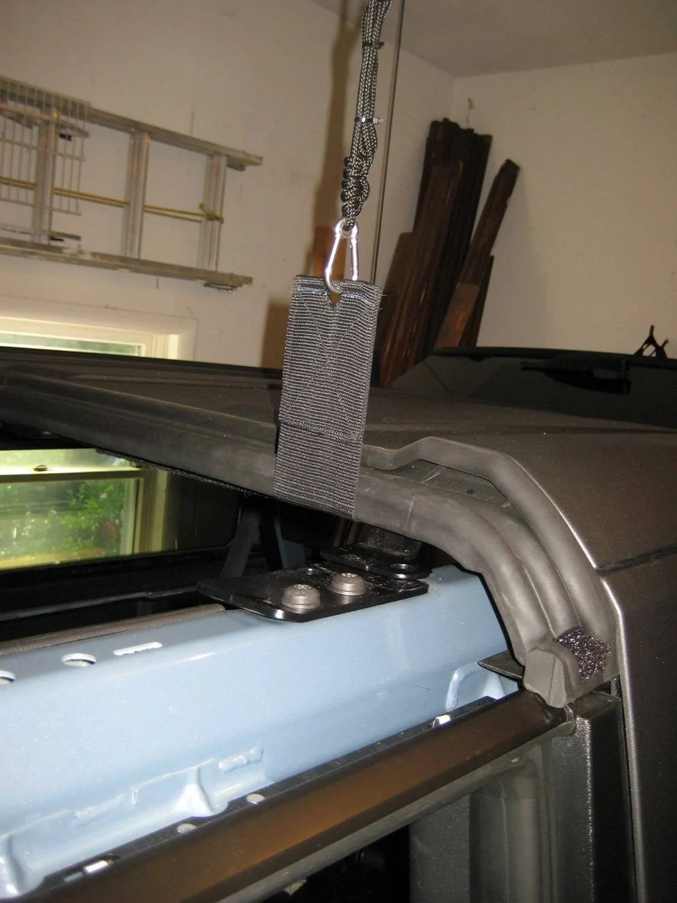

So I decided to make my own straps
https://www.amazon.com/dp/B0CSDJYQZP?ref=ppx_yo2ov_dt_b_fed_asin_title&th=1
https://www.amazon.com/dp/B08CNCJ63B?ref=ppx_yo2ov_dt_b_fed_asin_title&th=1

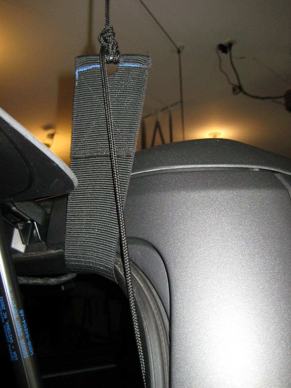

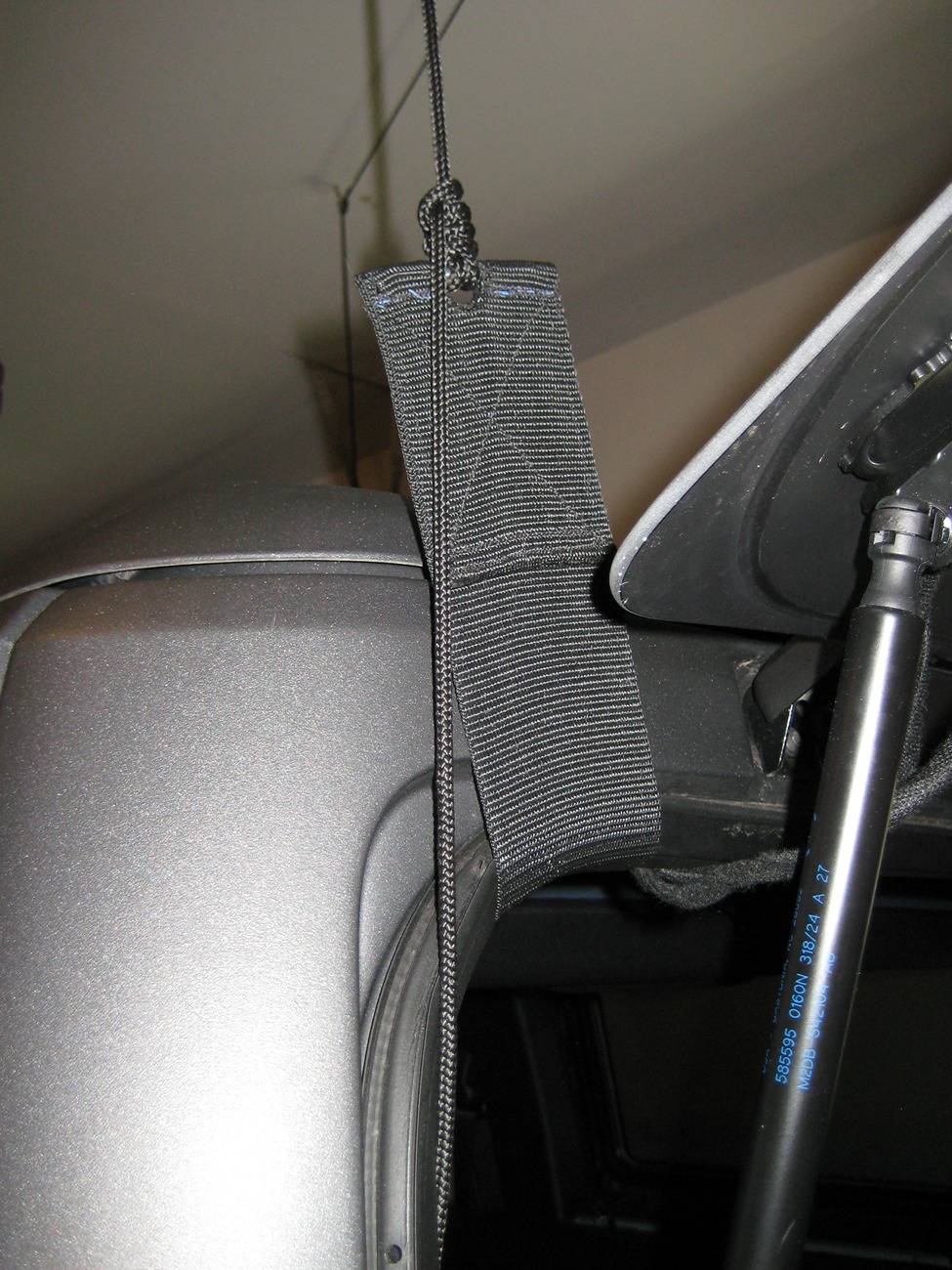

Sewn into the straps are 3/16" metal pins to distribute the weight for lifting. The 3" wide straps help distribute the weight where it makes contact with the hardtop.
Ford Bronco Share Your Hard Top Removal Tips and Tricks IMG_3387
Ford Bronco Share Your Hard Top Removal Tips and Tricks IMG_3385

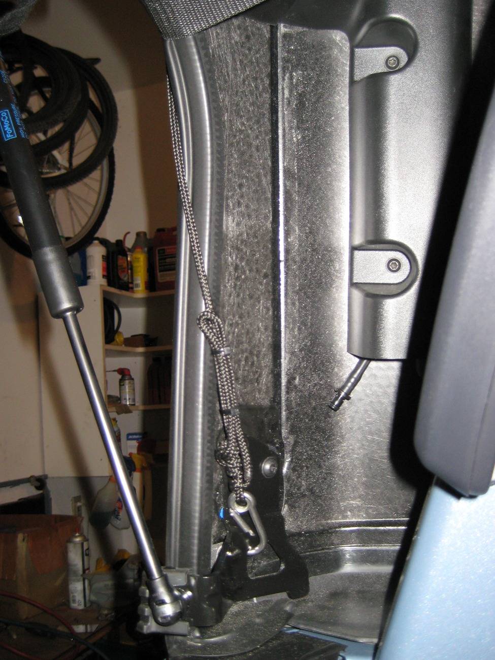

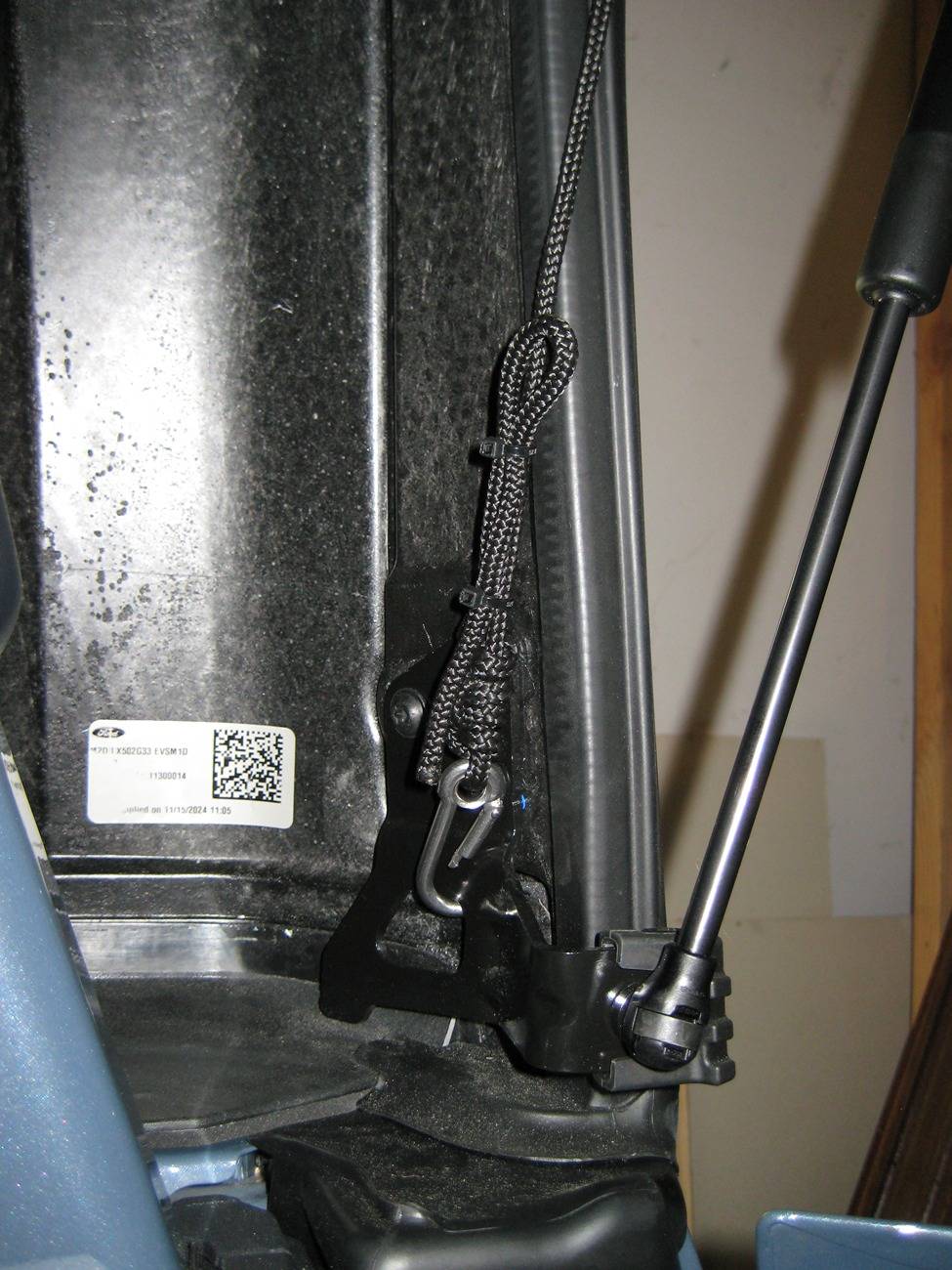

To keep the rear from sagging I extended the rear lifting lines and hooked them to the rear glass opener brackets.
Now it works great and I don't have to worry about one of the buckles on the old straps popping open.

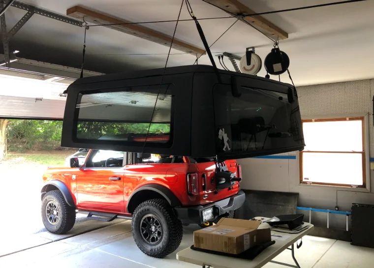

Good advice! It was a bit more than my 60-year-old back wanted..... I could lift it up ok, but definitely felt awkward to try to move it off.
SOooo, luckily I already had a Harkin Hoist in my garage from my RTT days, so I just reworked the straps a little, and used that. Save my back for another day... 😅
Ford Bronco Share Your Hard Top Removal Tips and Tricks Screenshot 2025-08-22 1.22.40 PM
