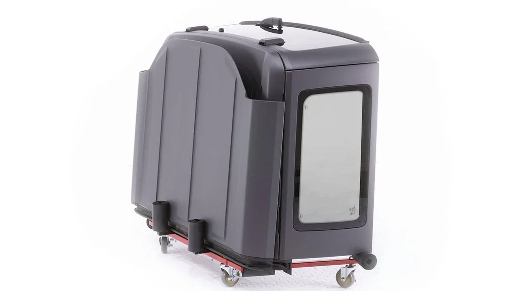

This is more for storage after you get the top off.
Lange makes a cart that I think you can squeeze through the door so if you don't have a garage you can will it into the place (assuming you don't live on a second or higher floor lol)
https://langeoriginals.com/products/ford-bronco-total-top-cart

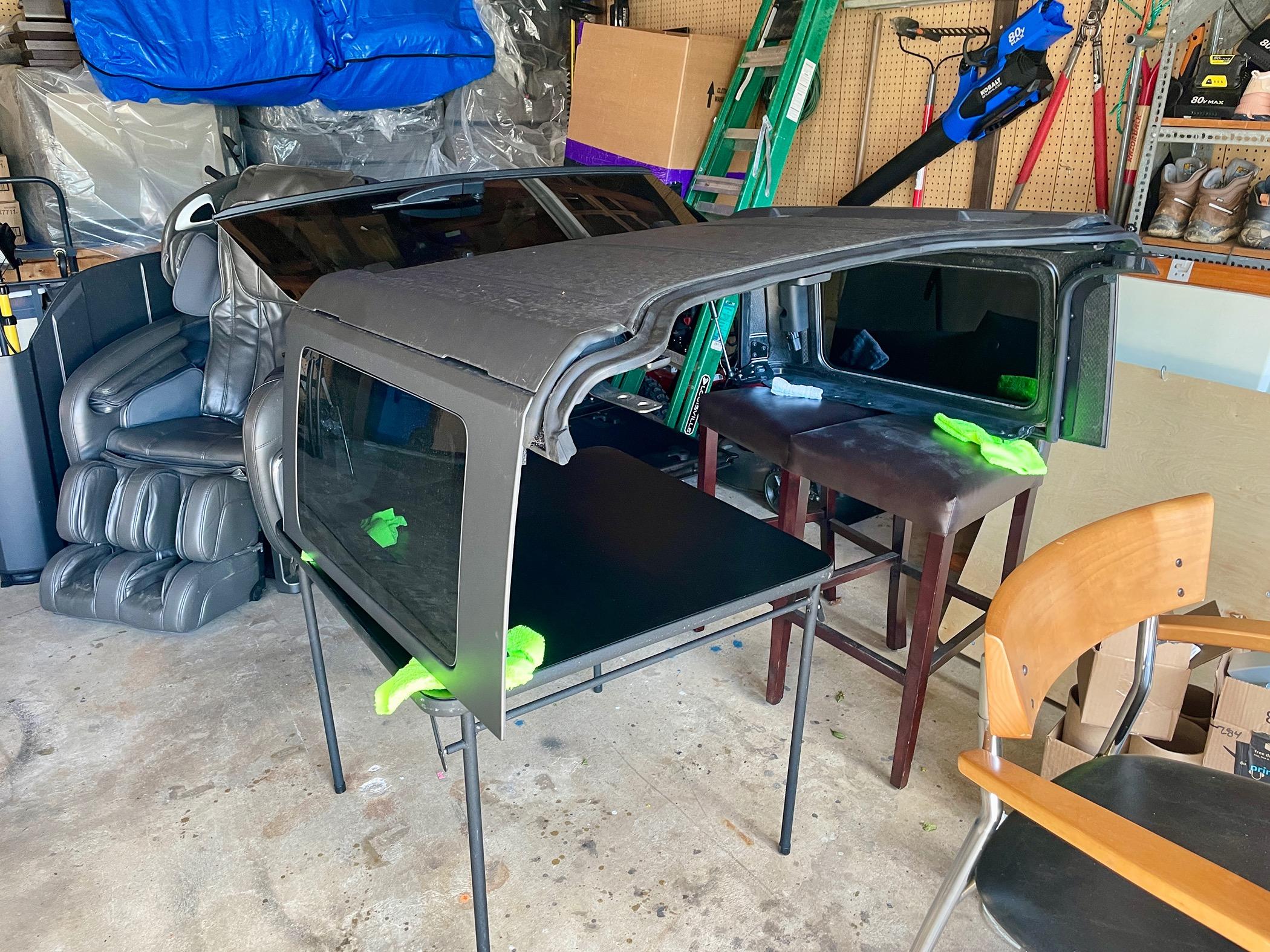

I feel ya for real. Especially because I remove & attach all 4 of the hardtop pieces by myself. The struggle is definitely real. I put the back part on a card table: :eek:

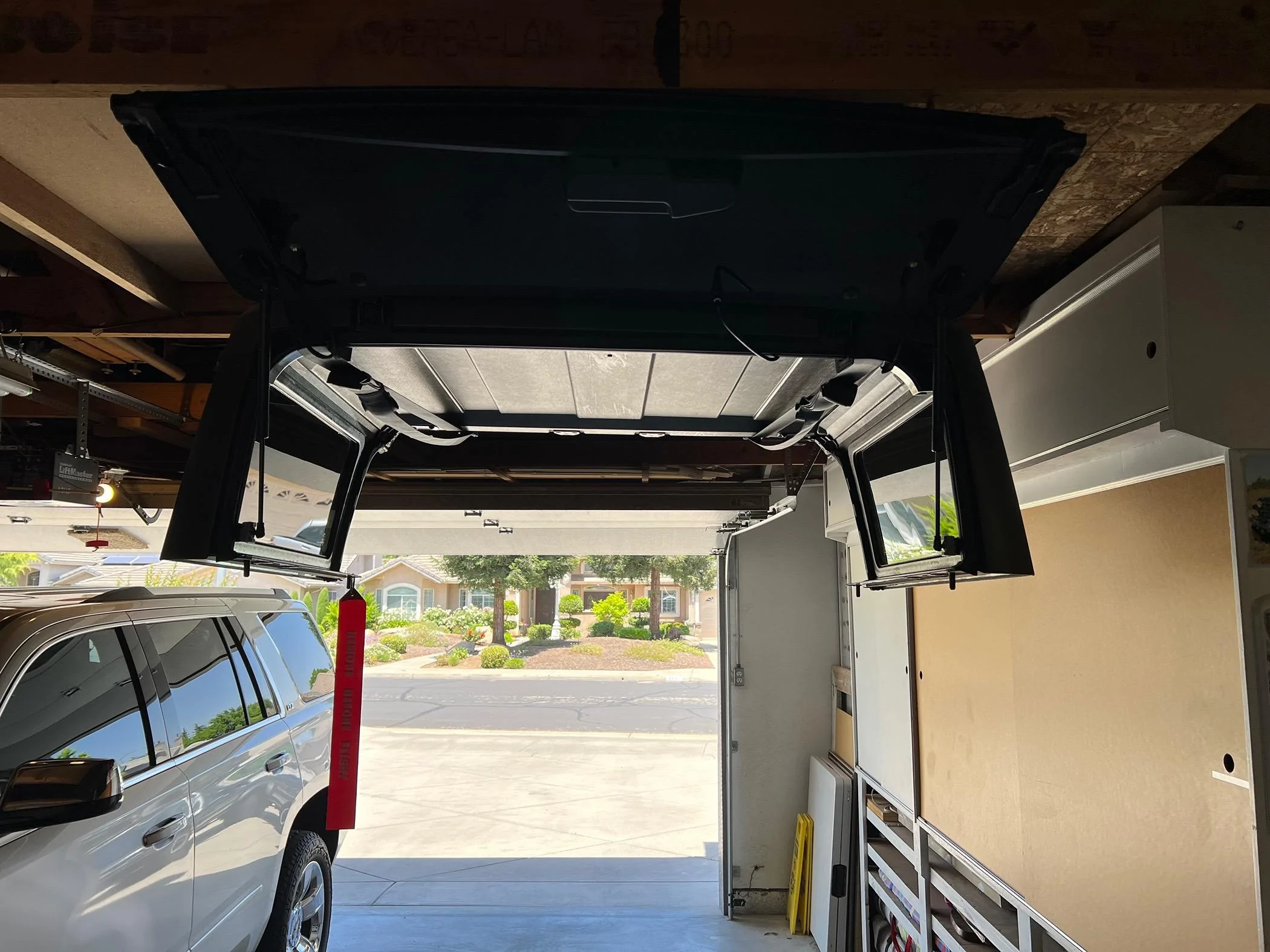

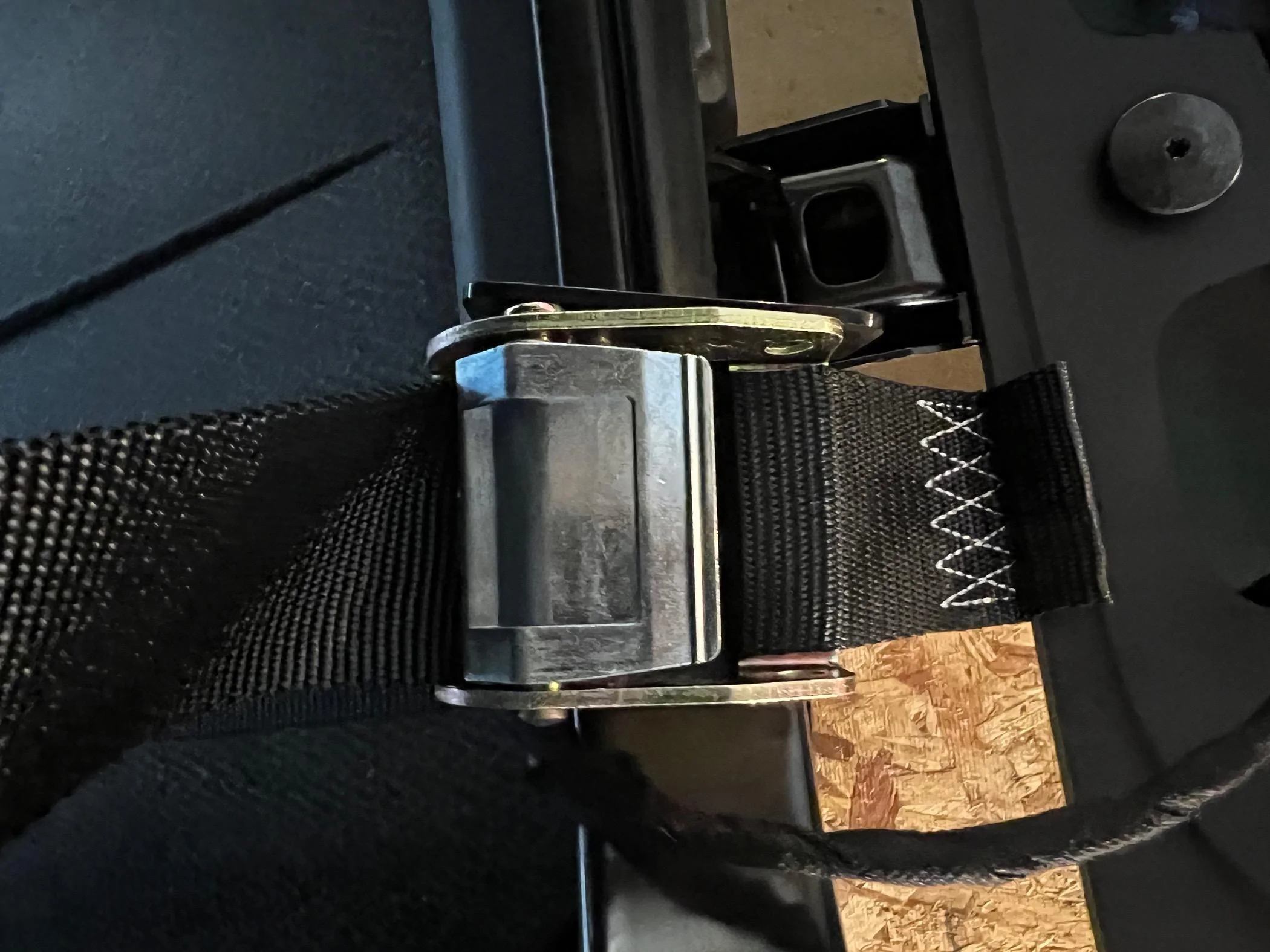

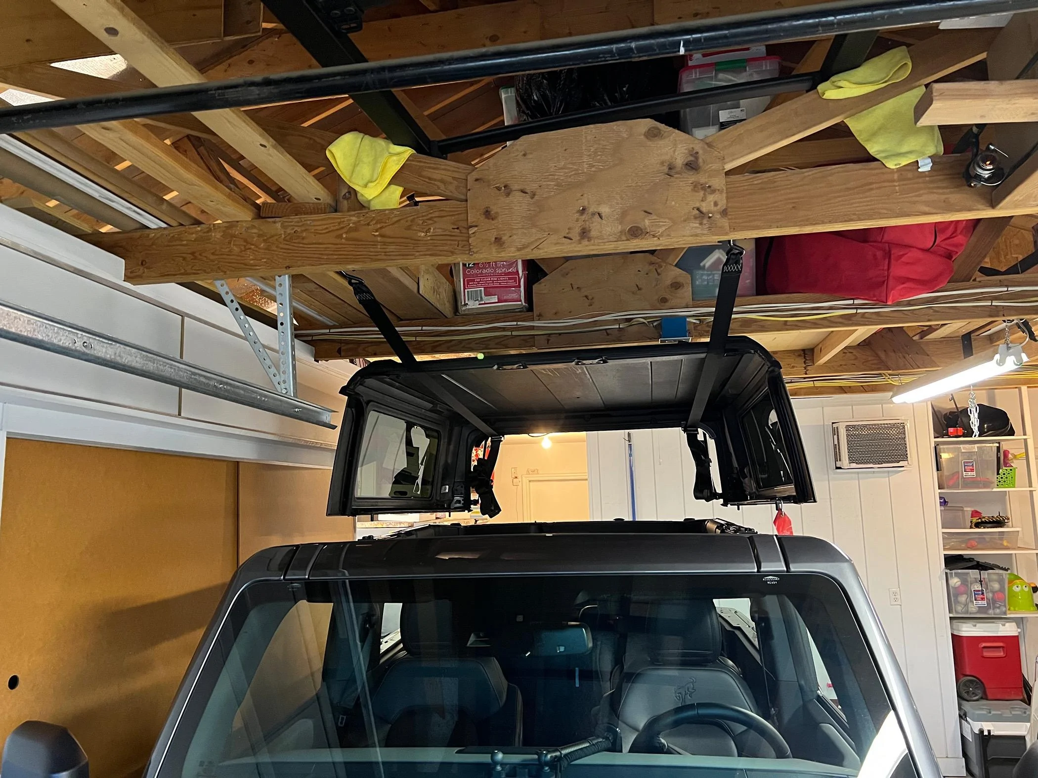

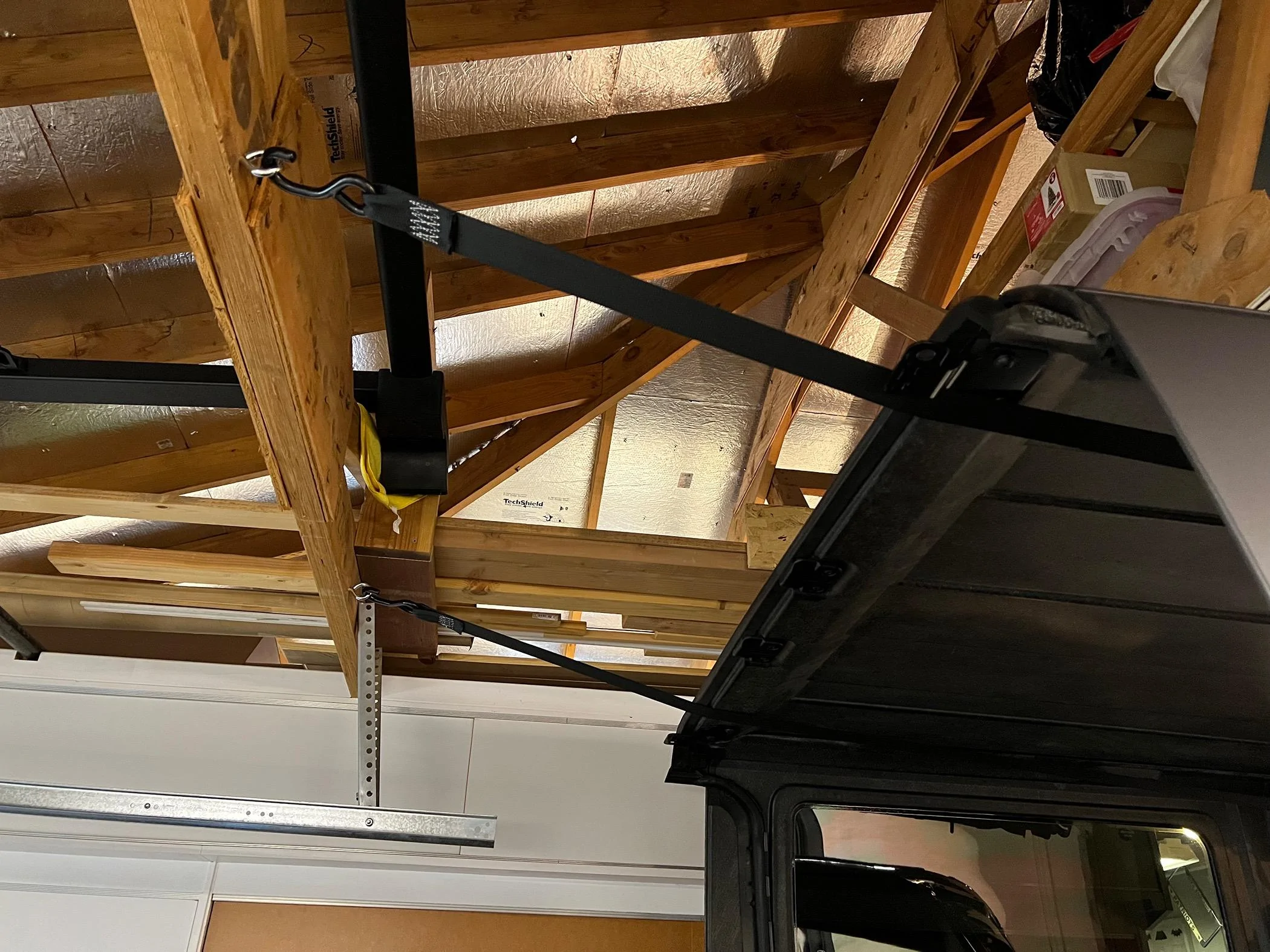

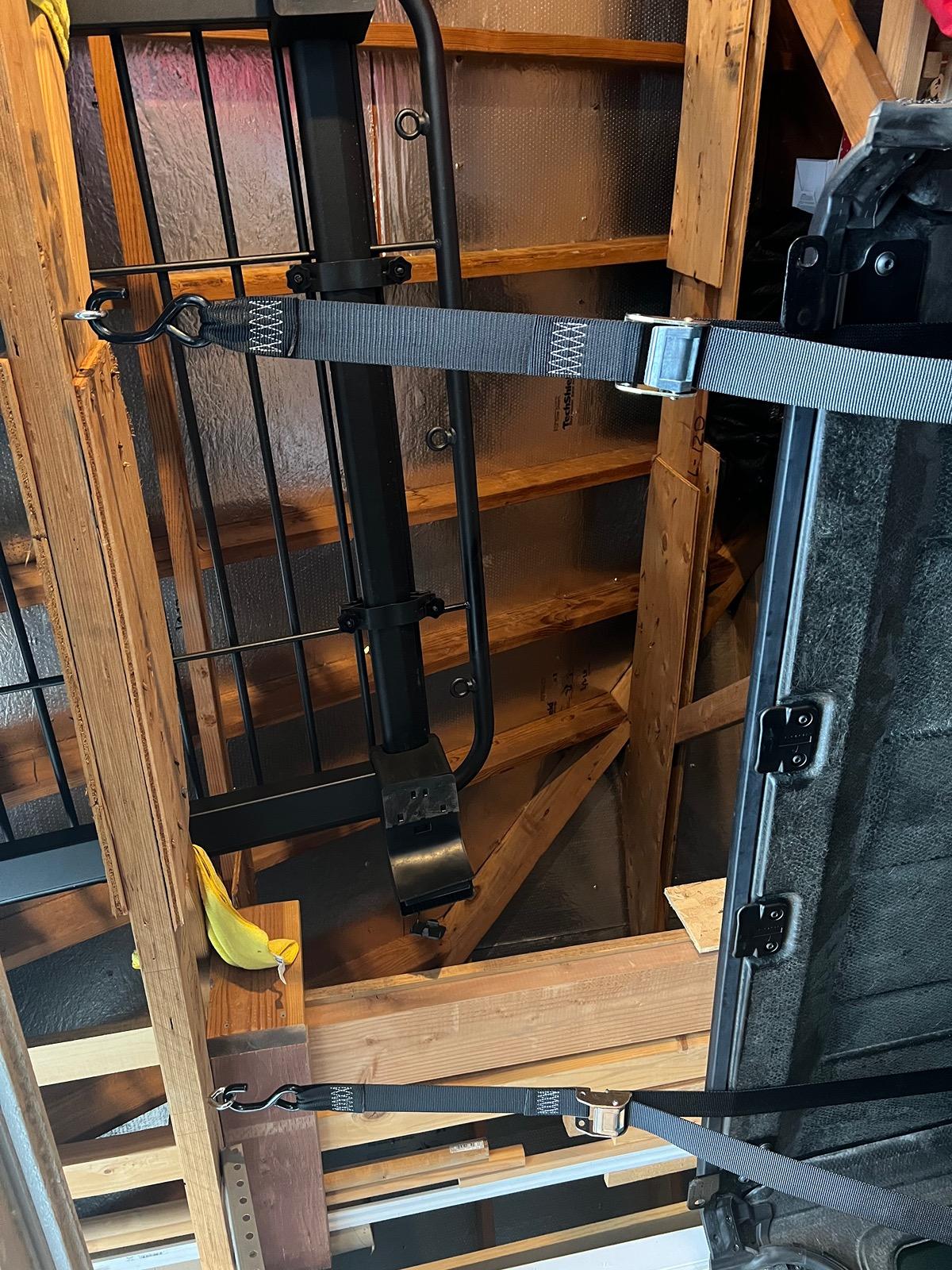

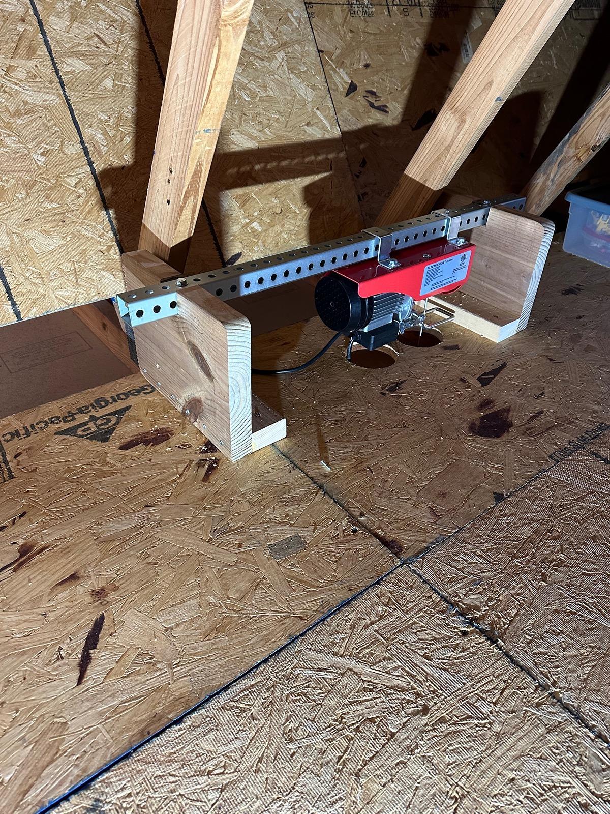

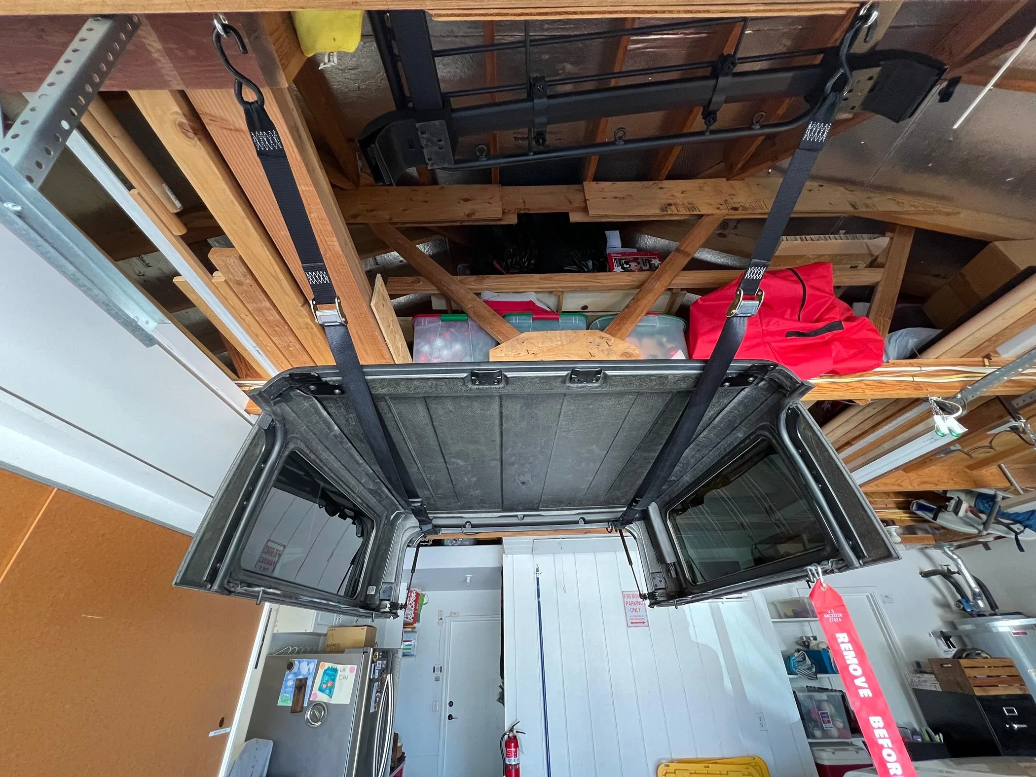

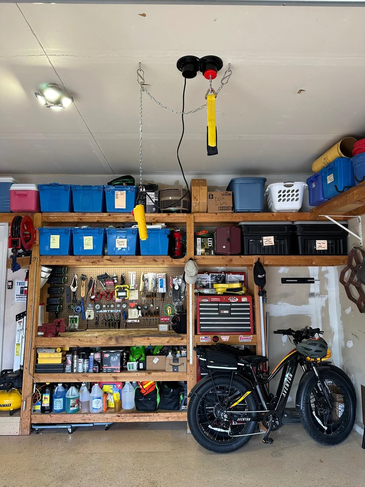

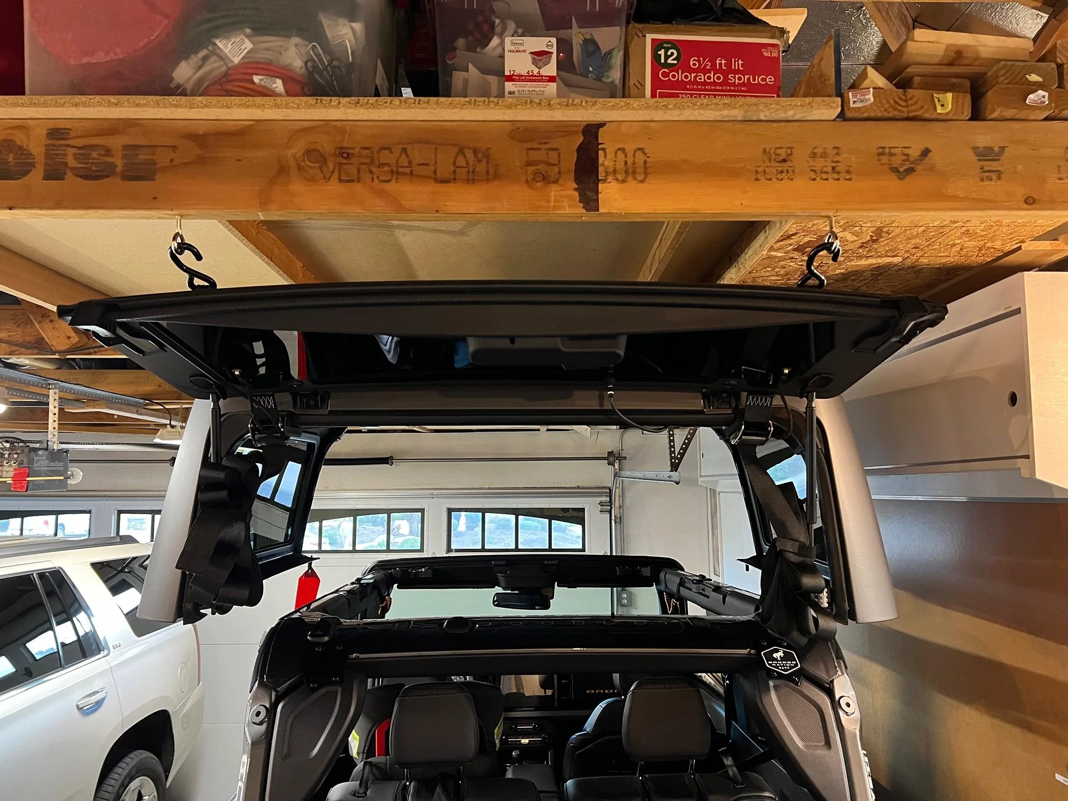

I got the Harbor Freight winch and straps to make this lift...it's pretty cheap and easy to install and you can see it has a control for operation. I'm 69 and this takes 10 minutes to hook up the straps and stays in the ceiling...just a thought
Ford Bronco Share Your Hard Top Removal Tips and Tricks IMG_2668
Ford Bronco Share Your Hard Top Removal Tips and Tricks IMG_2670
Ford Bronco Share Your Hard Top Removal Tips and Tricks IMG_2669
Nov 4, 2022
St Paul
Land Rover
I have a 2 door heritage edition (Sasquatch) so the rear section is quite high and heavy. My son is six feet tall and about 180 lbs and I‘m six feet tall and about 200 lbs. It is heavy and awkward for us to lift off but doable. My wife is about 5’ 8” and extremely fit but I wouldn’t ask her to lift it off with me.

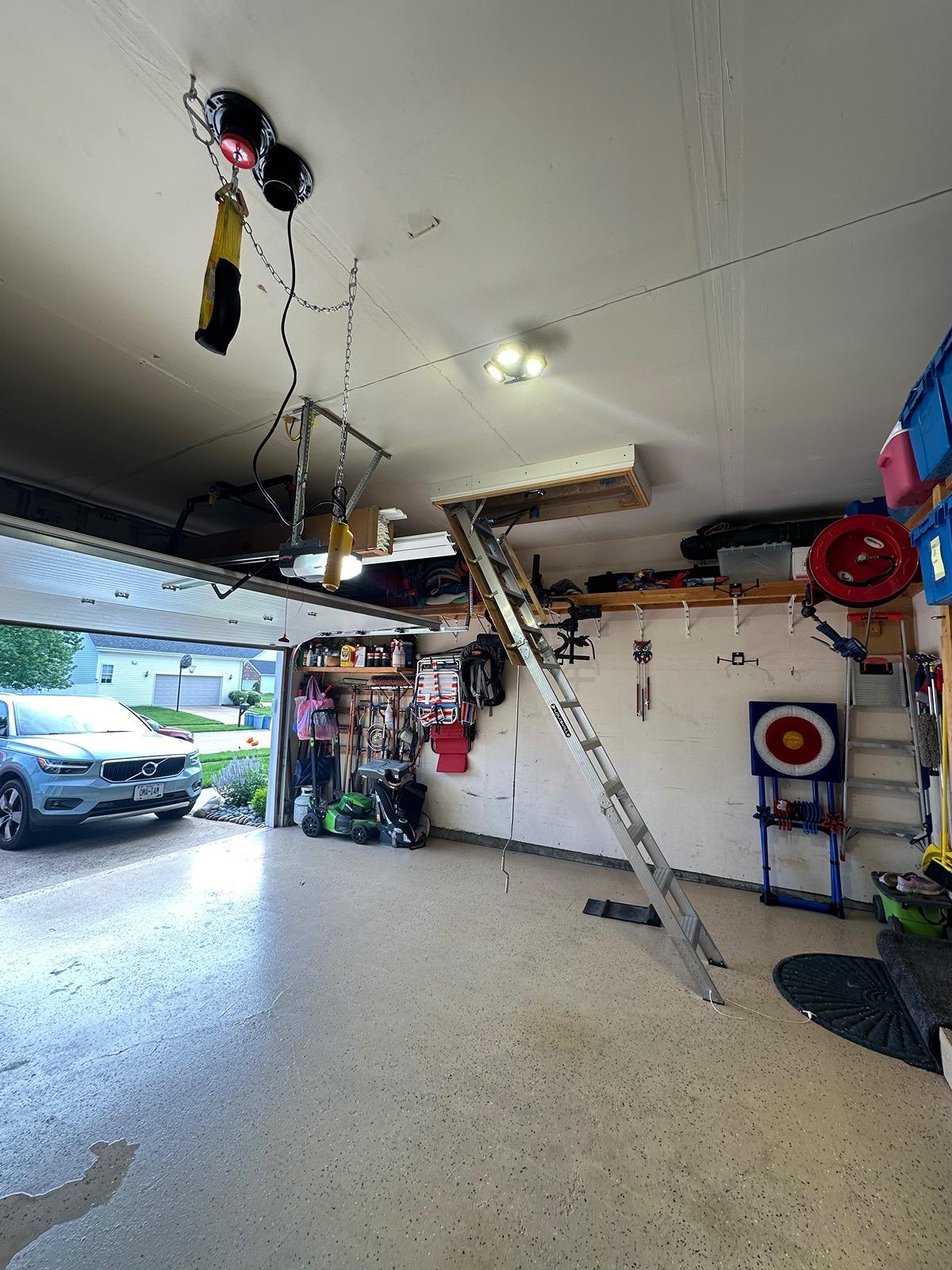

We got a hoist with an electric winch (hoist a top), and it is much easier to get off and it stores up and out of the way.
So, if a hoist isn’t an option, I suggest getting a couple of relatively strong men.

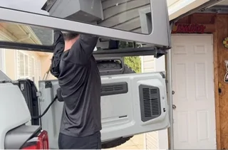

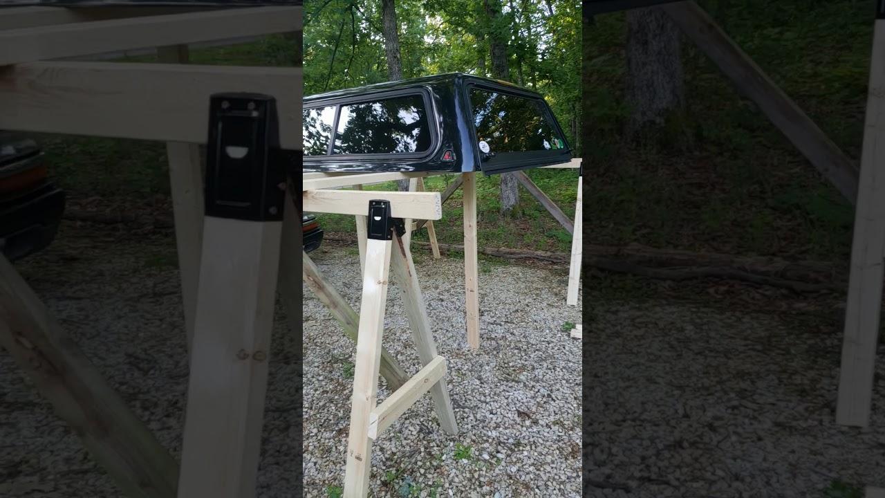

Before we got our Top lift Pro, we set 2 inexpensive foldable saw hoses with 2 -4x4s behind the Bronco. My wife is also vertically challenged but she is able to help me fit top straight up and walk the top 5' back and set it on (remember the pins) the saw horses. Plus it's waist high and much easier to pick up and reinstall.
pic for example

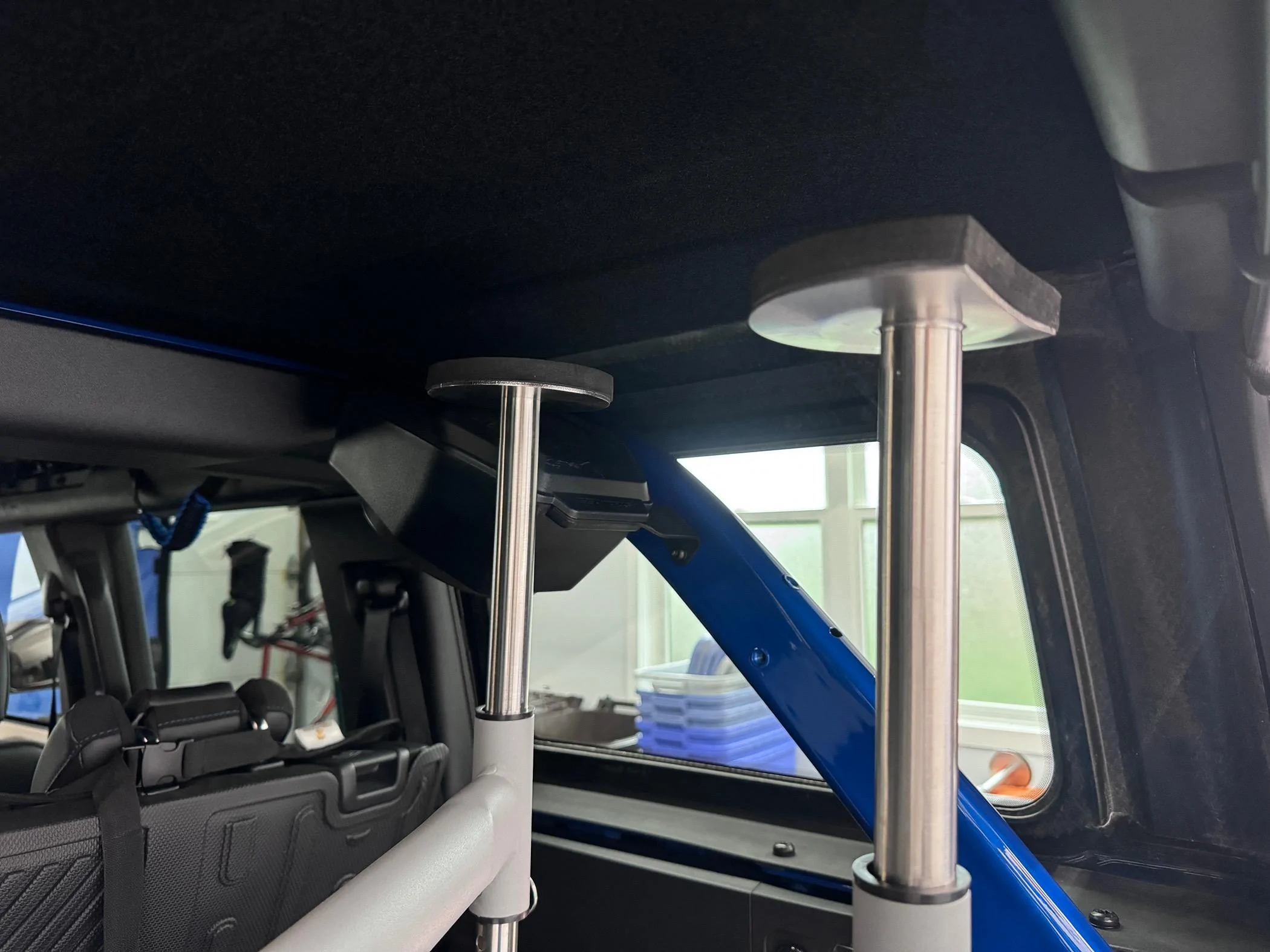

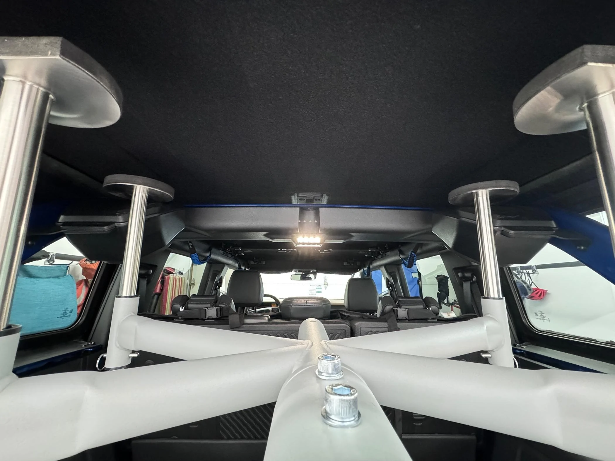

How do you get around the rear crossbar (where the speakers attach) with the arms sticking up?
The 2 front uprights go in between and not past the crossbar. I have the larger SSv pods and it still works. The SSV pods are wider than stock, so I got the half moons for the rears and everything works.
If you have stock, you’ll be able to push in farther and use full moons at the rear.
It takes me about 10/15 minutes alone and that’s what unbolting everything and putting the jack in place.

With the hoist, we leave the hatch and windows attached and put the two front panels on top of the rear section. It lifts everything together.
