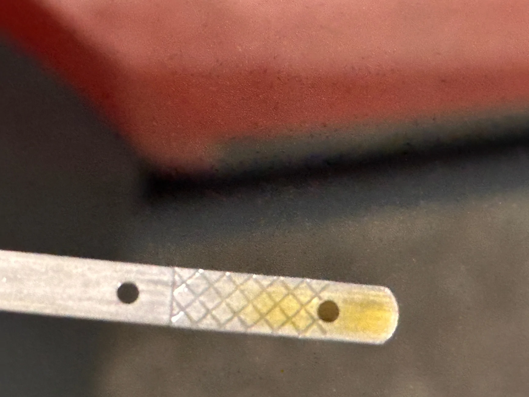

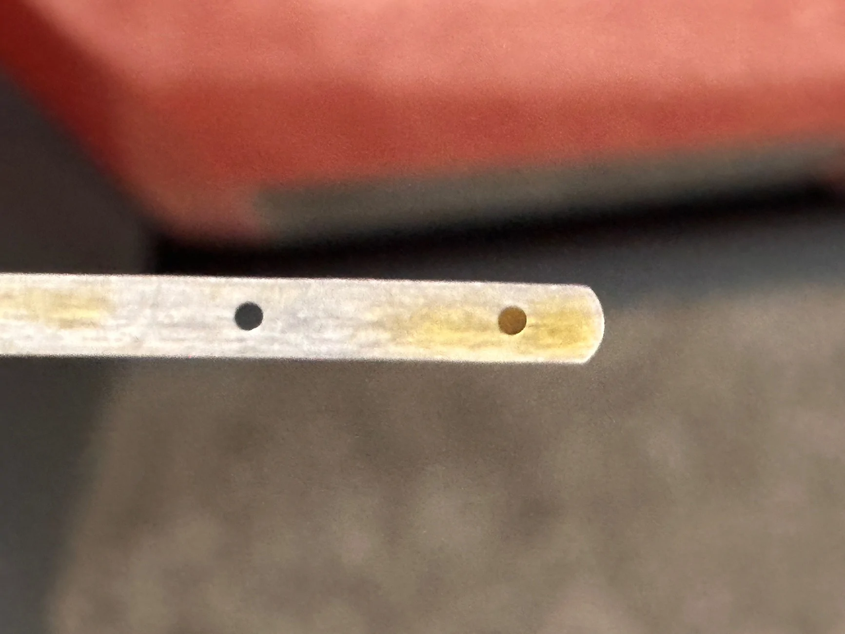

I let my oil drain for 20 hours overnight last time. I even jacked up the driver side and used a MityVac to suck the pooled up residue from the bottom of the pan.
Then Measured 6 Quarts into a graduated funnel during my last change in case you don’t trust the Mobil Juggalos to measure properly.
Primed the system then drove for 20 miles.
Let it sit overnight for 14 hours then checked level:
Ford Bronco Severe Oil Consumption- 2022 2.7 IMG_7101
IIRC, dot to dot is 1/2 quart. I could see an argument for maybe another 1/4 quart here….maybe. But 6 QTs put it right in the zone. If you don’t do all the silly stuff I did overnight with jacks and vacuums 6 qt is probably right on the money.
Ford Bronco Severe Oil Consumption- 2022 2.7 IMG_7100
Yeah anywhere between the dots is consider full. For me, 6 puts it right in the middle which is perfect. I guess if you really wanted to get all the way to the top, then 6.5/7 would work.
Isn't going to make a single difference either way. The way I see it, the 7th quart is just a waste of money.
LSW
L
Oct 14, 2023
271
378
North
'24 Bronco Wildtrak
I agree, 7 would put me over max level (top dot) by at least 1/2 qt. As I understand it overfilling can have adverse implications for the PCV system. 1/2 qt over is probably not going to matter like you say, but overtime overfilling can send more oil through the PCV valve, leading to deposits and actuation problems. Then there is the extra drag and some impaired oil dispersion inside the crankcase if the level is significantly high.
