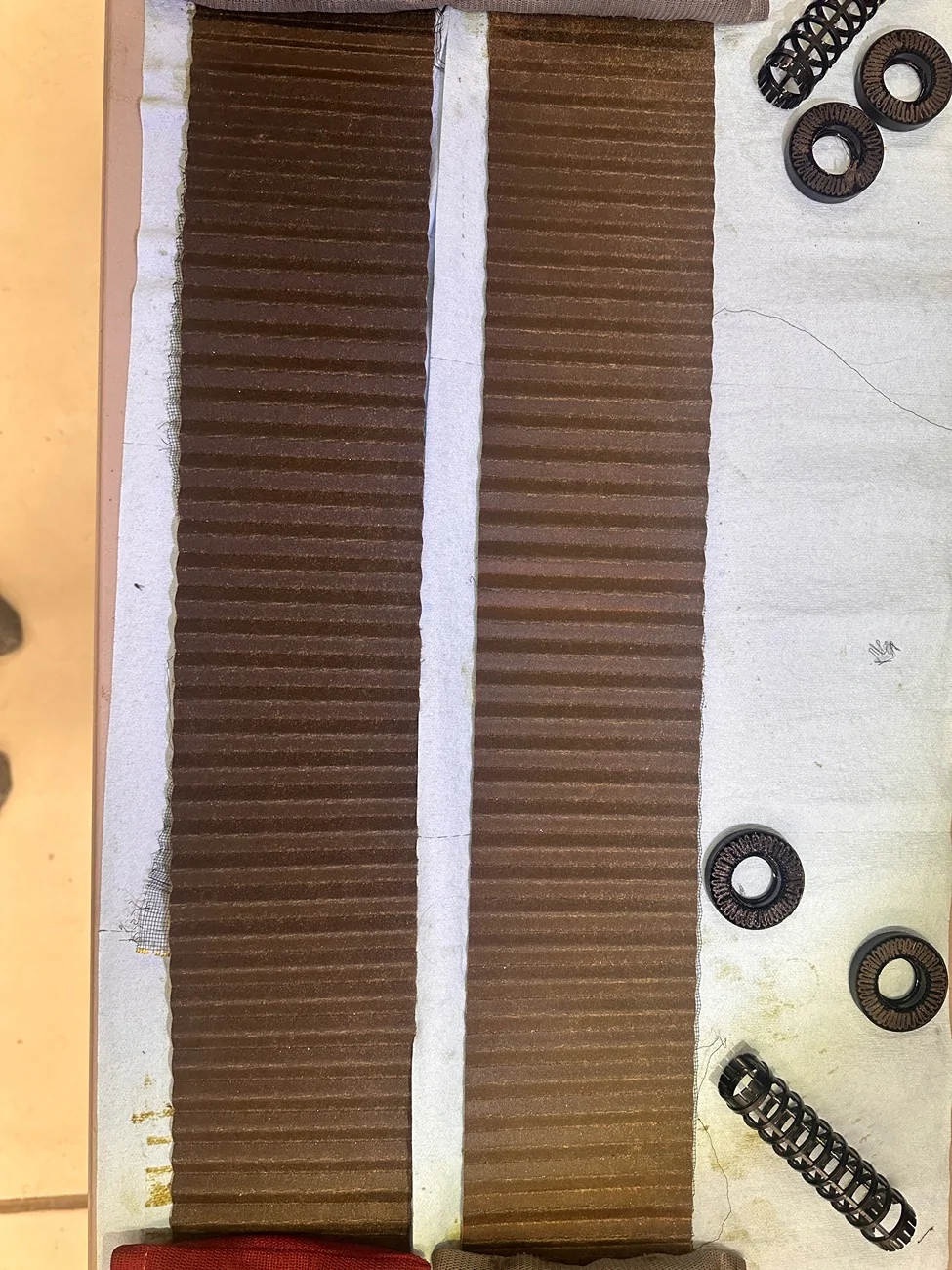

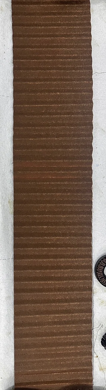

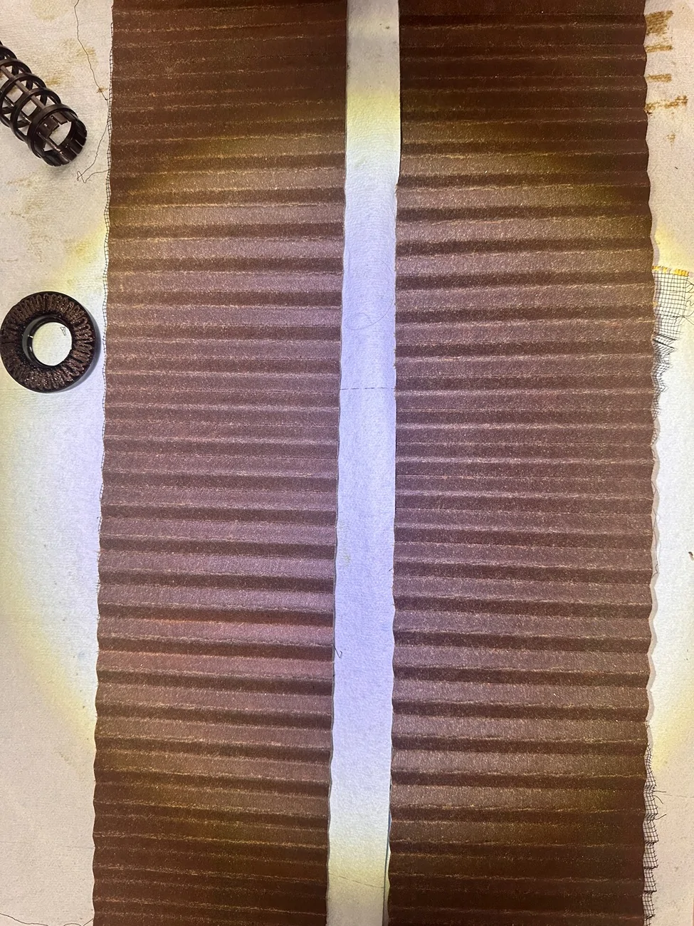

Yesterday, I briefly cut opened the filter and saw small metal pieces on the media. Will layout today and see if magnet pics up anything. I hear that if flakes remain, that is a lot better than if the flakes are picked up.
I’ve cut open most of my oil filters in the dozen or so oil changes I’ve done for my two broncos and there are always some sparkly flakes on the filter media. Most of the time they aren’t magnetic which probably means they’re aluminum. The engine’s front cover, lower block, and pistons are made out of aluminum along with a lot of other parts, I’m sure. I’ve also had oil analysis ISO particle counts done and nothing was deemed abnormal in those counts even with some flakes in the filter.
So I would say what you’re seeing is probably normal.
These two are from 5,000 mile runs on Valvoline Restore and Protect and HPL.
The sparkles never show up that well in pictures but I’d estimate each filter has 2-3 dozen little pieces of glitter, a few in each pleat.
