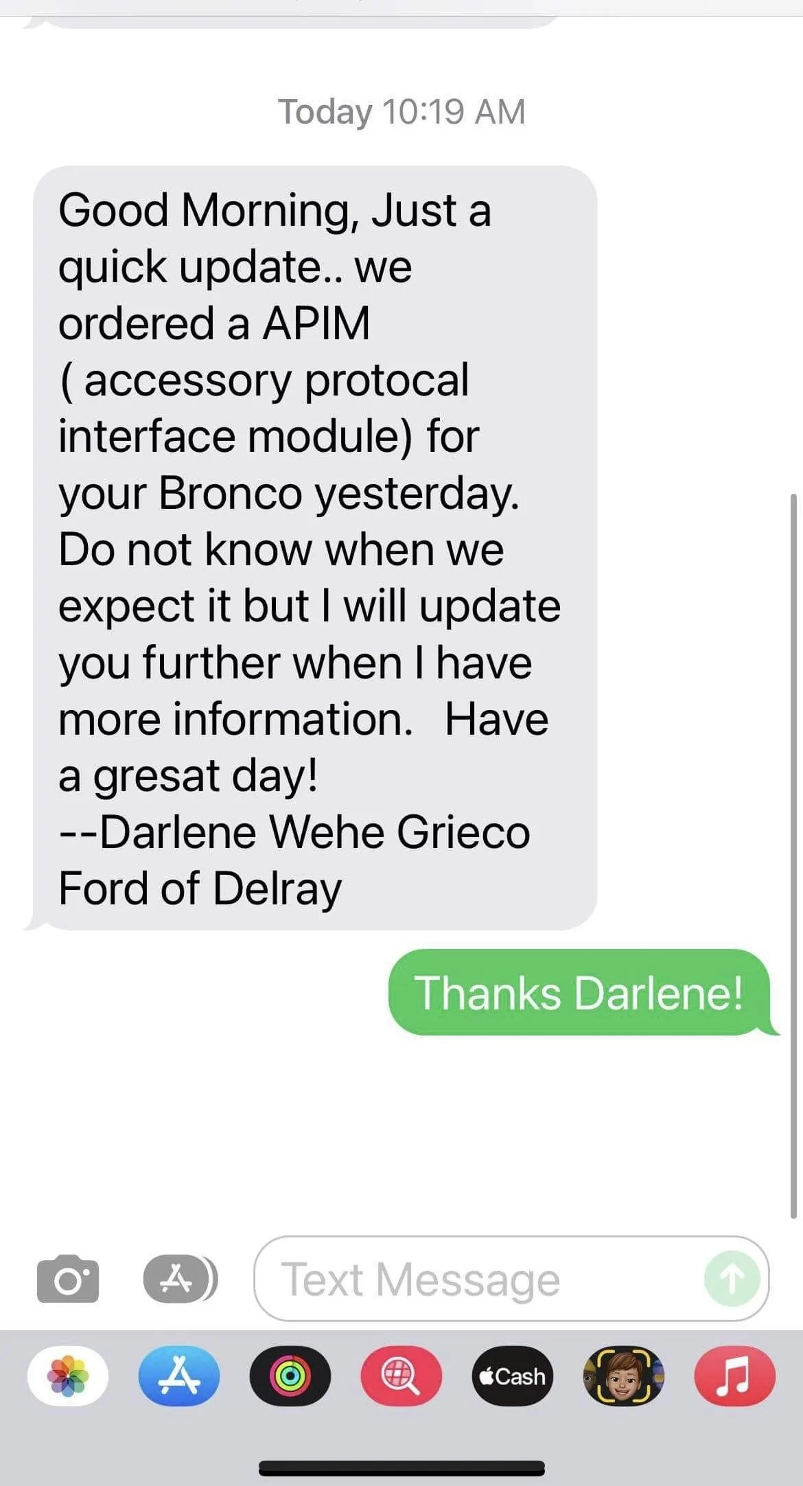

Dropped off the Bronco and manager said it’ll be 3-5 days before they’re even able to look at it because they are so backed up. He gave me a loaner vehicle which I appreciate. Here’s my ride to the next who knows how long.

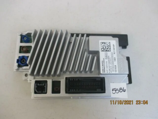

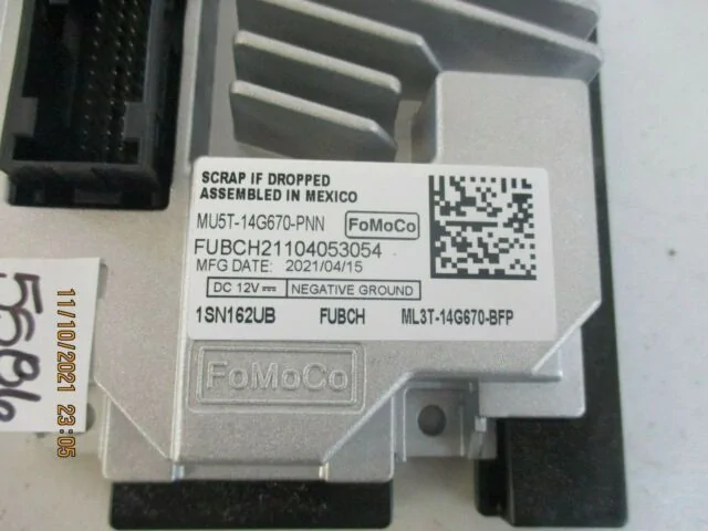

It's not just a "chip" (i.e., semi-conductor). It's a computer module with a Central Processing Unit (CPU) that must be programmed and other chips on a printed circuit board, mounted in an aluminum housing with heat sink fins for cooling, and with multiple connectors to the various accessories that the system integrates and manages on the 12" screen. Hence the name Accessory Protocol Interface Module (APIM).
This is what it looks like on another Ford model (F-150 SYNC 4 APIM):

It sits right behind the 12" screen, and to get to the multiple connectors you basically have to disassemble the entire dash and remove the screen, which I addressed in detail, and included the attached procedures from the Workshop Manual, in this prior post.
When technicians have checked the connector at the dealership during the troubleshooting phase, they have usually just checked the main connector C210 below the glove box and behind the right trim panel in the foot well (see location diagrams below), as well as run Pinpoint Tests (PPTs) on the APIM itself via the FDRS software package.
Ford Bronco Serious Tech Issue - 12 Inch Touchscreen blacked out / bricked (by software update?) C210 Location 1
Ford Bronco Serious Tech Issue - 12 Inch Touchscreen blacked out / bricked (by software update?) C210 Location 2
Ford Bronco Serious Tech Issue - 12 Inch Touchscreen blacked out / bricked (by software update?) C210 Location 3
I doubt any service technician that decided during troubleshooting that an APIM was bad has physically checked for loose connections on the module itself, given the difficulty of accessing the APIM behind the dash. Of course, they will obviously have to access the module when the replacement units arrive and have to be installed.

It's not just a "chip" (i.e., semi-conductor). It's a computer module with a Central Processing Unit (CPU) that must be programmed and other chips on a printed circuit board, mounted in an aluminum housing with heat sink fins for cooling, and with multiple connectors to the various accessories that the system integrates and manages on the 12" screen. Hence the name Accessory Protocol Interface Manager (APIM).
I literally walked in and said "Hi my name is Karen and i need to speak with the manager". I didn't even ask for a loaner car. We talked for 5 seconds, he left the room and came back with a loaner car for me. He was scared. You all make fun of Karens but I just want to thank you for creating us🤣

Sorry to hear this. Did they confirm if the order processed or if it's still on backorder for you?
I did not replay more than what you see. I’ll wait for an update.
