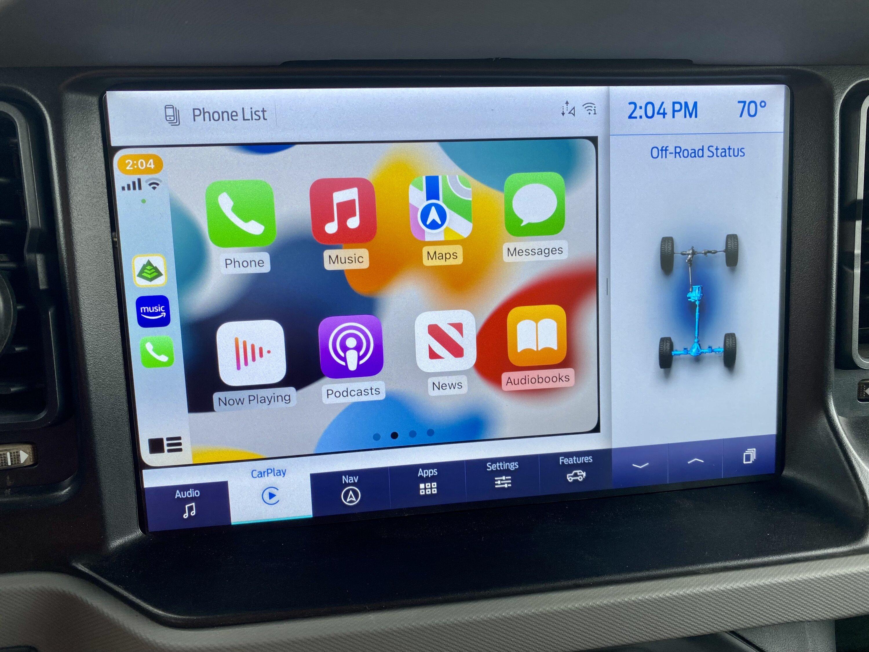

Successful transplant! I arrived at the dealership at 10:30 AM and departed at 2:00 PM. Yay! :cool:
