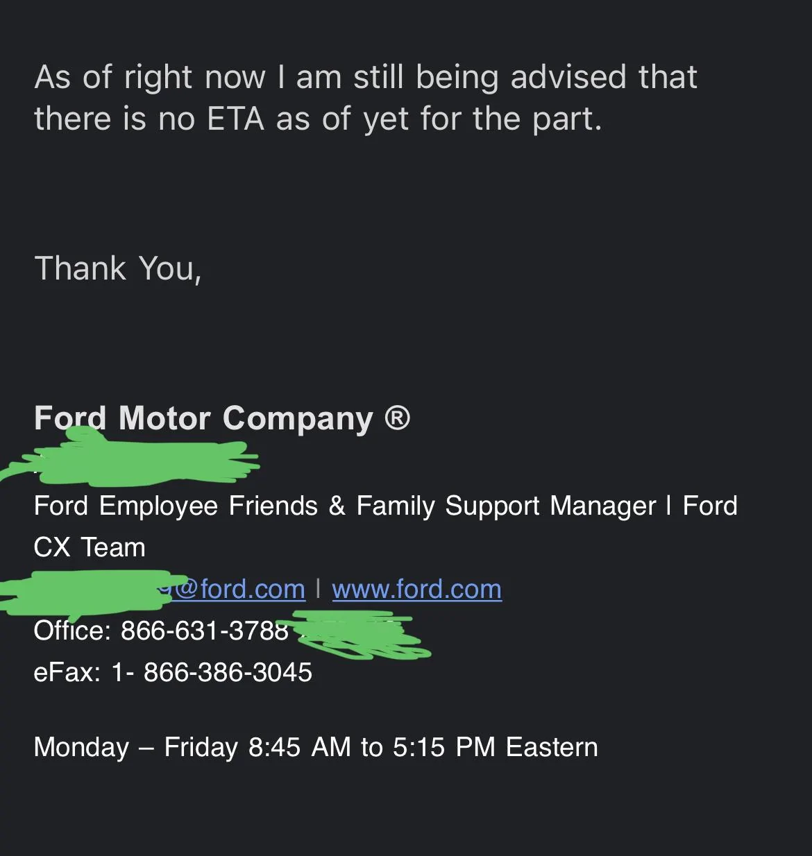

theres another thread here somwhere with the same info, but my APIM died at the end of march and i dropped my bronco off at the dealer on April 1st. it has been there ever since. dealership has provided a loaner for the duration but this week will be five months without my vehicle. dealership cant do anything, customer service cant do anything, ford credit WONT do anything. new machines keep rolling off the line with working APIMs, though.
the last communication with customer service said that the part is direct shipped to the dealer and that ford is "working diligently on getting the programming fixed".
