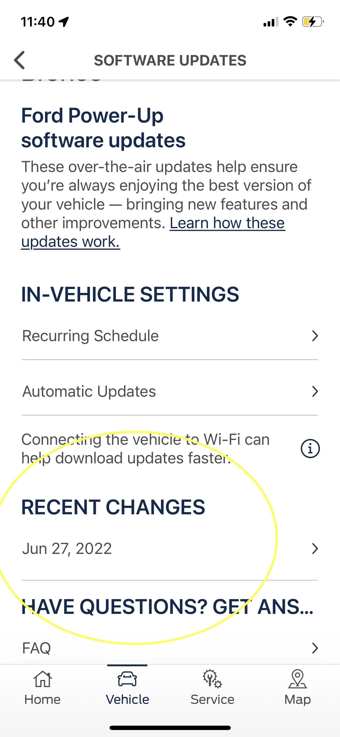

Well it happened to me today :cry: After almost 9 perfect months and 7800 miles my screen went completely black when I started up the car. I’ve tried several times since and nothing happens. Holding the power button and scan does nothing. Nothing is working at all. I have an appointment with my dealer next week.
Sorry to hear about that. :(
If you get a chance, check your FordPass app to see when the last OTA update occurred, and also check with @flip to see if there are any failed OTA updates in your vehicle history report.
I spoke to my service advisor again today, and still no visibility on ETA for the replacement APIM. Obviously, still backordered. 🤨

Thanks. I’ll contact @flip in the morning. Do you mean this?
Ford Bronco Serious Tech Issue - 12 Inch Touchscreen blacked out / bricked (by software update?) D3567A15-165A-43FF-A39D-856170A6AB34

Yes, that’s it. So your software hasn’t updated since 6/27. My software had not updated OTA since 6/14, and my APIM failed at least two weeks ago.
@flip can run your VHR if he has your VIN. On my VHR, there were notes of repeated OTA failures, and there is a possibility that one of the failed updates may have bricked the APIM.
I sent Flip a message. I also noticed that my charger below the screen is also dead.
