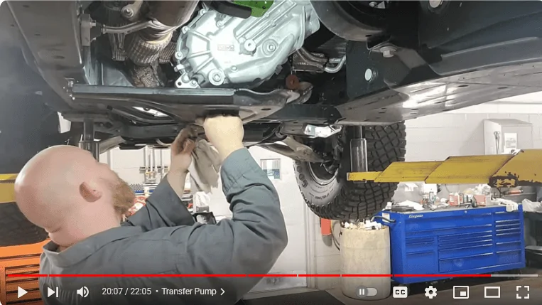

I did have this thought but it wasn’t cold enough to cause that, at least I don’t think. Also, I’m pretty sure the bash plays cover the transfer case? Am I wrong?
Sorry for the long wait, I was trying to find a good enough screenshot of the transfer case and the associated skid plate. The bash plate that you are referring to is not the same.
