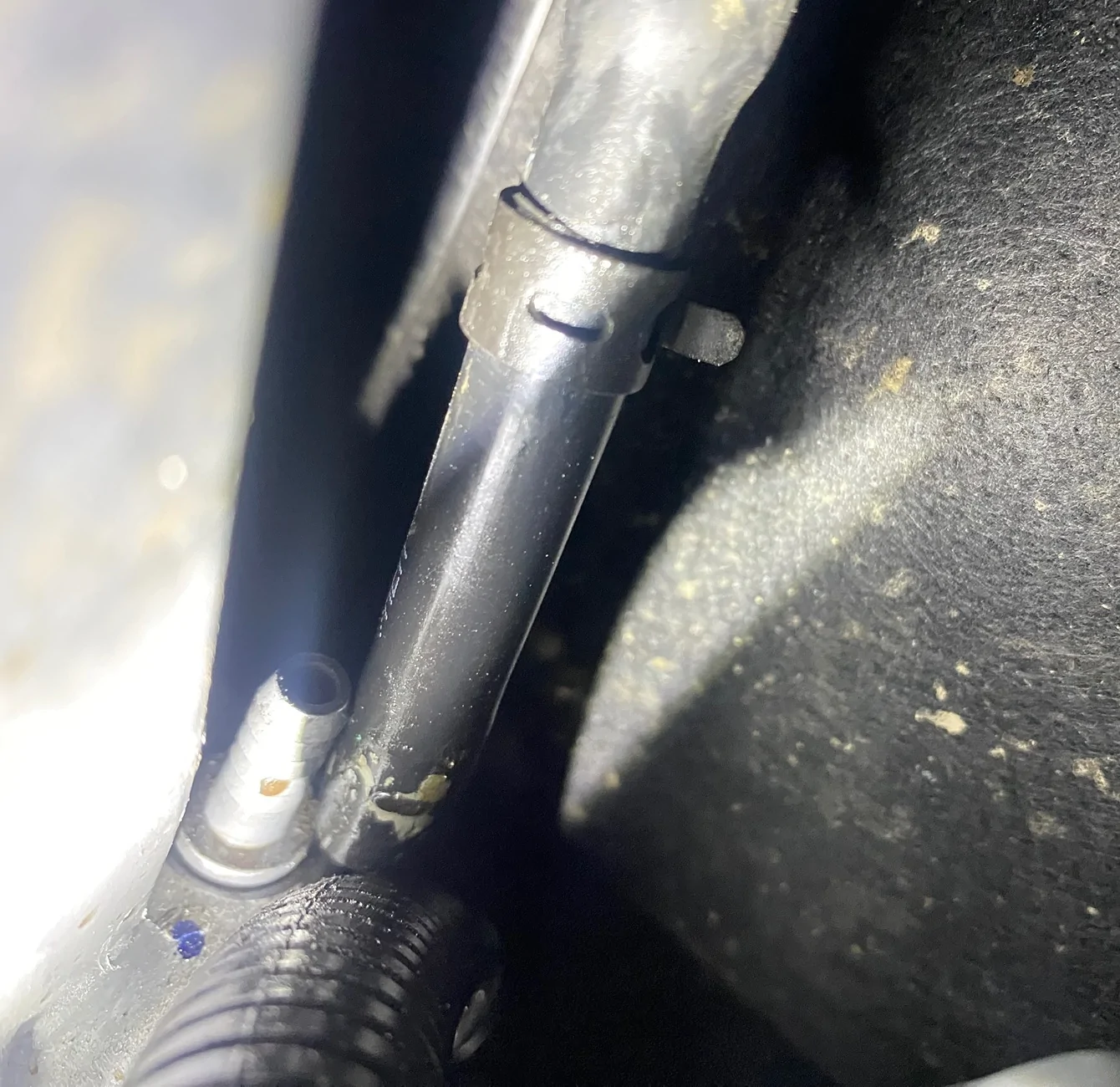

For those that have had transfer cases replaced, be sure they reconnected the breather tube and clamped it. Near the top of the t-case is a hose barb and there should be a black tube clamped on there. I had my advanced T-case replaced at 12k due to a noise and they forgot to reconnect it.
I never had any functional problems or codes but the Bronco had a low speed rotational hmmm-hmmm-hmmm sound most apparent at 9-12mph that one dealer thought was wheel bearing (and replaced it) even though I never felt any excess heat in the wheel. That didn’t fix it. After I noticed some fluid got spewed from the back of the transfer case where the drive shaft connects, I took it to another dealer who replaced the t-case under warranty. The noise went away. I had to go back later when I eventually realized they forgot to connect the breather tube and fluid was dripping from the hose barb down a wire harness. I told them to 1) connect the hose and 2) drain and replace the t-case fluid at no charge and they did.
Now I have a recall linked to that repair because the transfer case and tranny may not have been aligned correctly and the splines can get worn leading to very bad things. No issues in the 10k since it was done though so mine might be fine. When parts are available (supposedly in early May) the dealer will contact me to make an appointment for inspection and repair if needed. I’m assuming they need to remove the t-case again for the inspection so I will be rolling under there the minute I get home to be sure it all looks good.
This is what you don’t want to see after a replacement:
Ford Bronco Transfer case failure. IMG_4281
