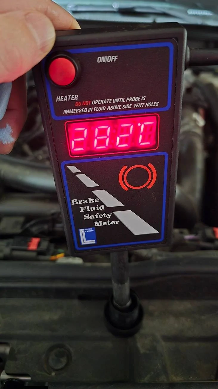

In terms of testing everyone here is right, just because it says 3 years doesn't mean it's actually needed. I did it so my extended warranty contracts don't give me grief for not following the manual but technically my fluid didn't need to be exchanged.
My tester actually boils the liquid and checks the max temp. Old fluid and new had the same boiling temp.
