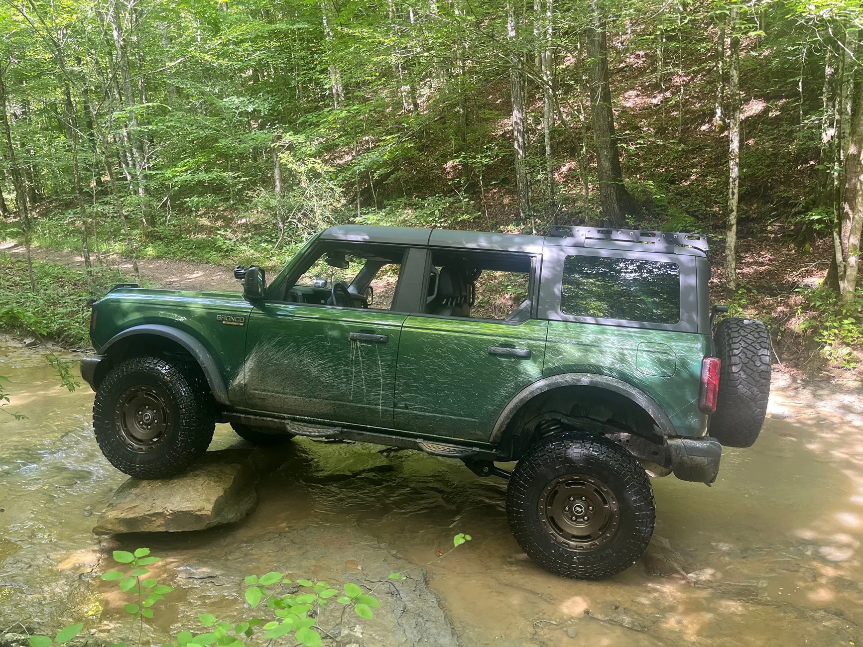

Well, for what it’s worth my Bronco isn’t a Sasquatch. But I do have 2” lift on it. I’ve been riding on the Kenda klever RT 35x10.5x17 load range D. 40k miles on them and they never left me stranded. Finally replacing them with falken atw4 35x11.5x17. Curious to see how they do for me down in red river gorge, ky! Lots of neat info In here. Thanks guys.
