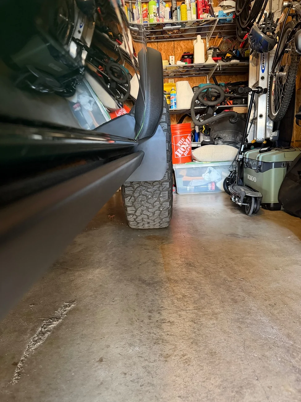

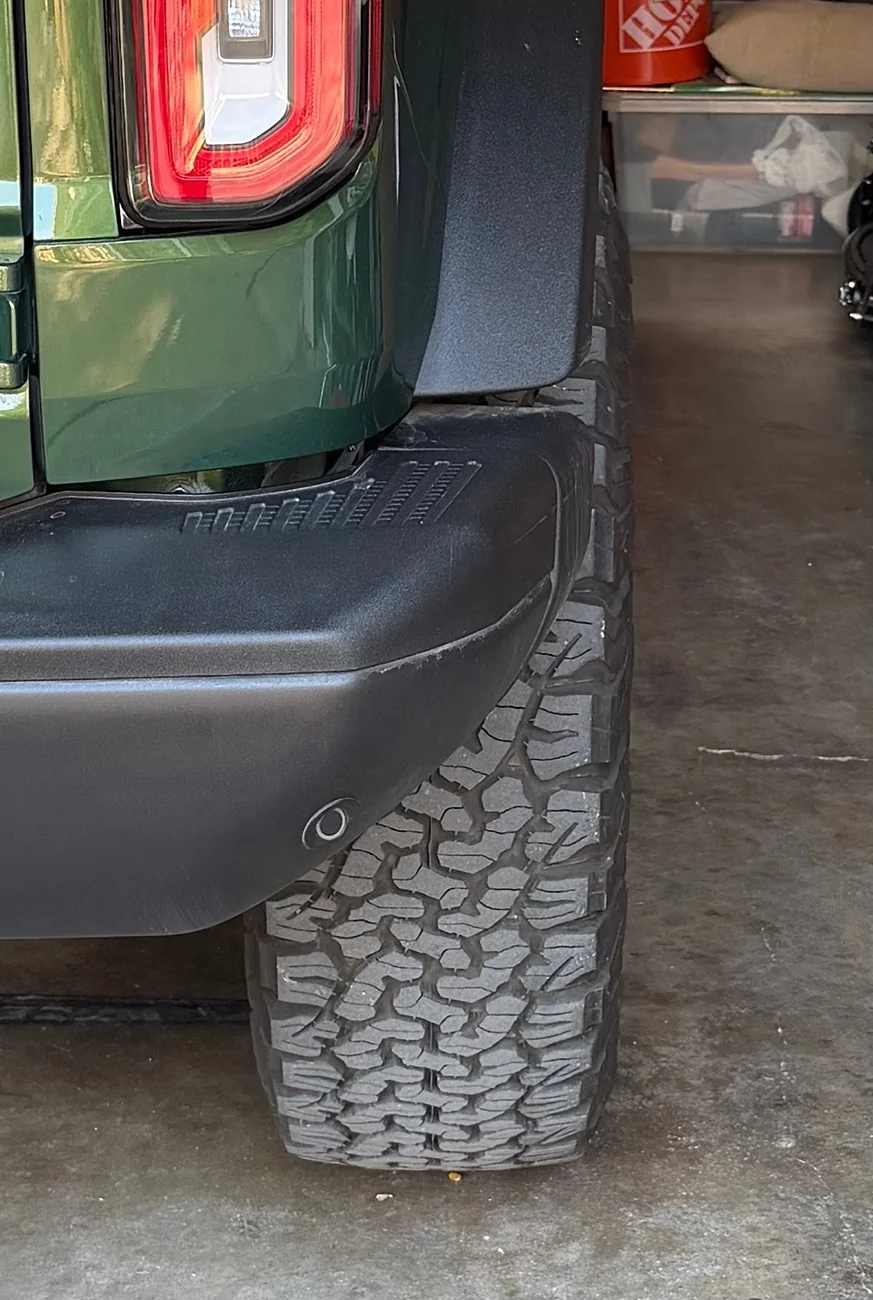

I currently have a 2 door Badlands non Sasquatch with standard Badlands wheels and tires…WITH A 1 IN SPACER.
Ford Bronco Need help - Tire Poke Comparison IMG_1291
Ford Bronco Need help - Tire Poke Comparison IMG_1292
Also if it matters I upgraded my shocks to Fox 3.0. I have about 3/4 in poke with my standard badlands fenders.

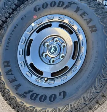

I’m thinking of adding optional silver “Everglades” wheels with Goodyear Territory RT 315/70 17 tires.
Ford Bronco Need help - Tire Poke Comparison IMG_5060
Question is how much will these wheels and tires poke out compared to my current setup and do I need to remove the front crash bars?
Thanks in advance for your advice.

You can use sites like https://tiresize.com/calculator/ and others to do comparisons with this or that wheel/tire size, spacers, etc.
Yes (particularly if you leave your spacers on) you will need to remove crash bars, though if I remember correctly some folks leave them on with minor rubbing at high steering angles and/or lots of articulation off-road.
High clearance crash bars are available in the aftermarket.

The one inch wheel spacers give your current setup a +29.6mm offset. I recall those Everglade wheels have a +30mm offset? In that case basically no change to the offset (if leaving off the spacers).
The added width of the 315/70R17 tires will protrude a bit more, maybe 1/2 inch or so, I doubt more than an inch.
Thanks. Always struggle with the offset numbers.
Much appreciated.
