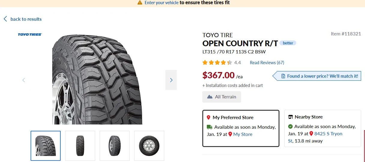

I'm confused.
You start out talking about TOYO AT 3s but your link is for Toyo Open Country RTs.
Your link also states 69 pounds per tire not the 61 pounds you mention.

Yeah I clarified went with c ply RT. Balance and bounce more important to me.

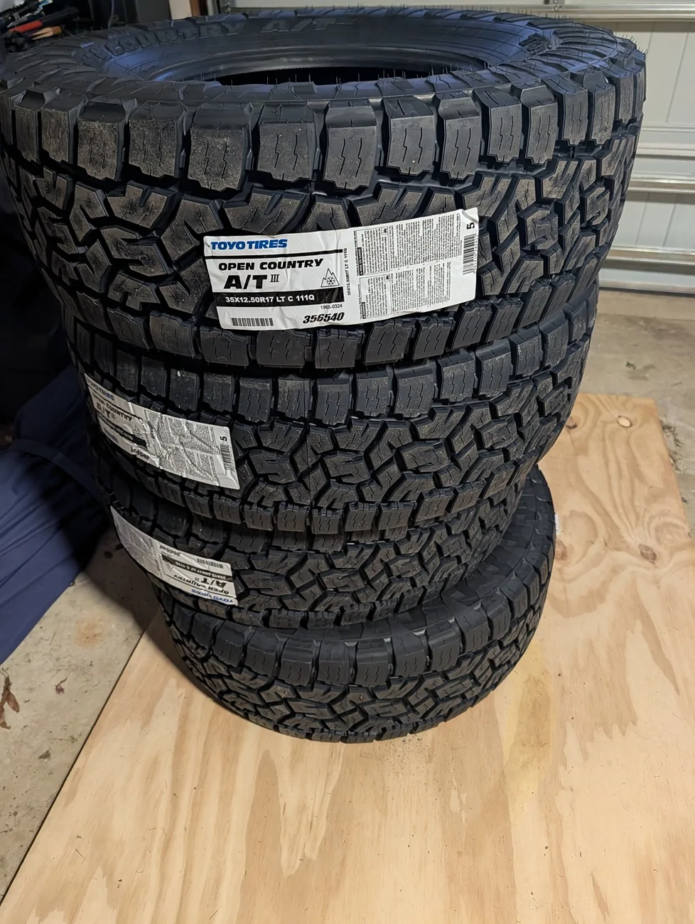

Yeah it is here...
Toyo Open Country A/T III in Load Range C (Part #356540) is being phased out. However, because it is a specific "enthusiast" spec (the lighter 60 lb version), many shops don't keep it in the showroom. They often have to order it from a regional warehouse, which can take 1–3 days. Extreme terrain has it but maybe discount tire can get it locally. it is confusing industry in general. This size is mostly heavier ply and some D ply makes sense too here.

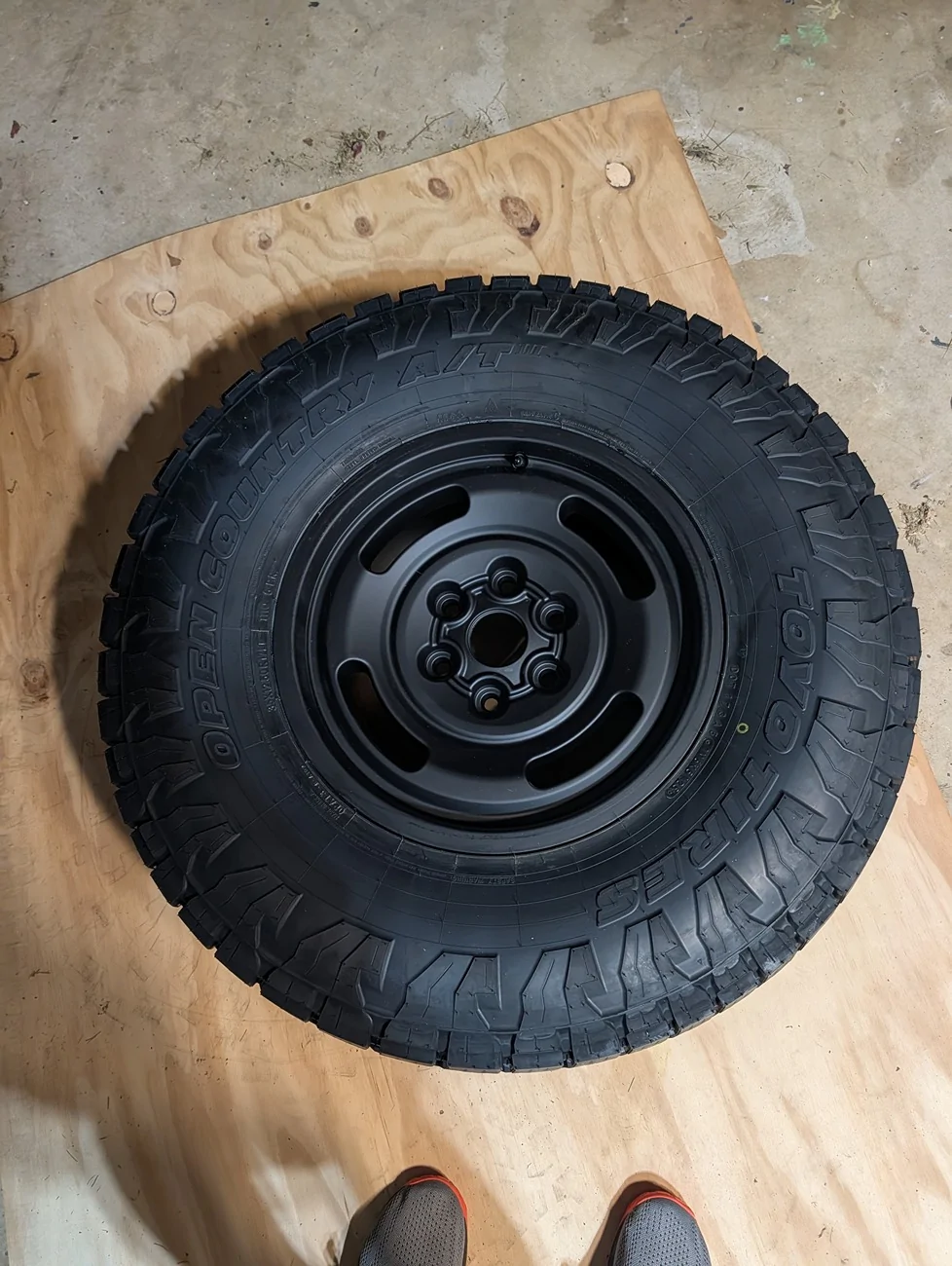

I ended getting them too/ Fifth is still ion trunk. Ill just ruin the Goodyear RT on weekend
