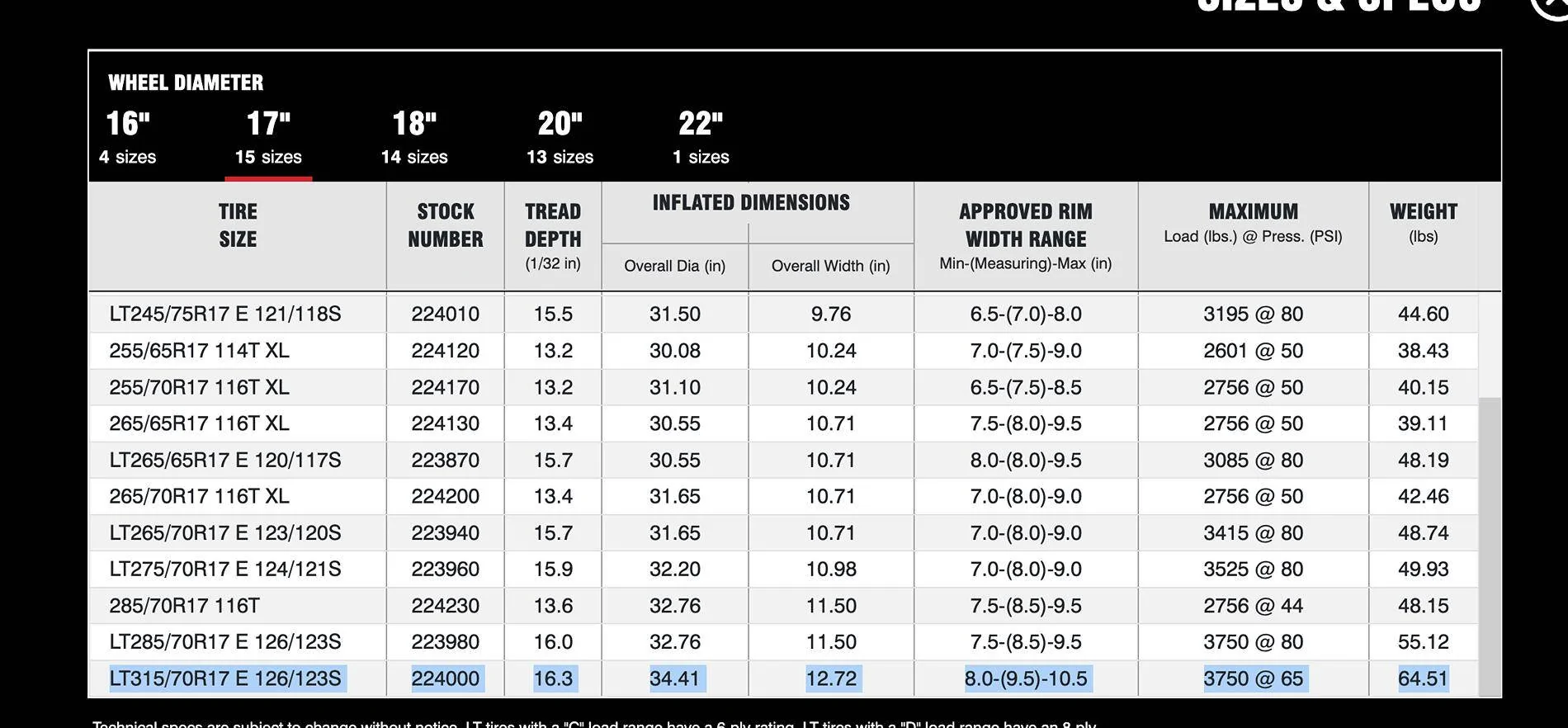

Not sure if this will help, but here are some 35" 3 peak rated:
Nokian Outpost nAT
Ford Bronco 35" + 37" + 40" Tire Comparison Spreadsheets Screenshot 2025-01-15 at 8.30.43 AM

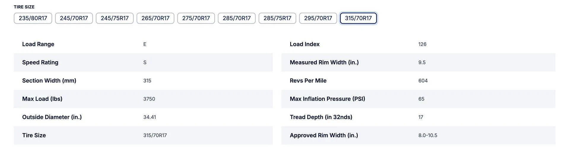

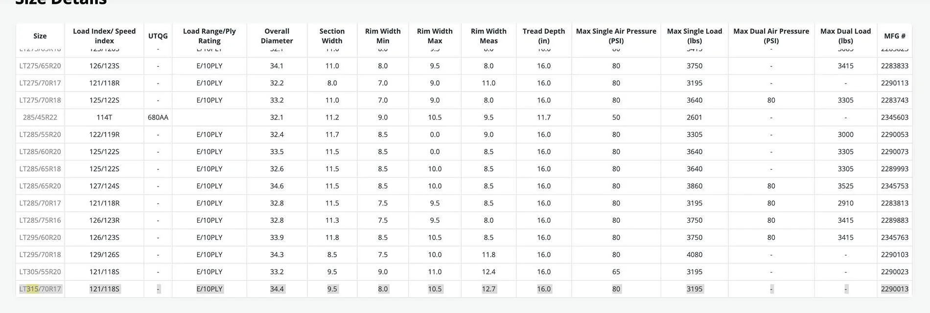

Nitto Terra Grappler G3
Ford Bronco 35" + 37" + 40" Tire Comparison Spreadsheets Screenshot 2025-01-15 at 8.30.58 AM

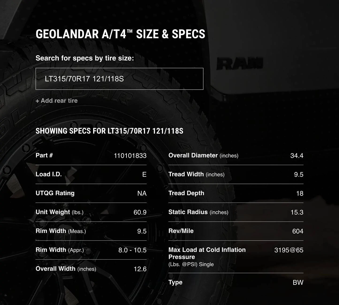

Yokohama GeolandarA/T4 (G018)
Ford Bronco 35" + 37" + 40" Tire Comparison Spreadsheets Screenshot 2025-01-15 at 8.31.58 AM

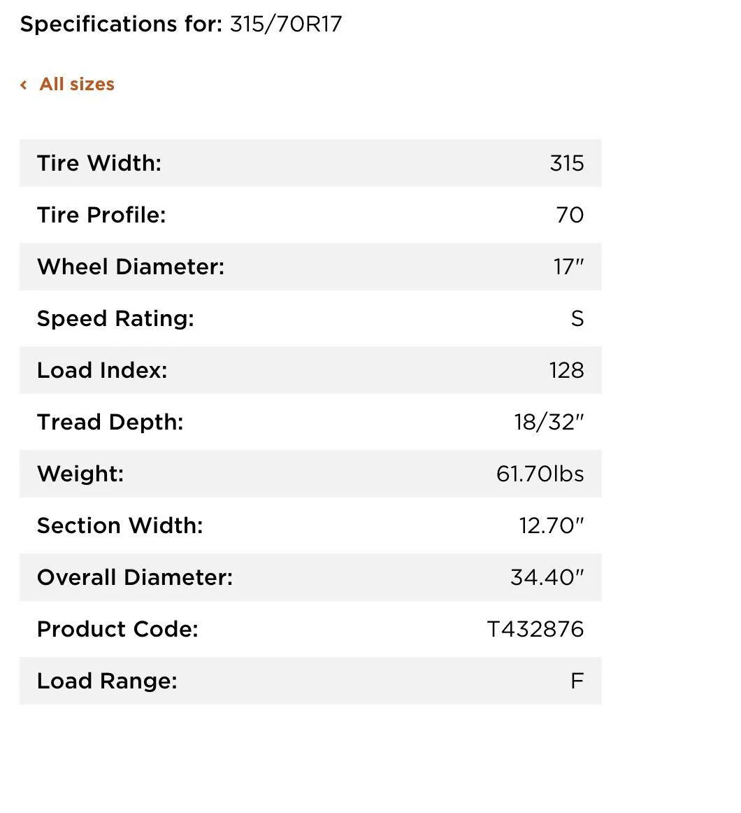

Cooper Stronghold AT
Ford Bronco 35" + 37" + 40" Tire Comparison Spreadsheets Screenshot 2025-01-15 at 8.35.21 AM

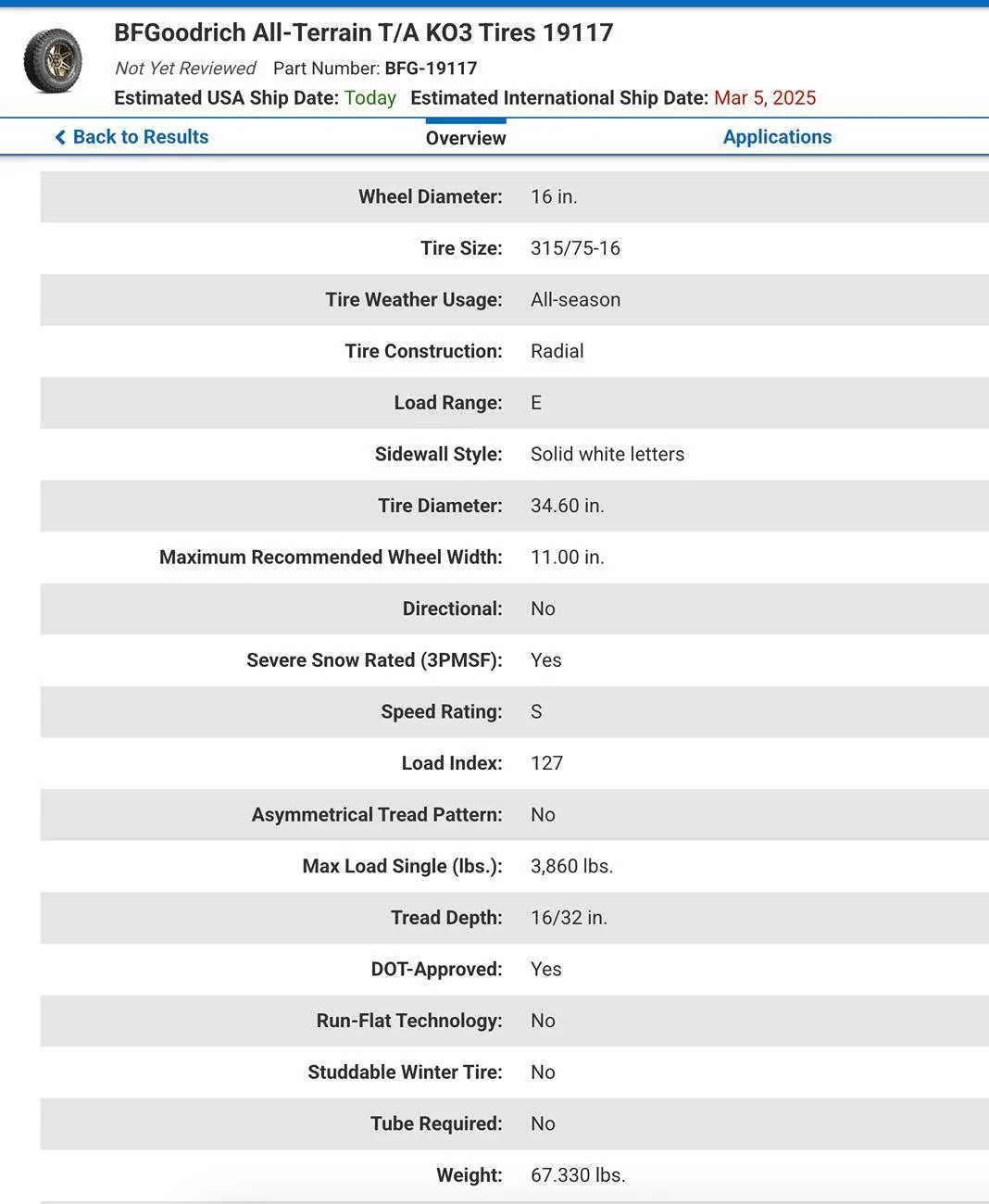

Looks the KO3's in E are coming out
Ford Bronco 35" + 37" + 40" Tire Comparison Spreadsheets Screenshot 2025-01-15 at 8.38.04 AM

What??? Not one "True 35" on the list. Imagine that :unsure:
Prepare for the chair chucker's :sneaky:
not on a 17 inch wheel at least. I did the “real 35s” hunt for my Ram a few years ago and they do exist in metric on 20 inch wheels. No help here but those unicorns are out there.
