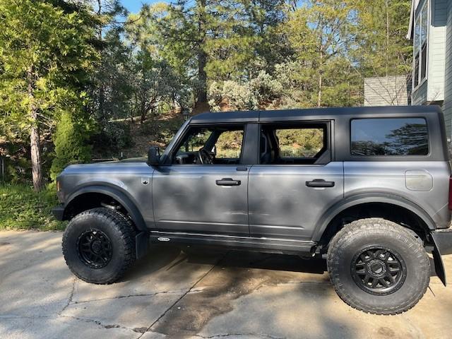

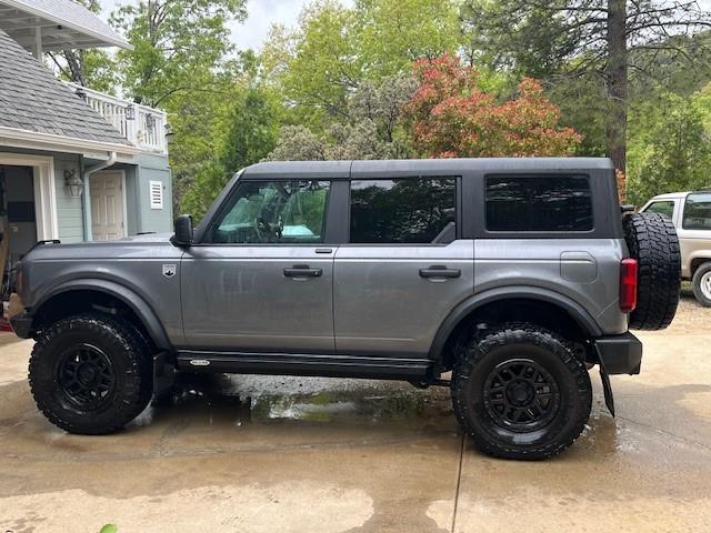

Has anyone lifted 3” and put 35’s instead of going bigger? If so, could I get some pictures posted please?
I started out with a 2.5" RC lift. When I upgraded to the 4WP/ProComp shocks I took the RC lift out and went minimum setting on the shocks, and that ended up being a 3" lift. Or... at least, it was 0.5" over what I had with the RC kit once I got the shocks dialed down to their minimum setting.
I'm running 35x12.5r17's -- two pics, a bit different lighting on them since I have this amazing high contrast color pallet thing going on.
I've contemplated running 37's the next time I get tires - but with my Big Bend HOSS 1 steering rack and m190 front diff/axles I'd probably want to upgrade all of that before I made the jump, or really risk breaking something.
Ford Bronco Functionality - 35’s or 37’s lift1
Ford Bronco Functionality - 35’s or 37’s lift2
For what it's worth, that extra 0.5" of lift also tanked my MPG by 0.5 MPG. Not that I care, but some people do, and there's a good data point on what a lift will do for your mileage.
