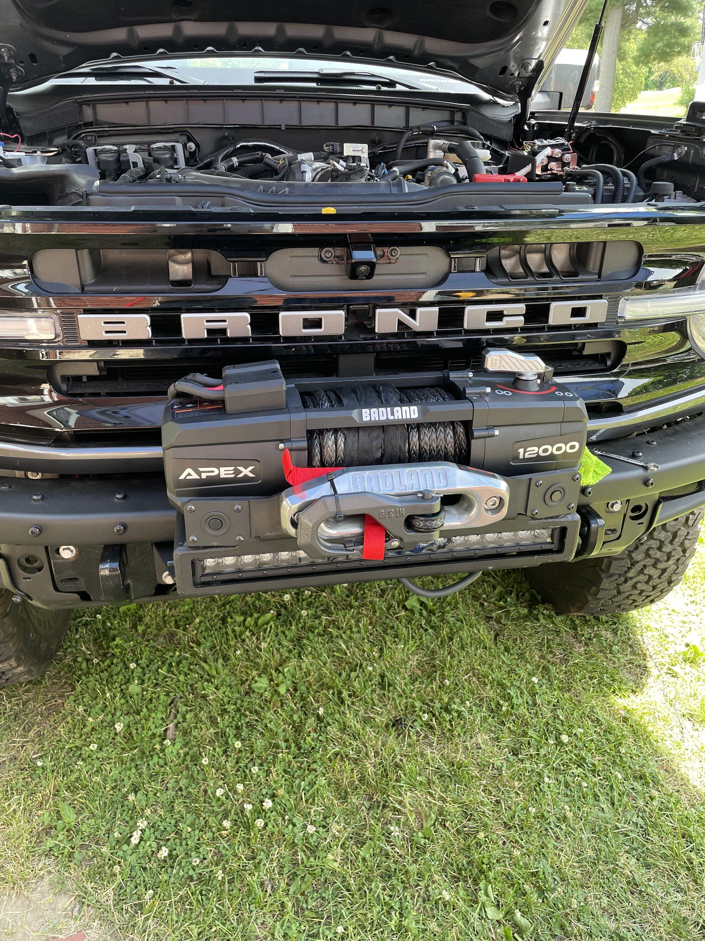

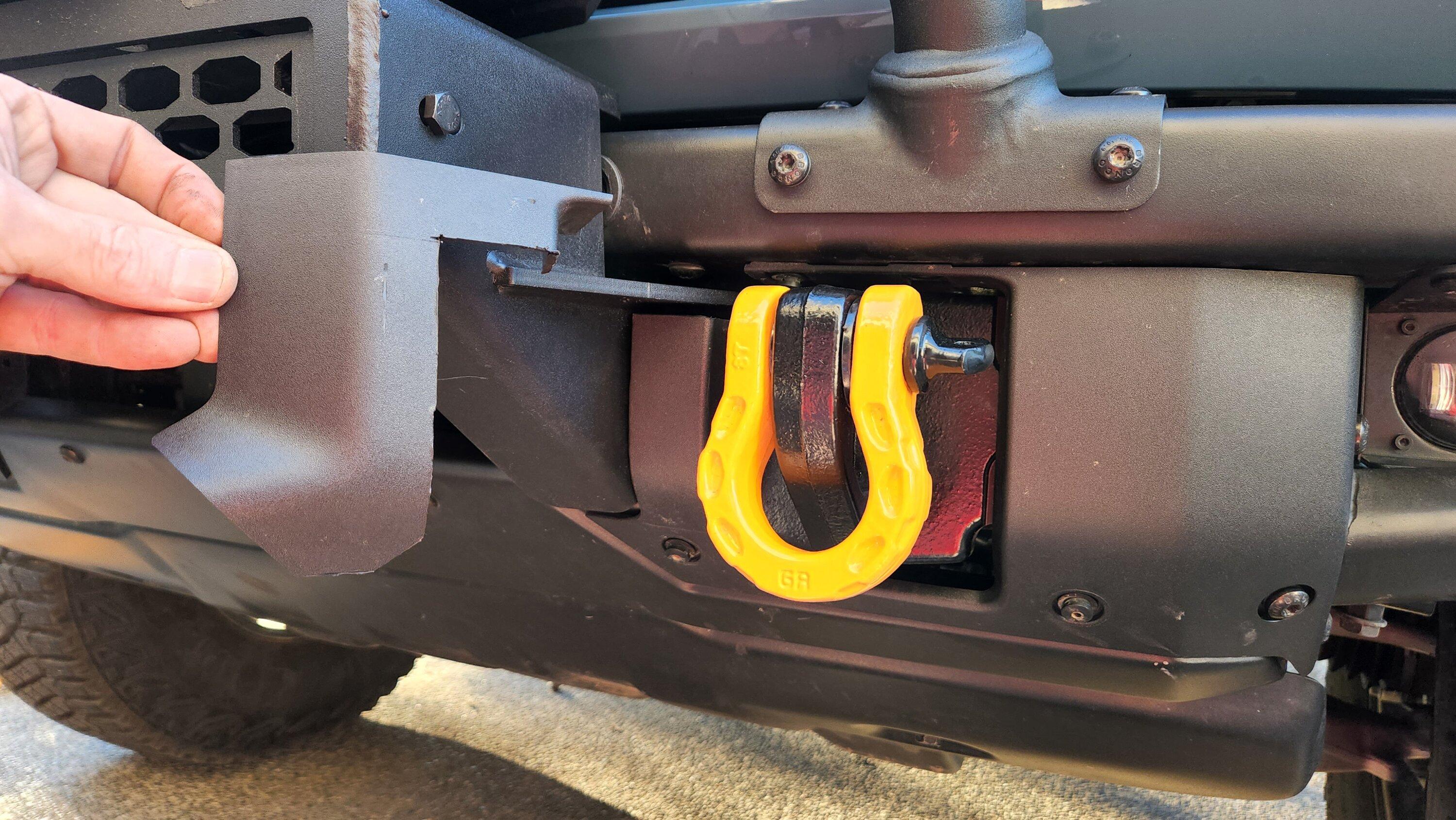

Almost ready to install, waiting on the matching light bar that arrives today, I'll pull the camera so I can install when the JCR bracket arrives tomorrow. I'm thinking this RC mount will be temporary, the bumpers (ARB and BAMF) I wanted had too long of lead times.

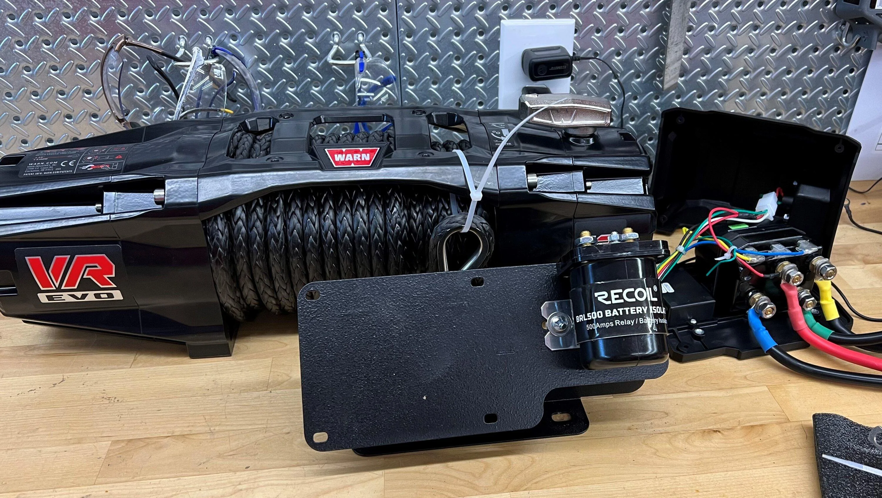

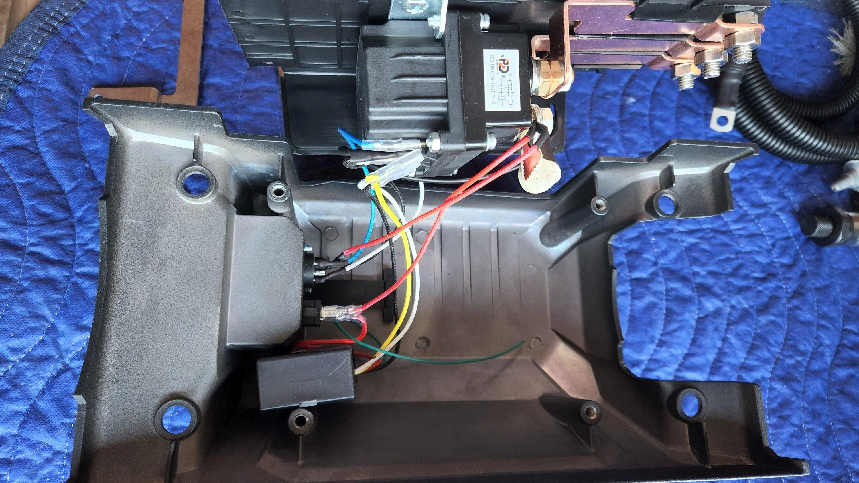

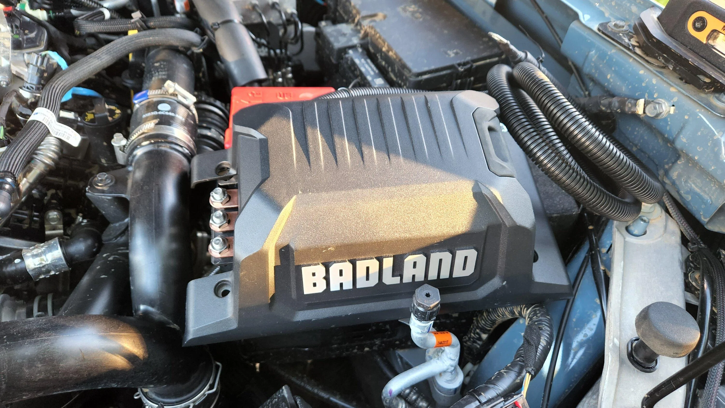

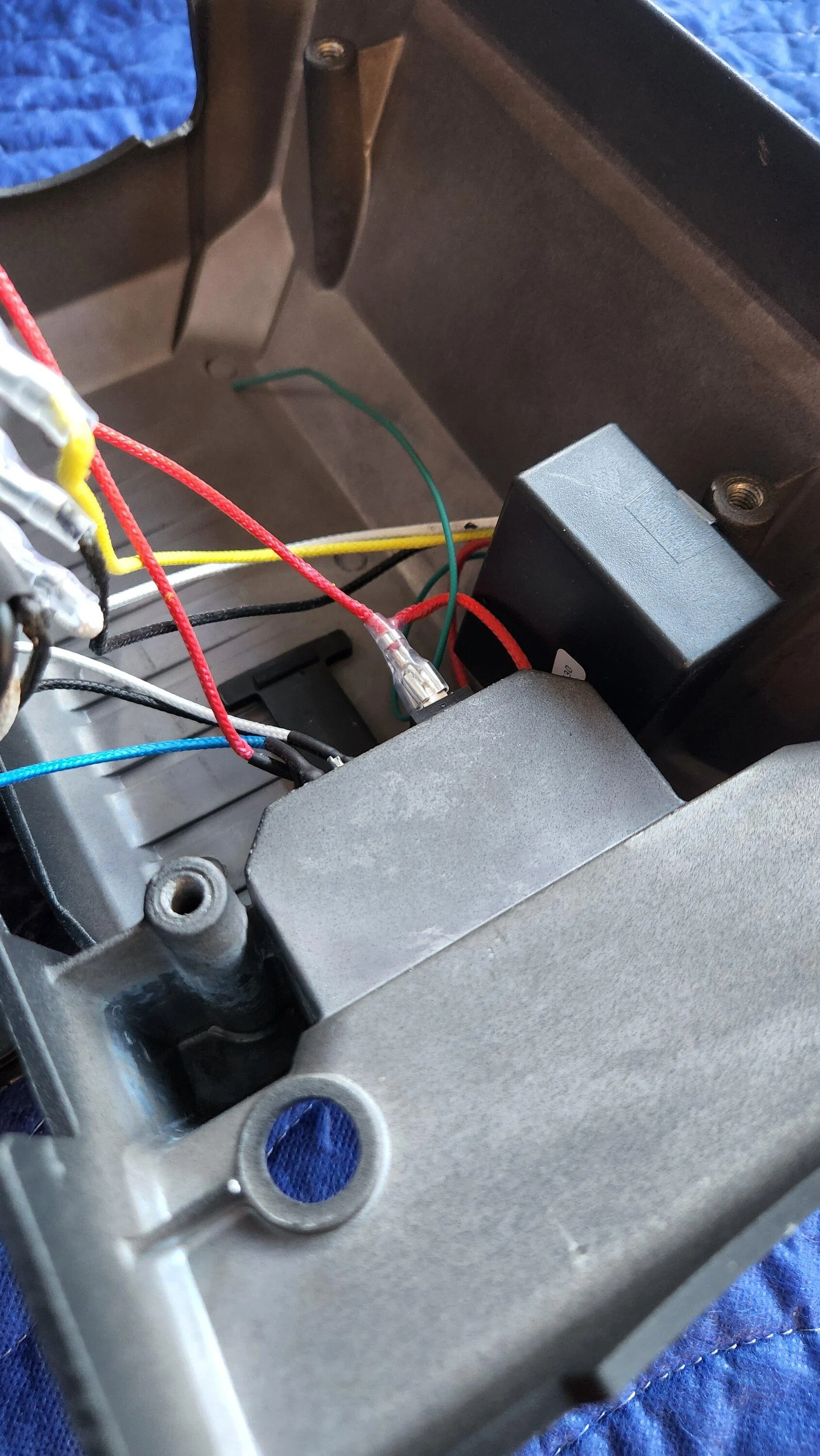

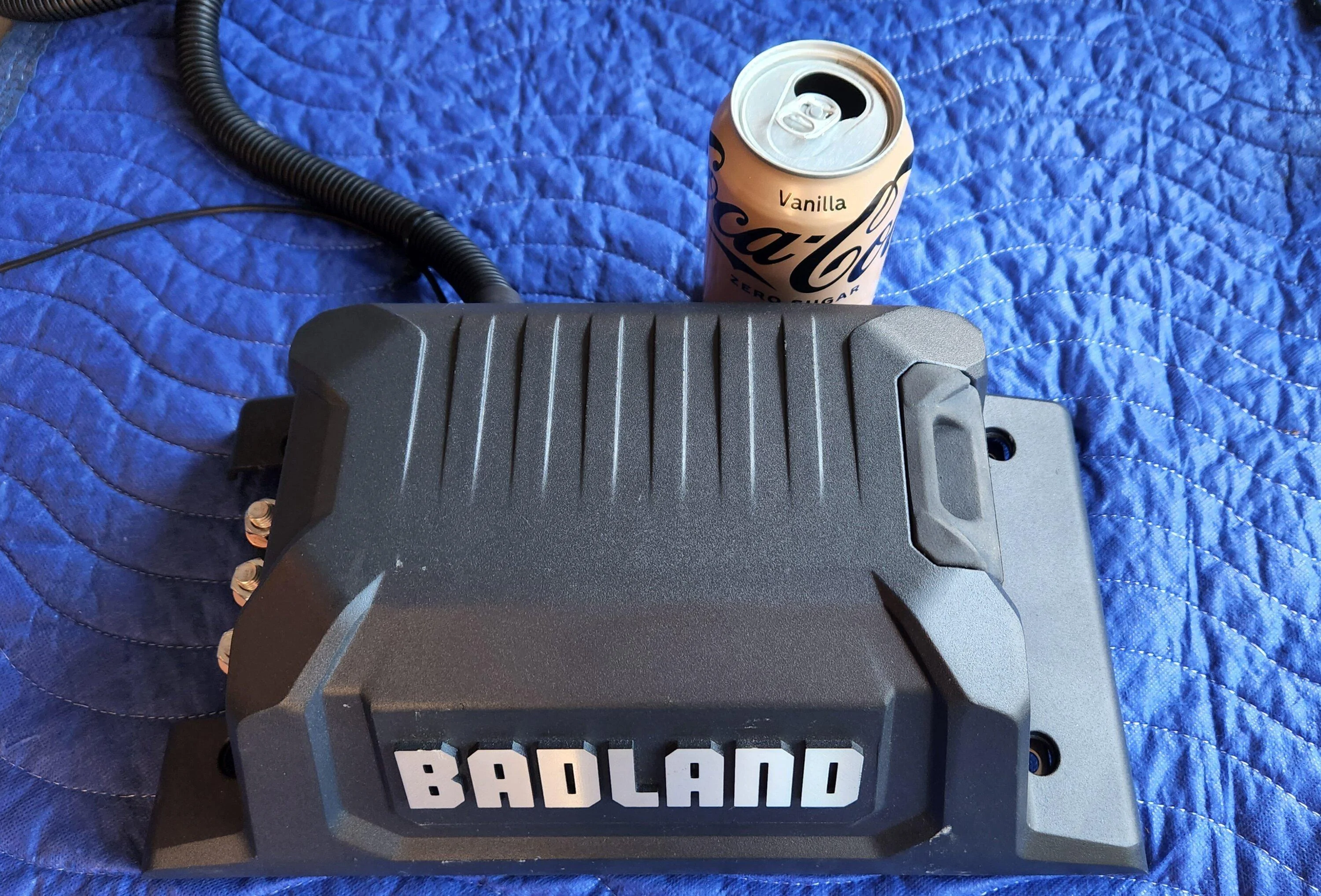

Ok. Problems.
1. The box is just HUGE.
2. It's way to big to fit in BAMF location in front of the battery.
3. The only viable space is near passenger firewall... right next to the turbo. 🔥 Nope.
4. The heat exchanger leaves no room under the bash plate without relocation.
5. I want to cut off the casing parts that make it so big... but I opened the case there's a better solution.
6. None of this stuff is waterproofed. They put a nice rubber cover over the power switch and remote cable... which gives you a false impression of watertightness... because from the underside (surprise), the edges have up to a 1/4" gap between the two halves of the casing. Some of the components (like the bluetooth relay) don't look like anything I'd expose to any weather at all. WTF?
So since the "guts" of it look small and removeable, I'm inclined to get a waterproof electronics project box and reassemble all that kit in a MUCH more manageable (and protective) casing.
Loving the winch. Hating the control box. Part of me is considering just putting it back on top of the winch... but I risk wanting to throat-punch myself every time I looked at it.
So this is no longer a 'tonight' project. For now, a couple of frosty Guinness adult beverages will help me decide the plan of attack. 🍻

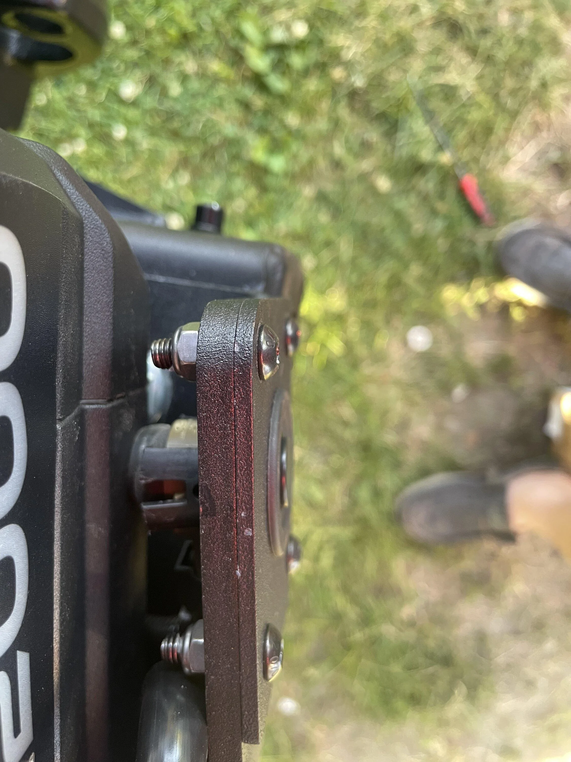

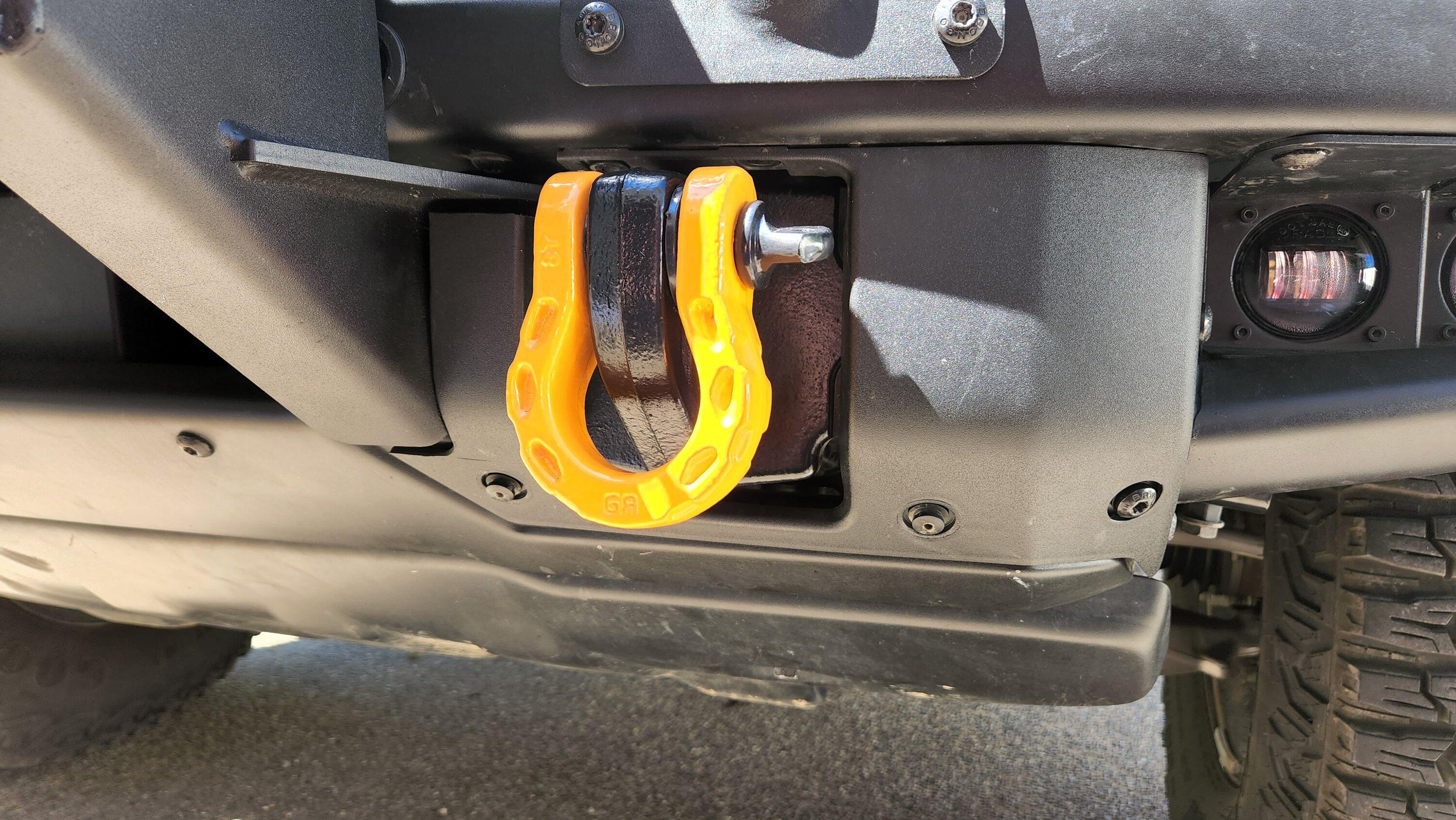

Finally got around to trimming and reinstalling the plastic covers for the frame mounts. It was a PITA because the angles the pics are shot from in the instructions don't give you a good orientation to how the panel is being viewed.
Also, they walk you through doing the passenger side with pics... but the last pic (of the installed cover) is of the DRIVER'S side. They tell you the driver's side is the mirror image of the passenger... but they never show the completed pass side (and don't acknowledge the last pic is actually of the driver's side). It's just confusing.
I used painter's tape to mask off the areas I wanted to keep and mark the inside cut line. I used a Dremel with a narrow cutoff wheel for the straight cuts. To clean it up and make the lower inside radius, I used a cone-shaped grinding stone.
This single picture is the most useful picture I’ve seen in this whole ordeal. Thank you! This gives me a way better reference than the directions. 👍
If that helps... maybe this will, too. Here it is next to the chunk you cut out.

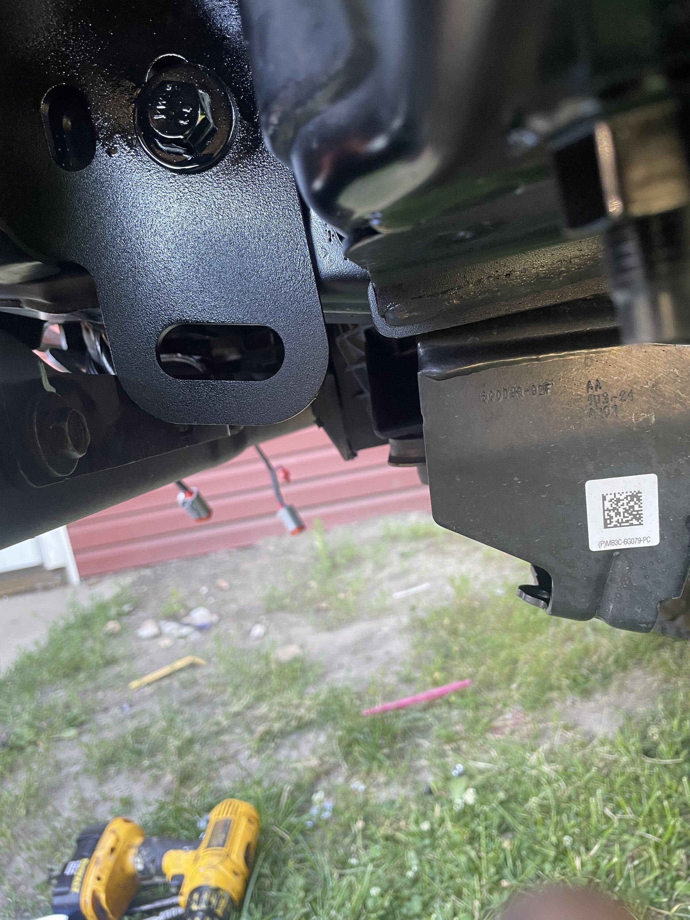

Found it. On the extension harness one of the pins was not seated. So double check Yours just a gentle tug will let you know if they are seated. Here’s a pic of what I did to hold the sensors in. I cut the tabs shorter and used the foam and rubber they give you for a snug fit

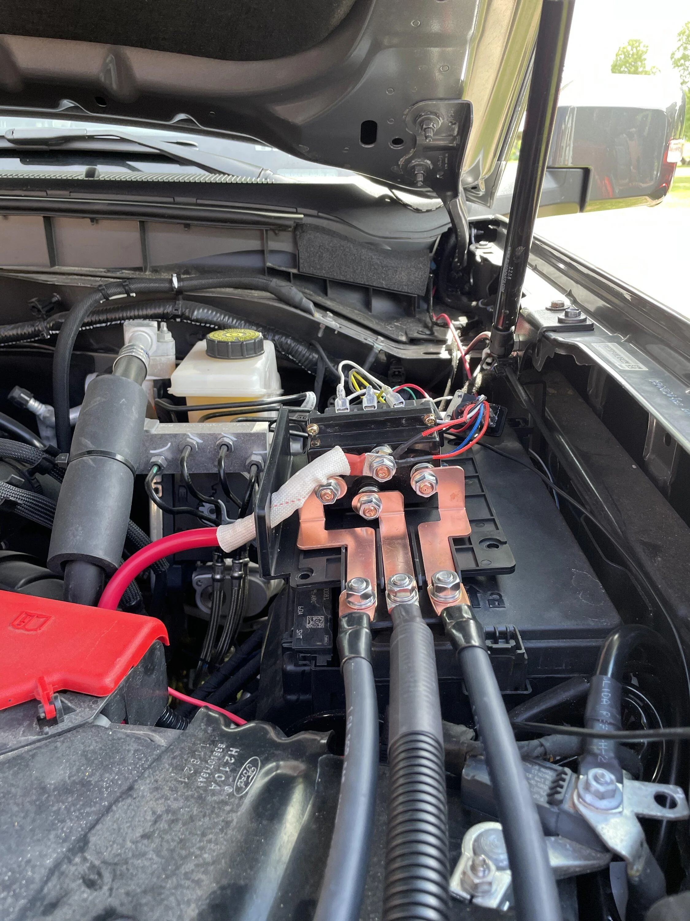

After seeing previous posts and after relocating the camera my free way. I decided I’m going with the control relocate. I went to my local auto value and had them make me some 8’ cables. Ordered a water right project box. Here’s the mock up and wires ran. I’ll unhook the positive lead until the box comes in. I still have to trim the plastic trim parts, and get some more chafe protection on the wires.
