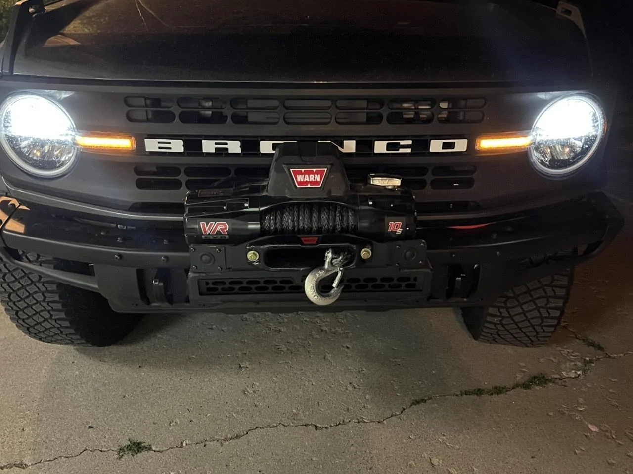

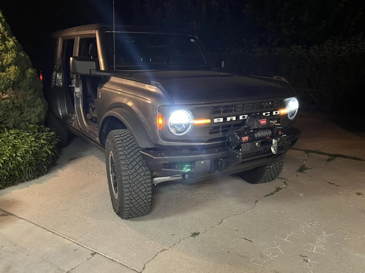

Yeah, I kinda punted on the solenoid relocation. You're right, I'll eventually need a camera relocation anyway (since removing the control box only kept the top half usable).
So the real question became keep half a camera now and still have to figure out the relocation... or just leave it on top and have a working winch today (but no camera). So now instead of being nice and sleek... it's huge... but at least it's functional. Hopefully I still get some radiator flow... lol
I also decided to mount up an OEM brush guard to frame it in and make it look less like an afterthought.

The only thing I don't look forward to about the camera relocation is having to remove the winch and the grille to remove the camera.
@Sreevie had a great idea if I decide to go on with the solenoid relication... and that's to just purchase a smaller control box. Always an option.
Does anyone know if camera relocation also moves the washer fluid line?

it would be kinda nice to put the camera right below the winch since you don’t have the light bar. But then I’m sure it would get full of mud. I do believe the JCR kit extends both the washer hose and wiring.

Yes the washer line needs moved, extended or capped.
