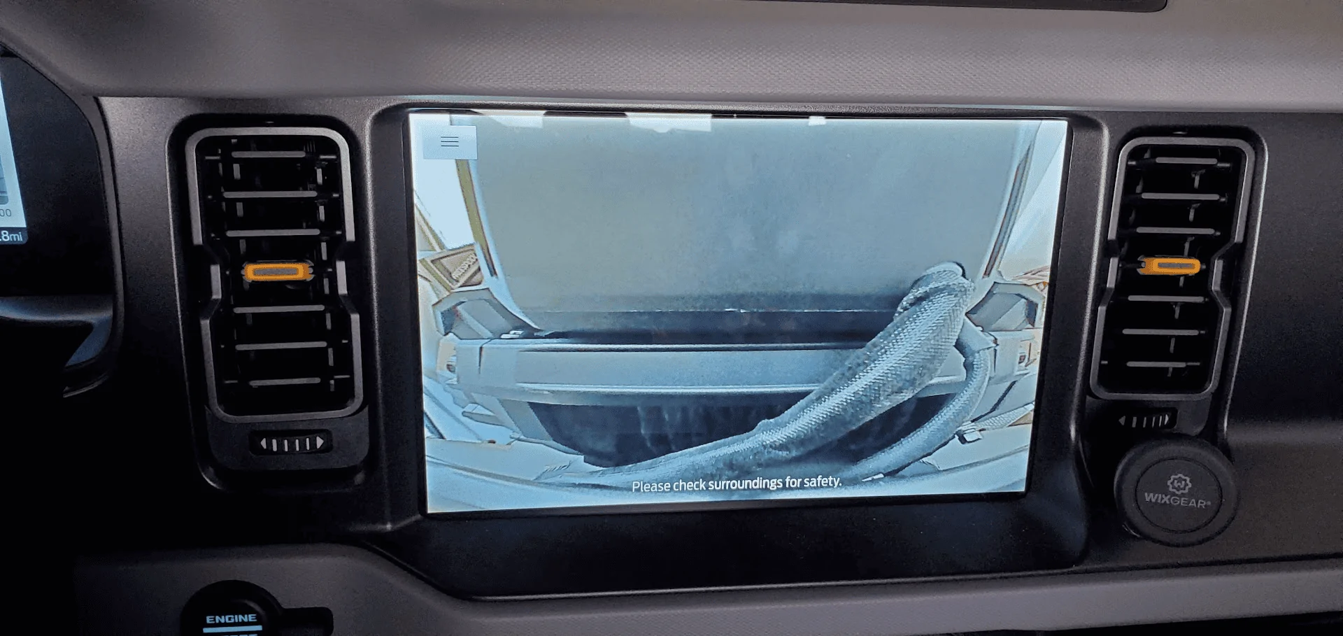

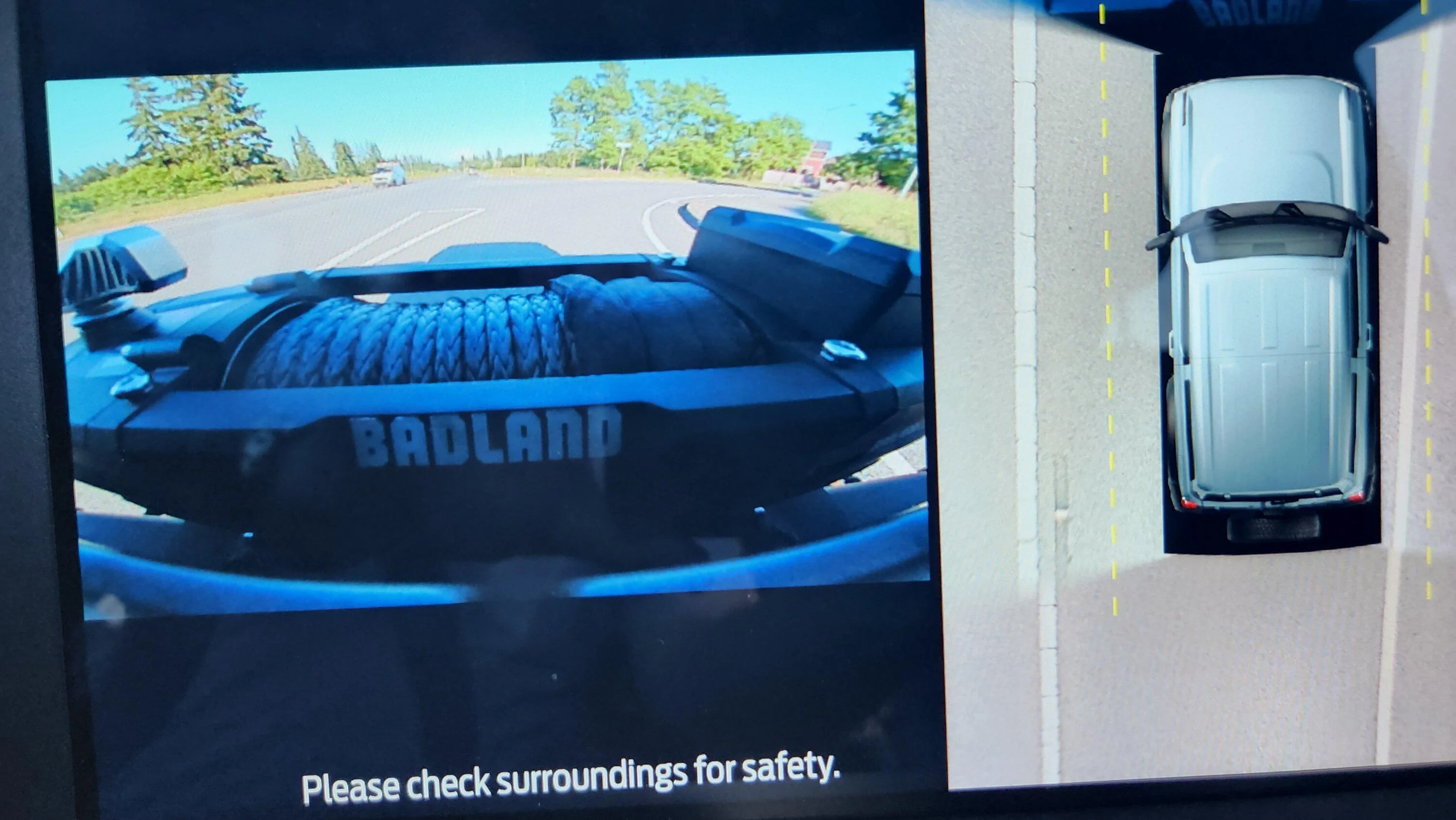

can someone with camera post pic of the view?

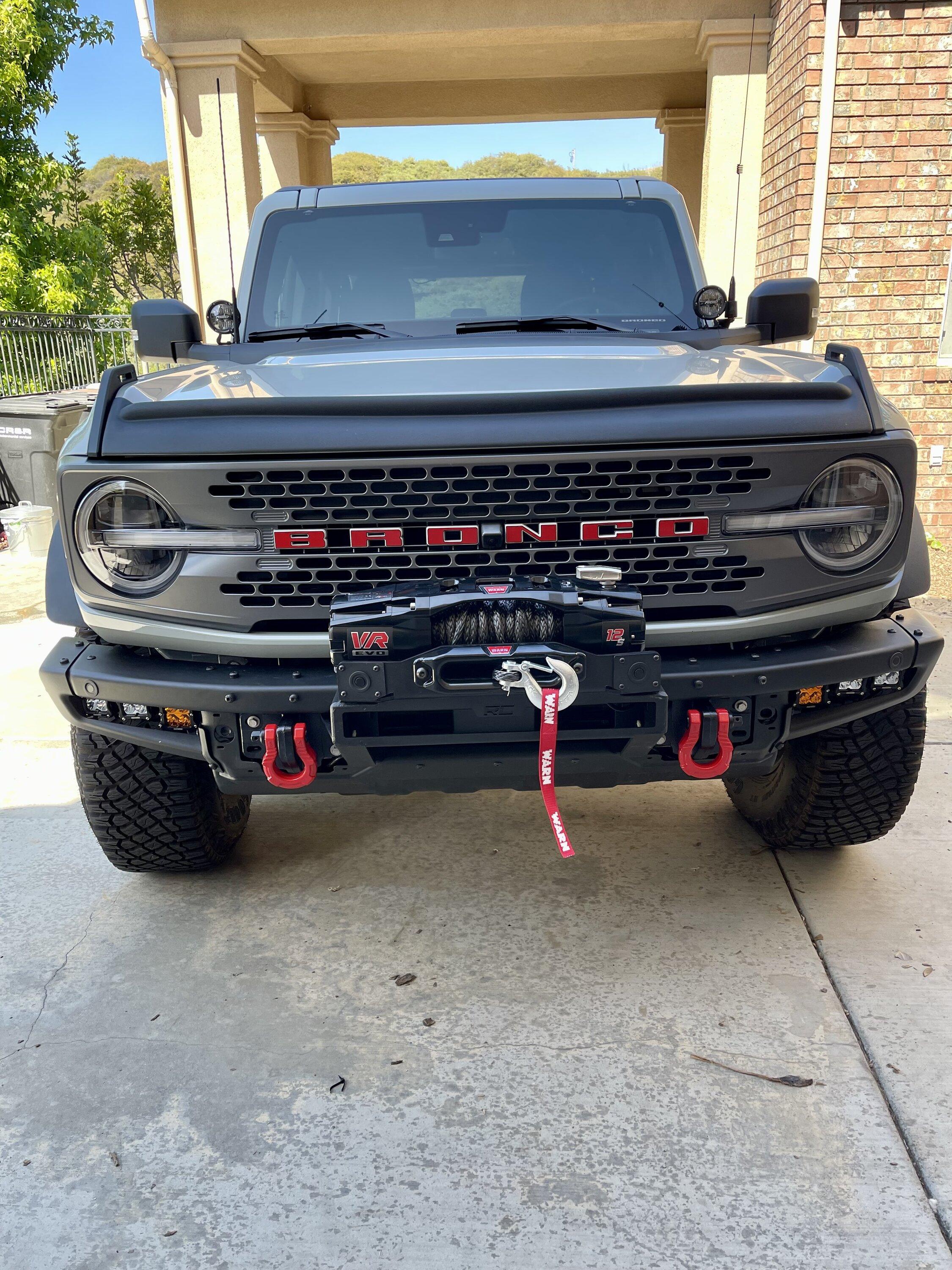

I got my LOD reinforcements in too, although I already installed my winch. It's not directly stated but I think you need to remove the entire bumper to add the reinforcements. I may wait until the next long weekend to take my winch and bumper off to install these.
https://lodoffroad.com/assets/pdfs/BFT2100 Bronco 2021 Front Bumper Frame Tie Brackets.pdf

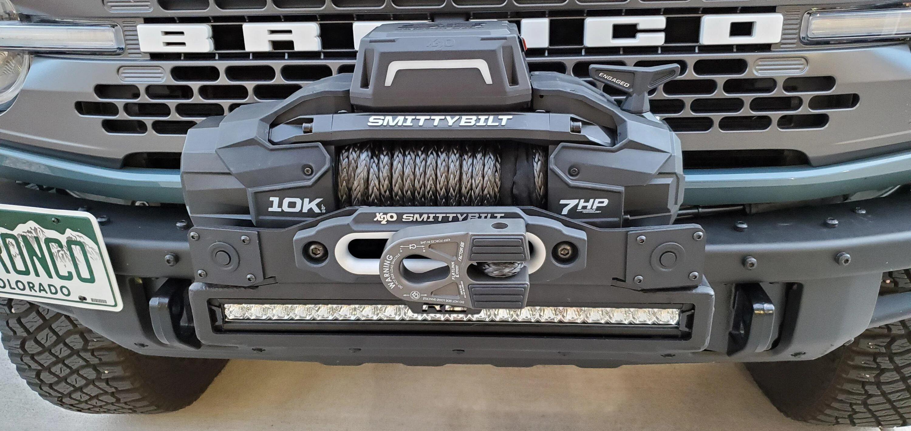

In the meantime, here's my finished winch (still waiting on camera relocation kit).
I was disappointed to see standard hardware with the LOD kit. I’ll have to source zinc plated or stainless. Or just undercoat the heck out of it after install. I also think I’m going to retain then original nuts and bolts if possible as I think we need the longer factory bolts to mount the winch plate and not have to try to reach around the bumper to hold a wrench on the back side. I’d like to source some of fords bolts that they use with the factory winch setup. They are shouldered and go thru the frame but don’t crush it. But 🤷‍♂️ At this point my bronco is still at the dealer trying to get the front end clocking diagnosed.

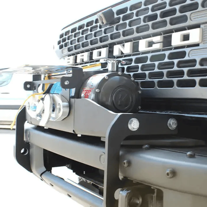

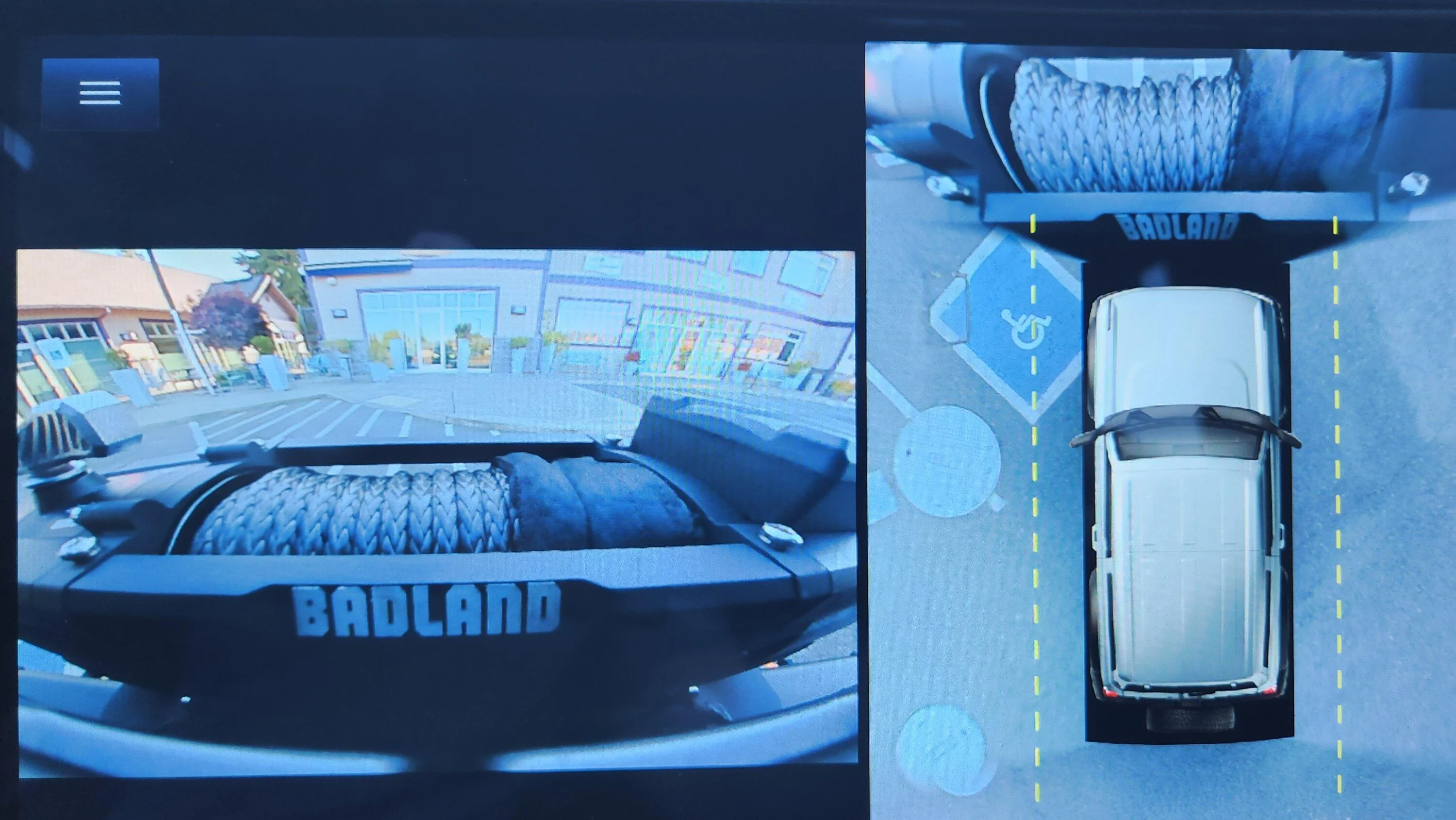

There's (literally) nothing to see.
Same as the ford winch setup until you relocate the cam. For you with the badlands grill look up asfir 4x4 for how they did the camera relocate. Nothing against JCR’s setup but the way I did it and Asfir does it costs substantially less money but you do have to cut/drill your grill.

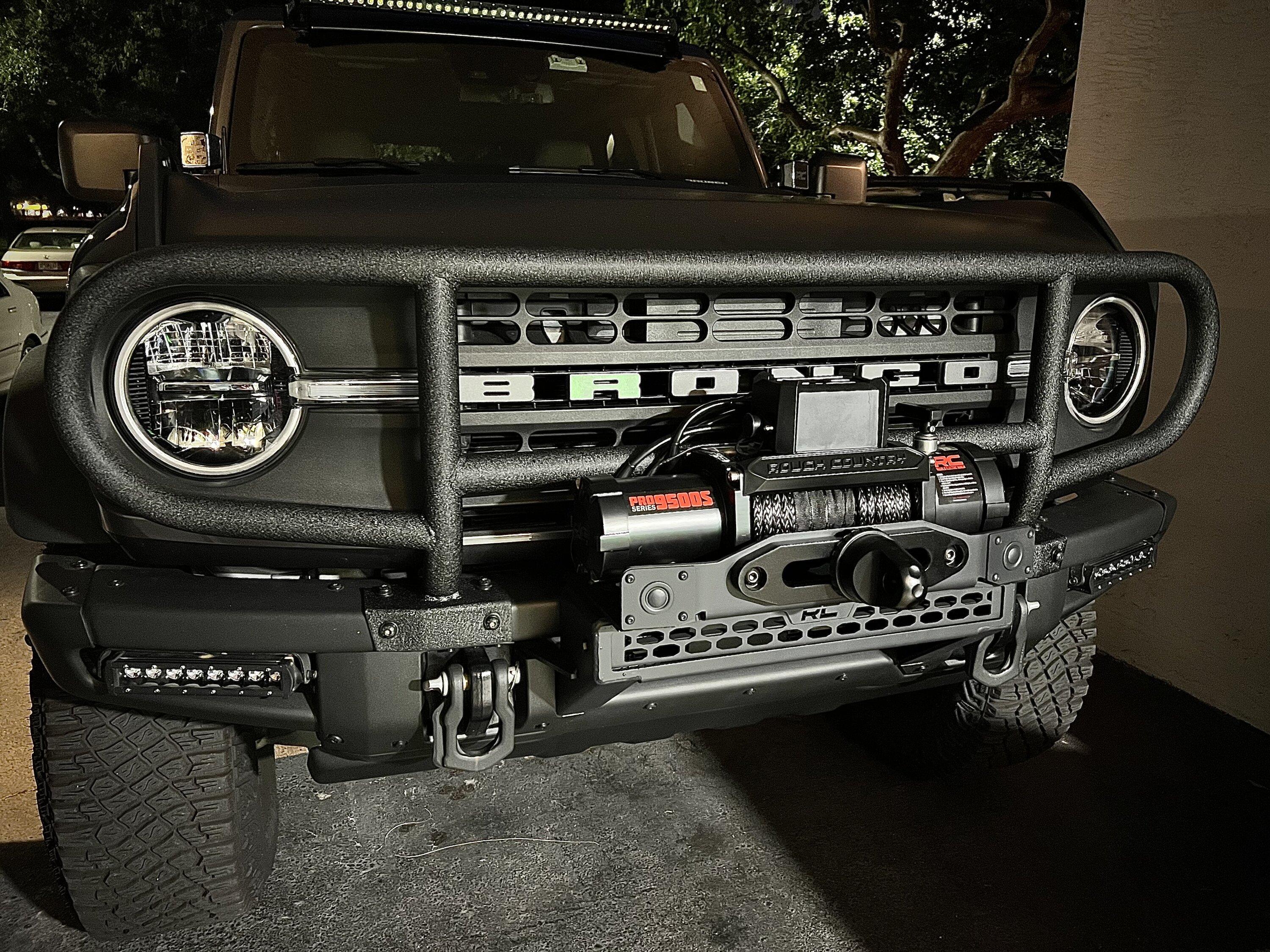

Finally got my trim pieces trimmed and installed this evening. Worst part of the install IMO.

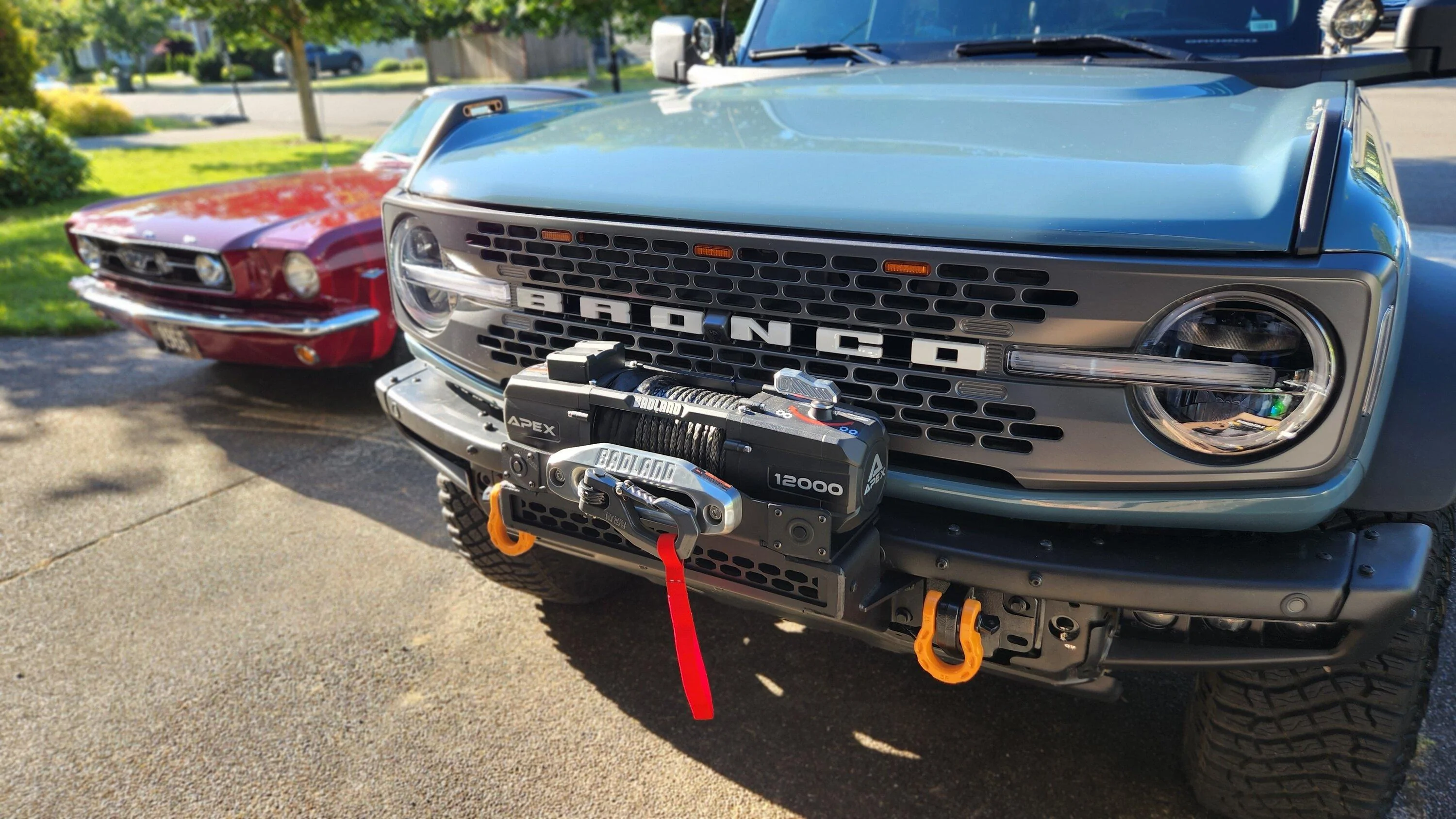

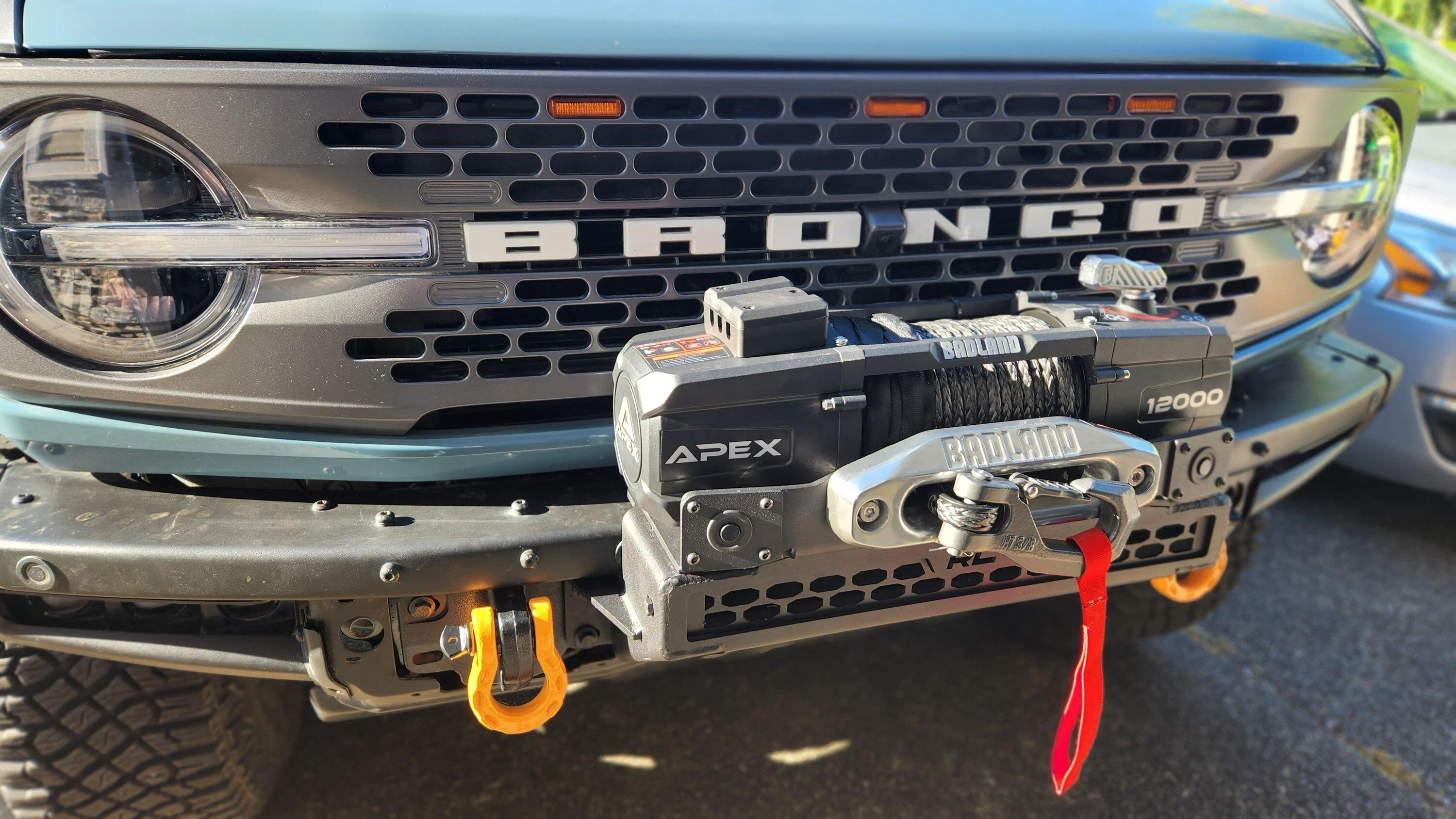

Installed the RC winch plate with a Badland Apex 12k synthetic. Big fan of the clean angular look of the winch and mount with the control box relocated (which I still have to mount and wire in). Fits the front of the Bronco in proportion and styling. Preserves almost all of the approach angle.
Ford Bronco Rough country winch mount unbox/ INSTALL tips. 20220621_182915
Ford Bronco Rough country winch mount unbox/ INSTALL tips. 20220621_182926

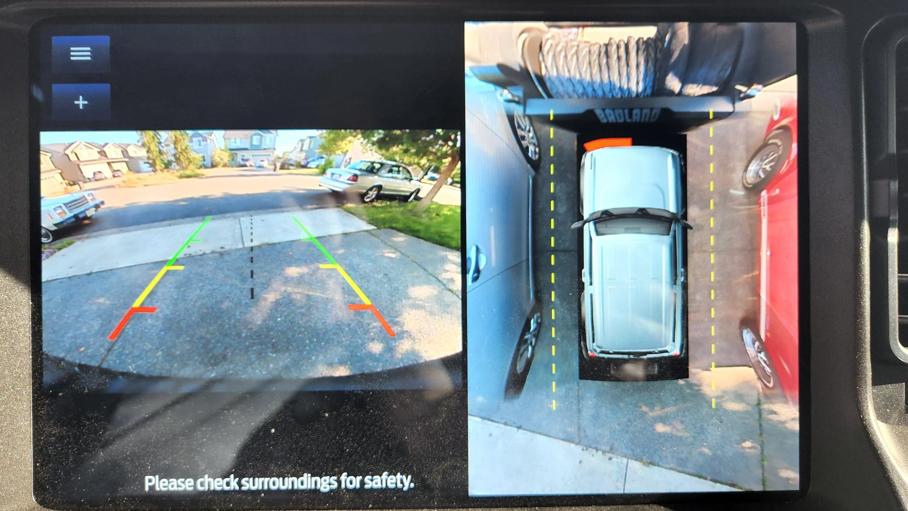

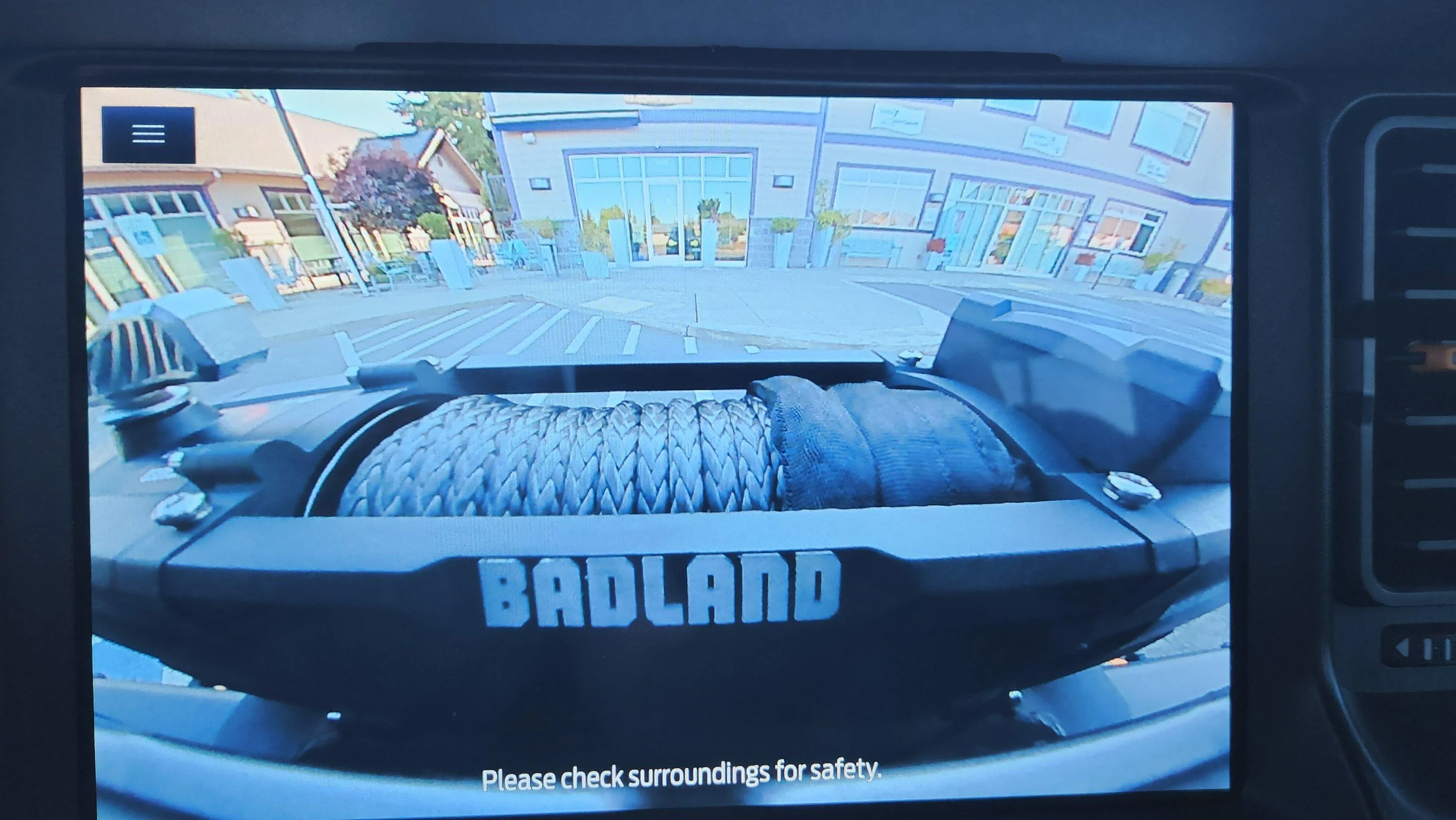

Visibility is not terrible with the control box relocated... but not sure it will still be useful cresting a ridgeline while staring at my hood. It sure screws with 360° view, though... showing absolutely nothing to the front. (... and if you've got to stare at the back of a winch... not the worst thing in the world staring at a "Badland" logo while you're sitting in a Badlands.)

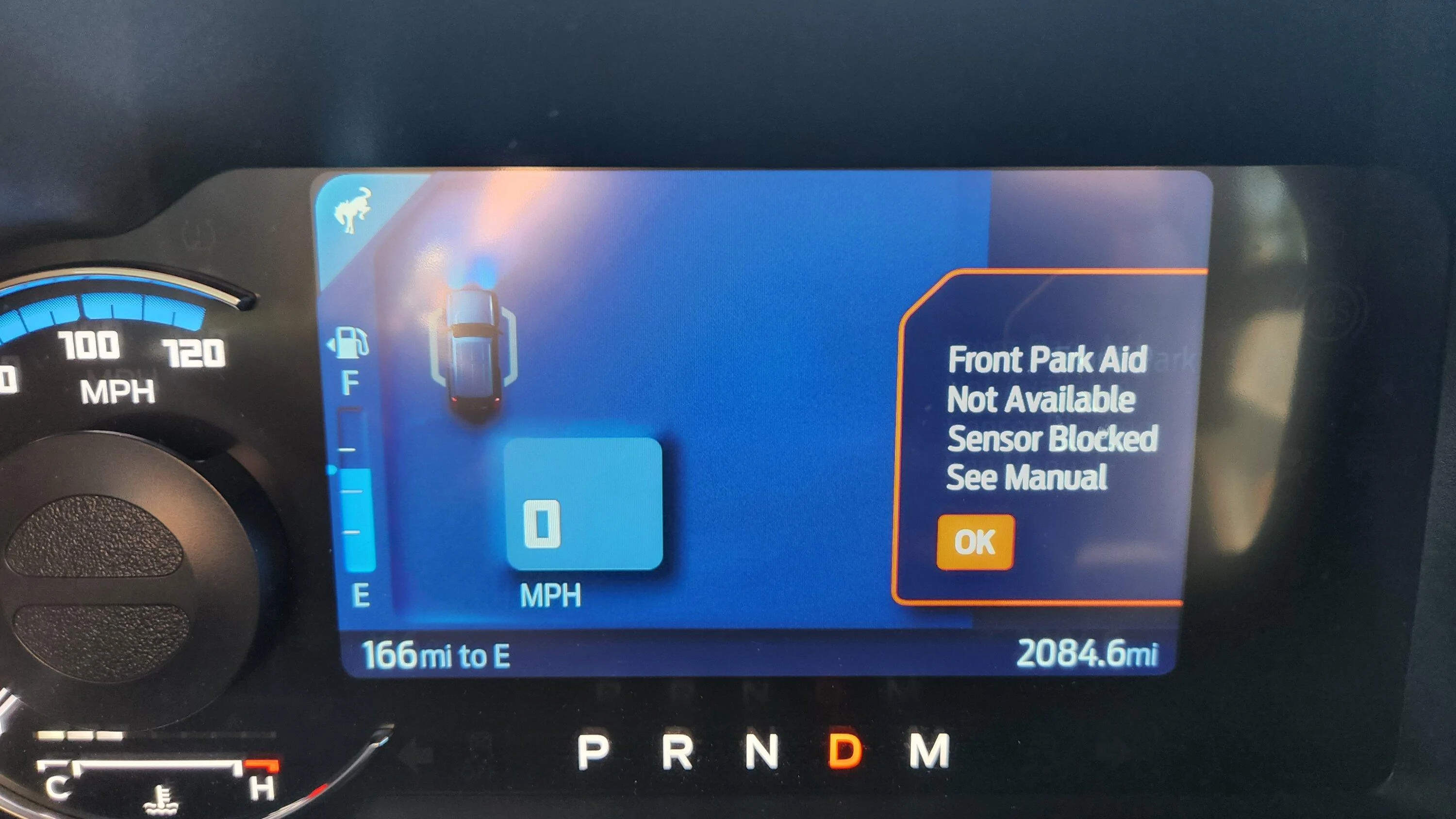

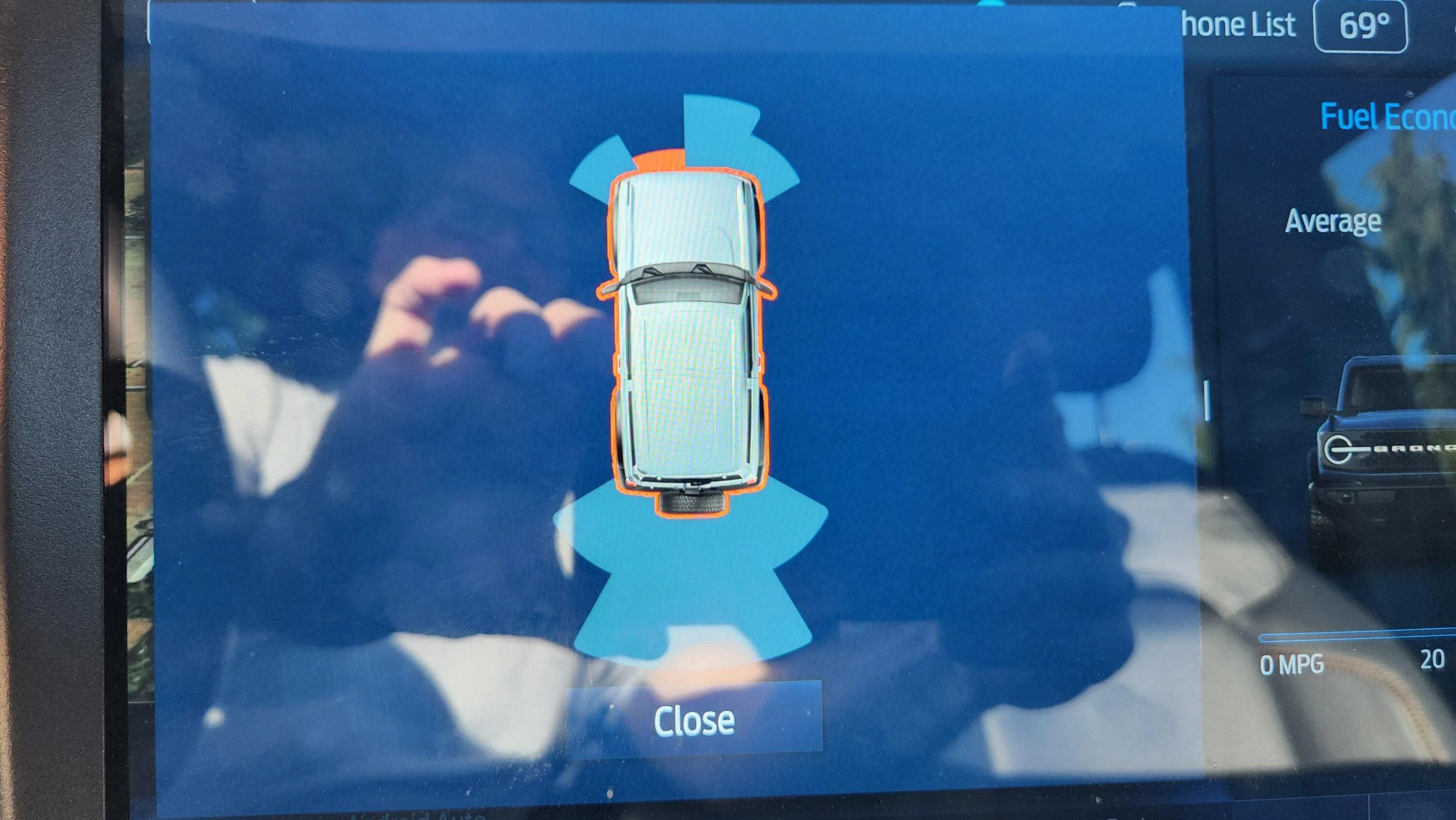

My biggest issue is with the left parking sensor relocation. Keep getting error messages. I'll switch the sensors and the wire extenders and see if the problem follows the parts.

Was not expecting to have to pull the bumper to move the sensors. There's 90 min I didn't budget for.
Overall pretty happy except for the sensor error.
Edit: The rectangular shape of the winch ends minimizes the room allocated for the sensor relative to round ones.
Removed both sensors. Switched sides. Added one of the RC stick-on rubber pads directly to the back of the sensor and used the bolting on of the sensor plates to firmly seat the sensor against the winch housing. Worked great.
No issues with parking sensors or ACC. Needs a camera relocation solution.
Thanks for posting a pic of it with the Rough Country winch. Do you know if the control pack can be relocated on that one?

There is no kit that I know of, but it definitely can. I’m actually thinking of relocating mine to under the hood and making a flat plate to mount on top of the winch. I will let you know how it works out.

damn...camera relocation is something I wanted to avoid.
