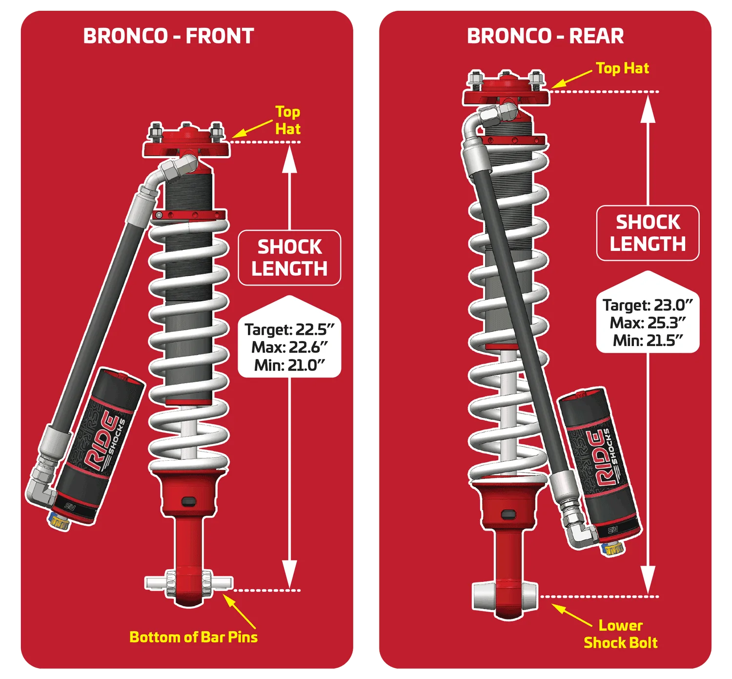

The shocks are WAY, like holy shit that's tall, taller than the eibachs I had on.
I'd like to lower it 3-4 inches. How much adjustability is there?
Do you have the Bronco back, driven on it around to settle everything? Portals are going to gain you the most height, did you have the Eibachs on before the portals?
Our shock setup guide should help with this and the installer to get it within our recommended range. Details can be [found here] Basically we have our target shock lengths at ride height and min min max lengths for the front and rear. Vehicle needs to be on level ground and suspension settled. We also have min max thread showing for all springs.
Ford Bronco Ride Shocks bronco-front-rear-shock-length
Not trying to avoid your questions, but I'd like to keep you in contact with John so we don't have multiple people addressing this. He is much more knowledgeable on springs and has been in frequent contact with your installer.
