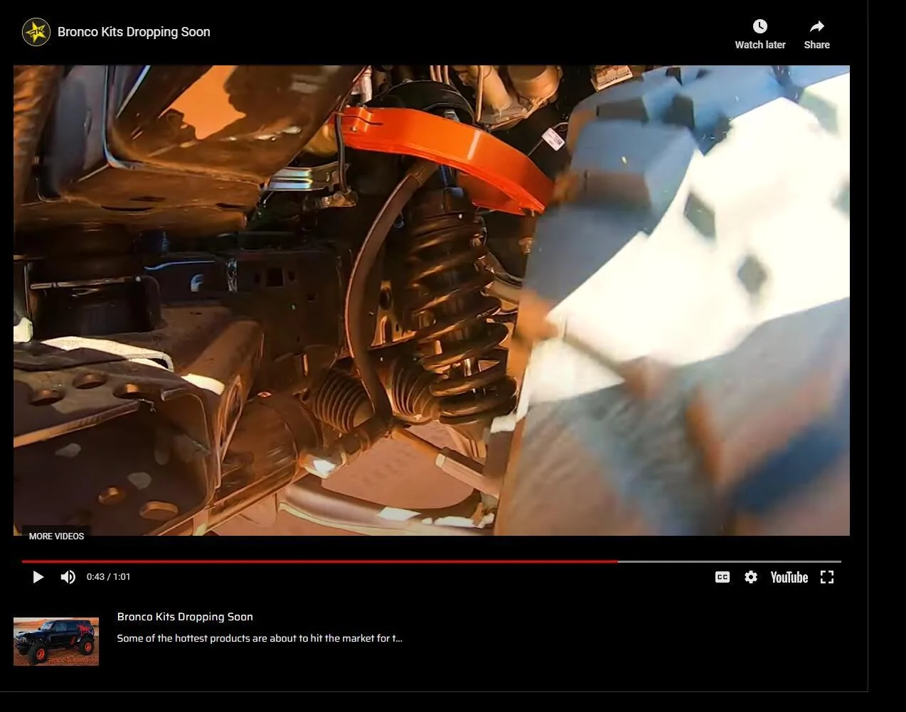

This is with the portals installed, right? If not, my 37” KO2s are gonna look like toys!
It will kind of look like this... LOL... This is with the stockers though...

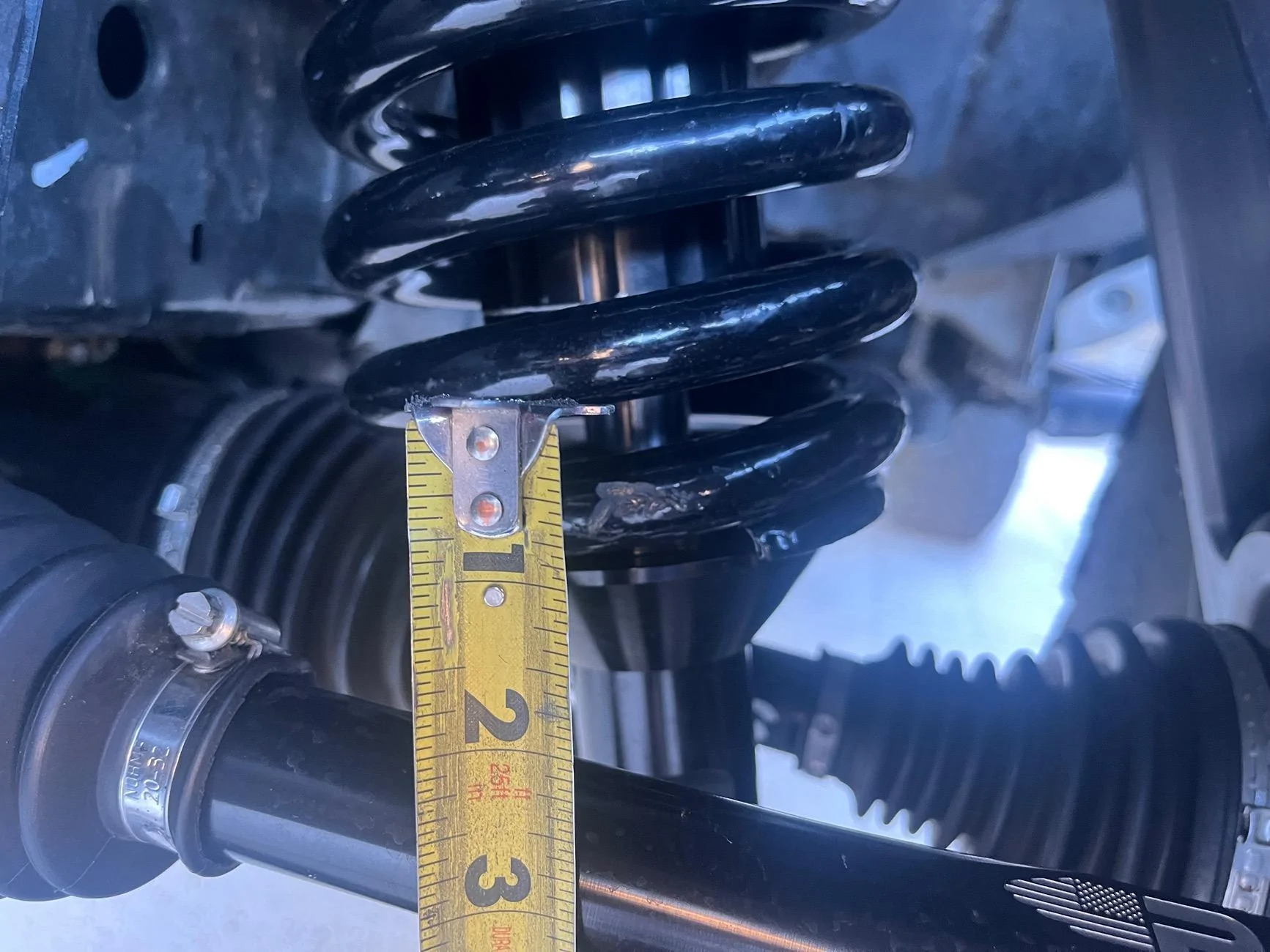

With our setup the issue was up front. Barely had an inch of shaft showing so very limited on uptravel. Was hoping to get away with it but no dice. (Don’t mind the cosmetic damage on the coil, that was my mistake during installation)
Do you have a picture at full droop? Your in uncharted waters with those Rock Krawler shocks. Something doesn't look right with level CVs you should still have 2-3" of wheel up travel.

Yeah. They recommended 1.5” of thread above the locking nut but we were trying to keep it as low as possible. Adjusted preload to see what it was like at almost the same height as factory (was still taller due to shock length and factory mounts, of course) and did .5” above the locking nut to start out.
Unfortunately didn’t get a good picture of the front at full droop on the shakedown run. RK has been talking with Quinn about additional changes that can be done for those running portals.
