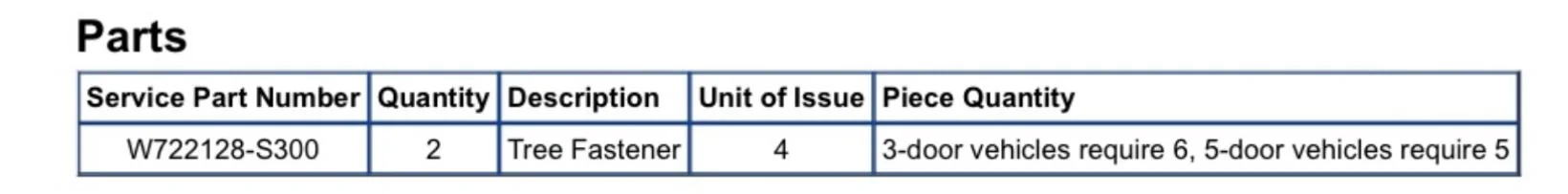

Does anyone know where to purchase these clips? This is a picture of the rear panel.
Not sure you need to buy these?
When I removed the rear Inner Plastic Panels for a Subwoofer install these White Clips/Tabs separated but did not break. The outer piece which stayed with the Panel when removed was taken off and snapped back into the other half.
When I put the panels back in the white tabs lined up and held as before.
Dads_bronze_bronco
Feb 18, 2020
4,299
7,581
08 JKUR / x_x 00 TJ x_x
Autozone has them - at least ones that look pretty similar and work.
